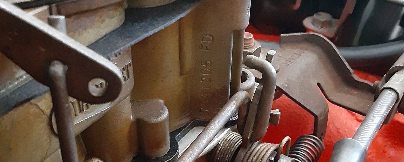

Is it possible that GM put Buick Quadrajets on a 1971 big block car?
I have a 1971, 454 with what appears to be a factory installation. The fuel filter fitting comes straight forward from the carb as opposed to pointing to the right side. The rigid fuel line looks correct and is one piece from the carb to fuel pump. The carb ID is 7042251 which would be right for a 1971 installation.
Possible?

Nope. That was by someone else. The factory Chevy carb will fit the factory Chevy fuel line for example. Several other potential issues that escape me at the moment. The Buick carb will not just drop in there.

since the carb was installed at St Louis and only the Corvette was built at that building (other Chevy cars and trucks were built at another building) there is no way it was put on at the factory

I would think a good picture of the fuel line would help with the mystery, which may not be a mystery at all. The carb # given appears to be a 1972 number. 1971 should start out 7041XXX. Big block should be 7041204 for THM or 7041205 for 4spd according to NCRS spec guide.

Your '71 LS5 would have come with a CEC Solenoid attached to the front of the Carburetor. Does yours still have it?
My Quadrajet 7041205 is the original on my '71 with the CEC Solenoid still operational, but I don't use the vacuum connections on the CEC Solenoid due to it only allows vacuum advance when the solenoid is energized.
