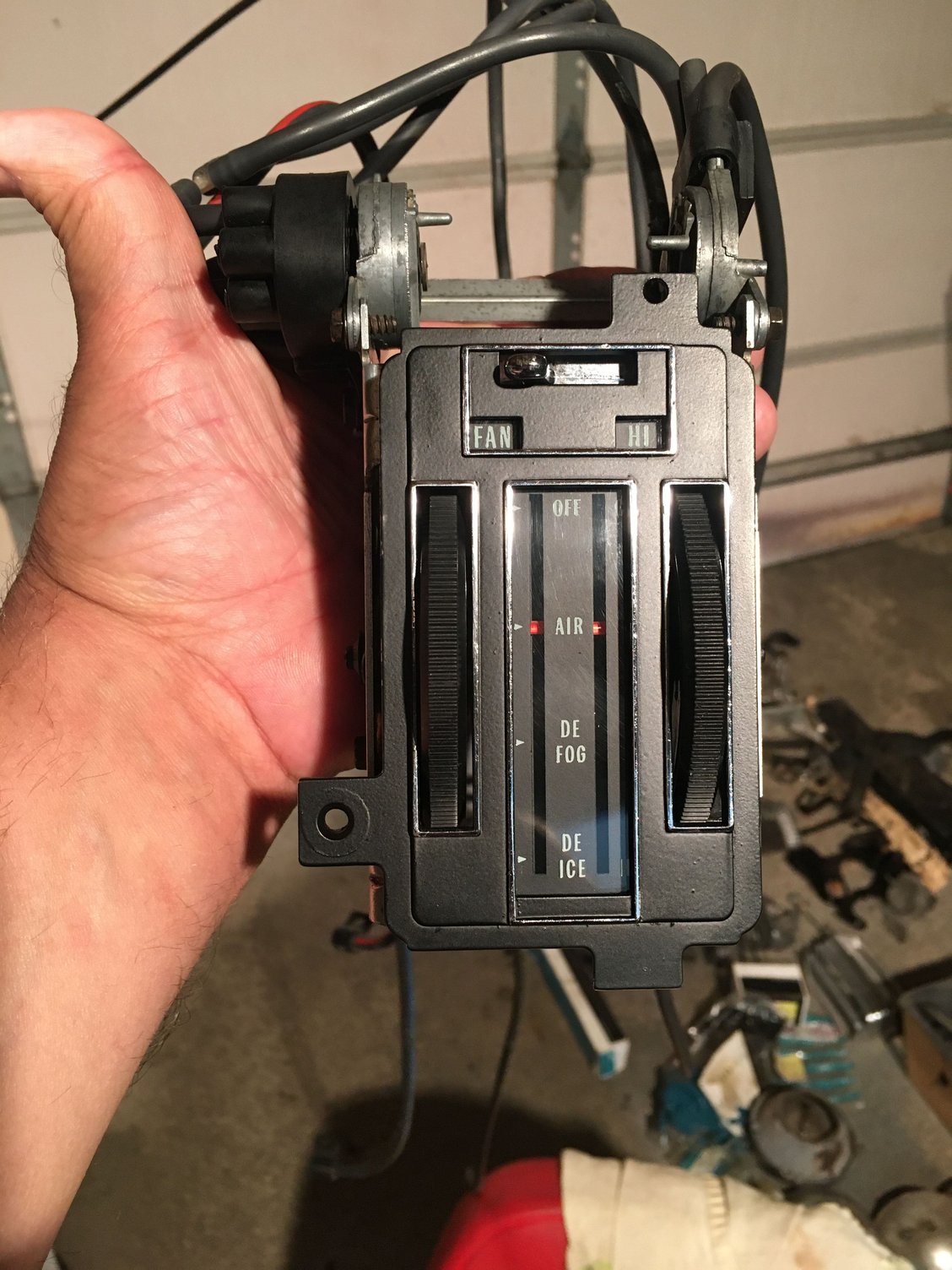

I’ve used this with excellent results on the console plates.
Thoroughly cleaned with acetone. Scuffed with 2000. Sprayed two medium coats
50 years of use
Cleaned, scuffed with 2000 grit
Ready for another 50 years
