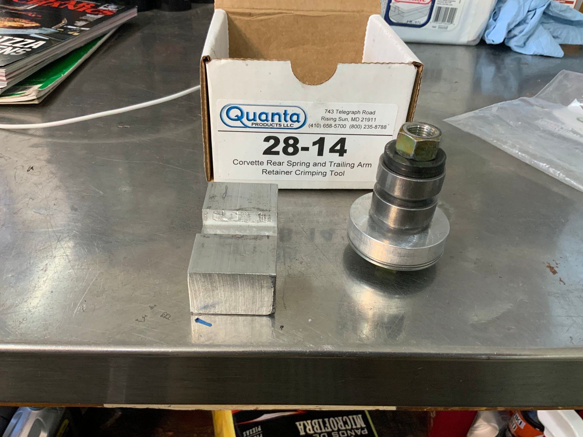

I use this tool from Quanta, it works well.

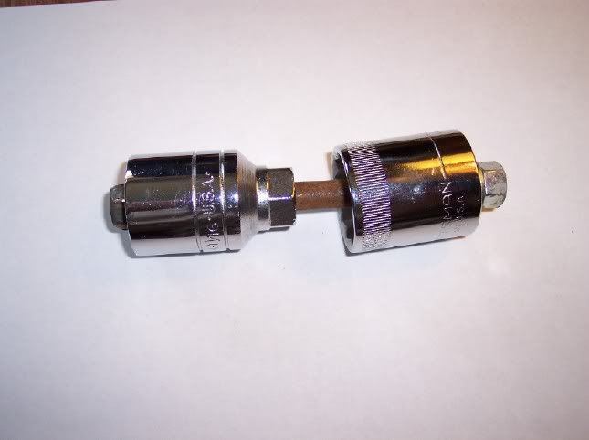

My setup for crimping spring retainers on the car.
The socket with the bevel is an old oil pressure sensor socket, probably obsolete now.
