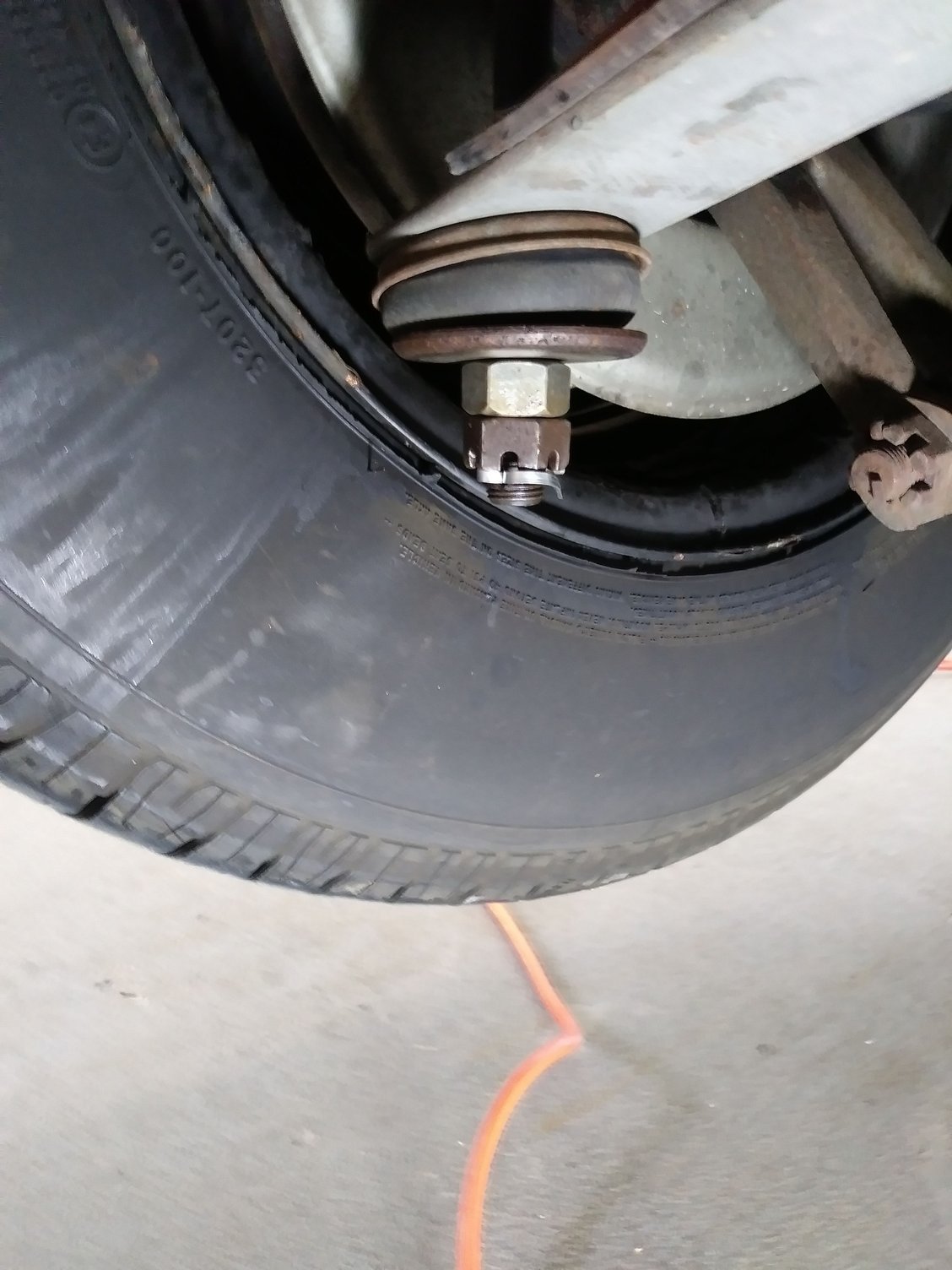

In the rear you can adjust by moving the nut at the bottom up on the low side and down on the high side. Might need to get a set of bolts with more threads or length. There is also a play available moving the rear spring side-to-side by loosening the mounting bolts and moving it toward the high side.

I've checked everything up and down, sideways, and back, everything is where it’s supposed to be, So I've decided to do the 180 on the rear spring, well, wouldn't you know it, now it is slightly lower on the passenger side. So, I got myself the right size nut drilled the threads out and now it is perfect same height on both sides.
