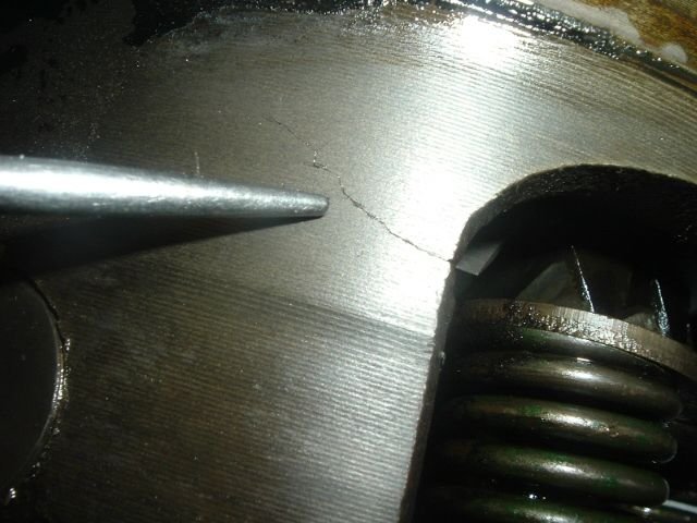

OH- 78-79 355 is what was in the housing when new, pull the cover for a look. Also check that lower left hole to see if that is a crack in the base of the hole from a long bolt.

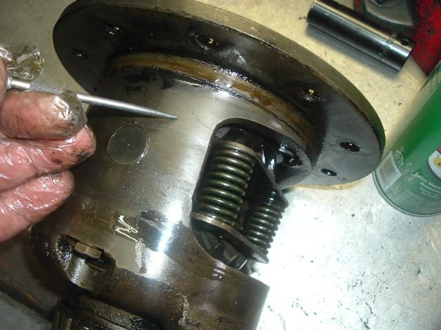

Typically, they crack at the large window radius and the crack will work its way down to the cross shaft, split the case in halt and implode.
Do you have the caps for the diff housing? You should check the fit and set them for 001" rock.
Cases from 63-68 aren't too good. 69- 71 better but 72-79 or new Eaton are what I would use. I don't care for the yukon cases or Auburn cone posi's.

Thank you for the pic. When I first read, "Also check that lower left hole to see if that is a crack in the base of the hole from a long bolt", I thought you were talking about the housing.

Yes I was referring to you picture of the strut rod holes in the housing. It might just be dirt in the hole but check it. I have see those broken inside.
