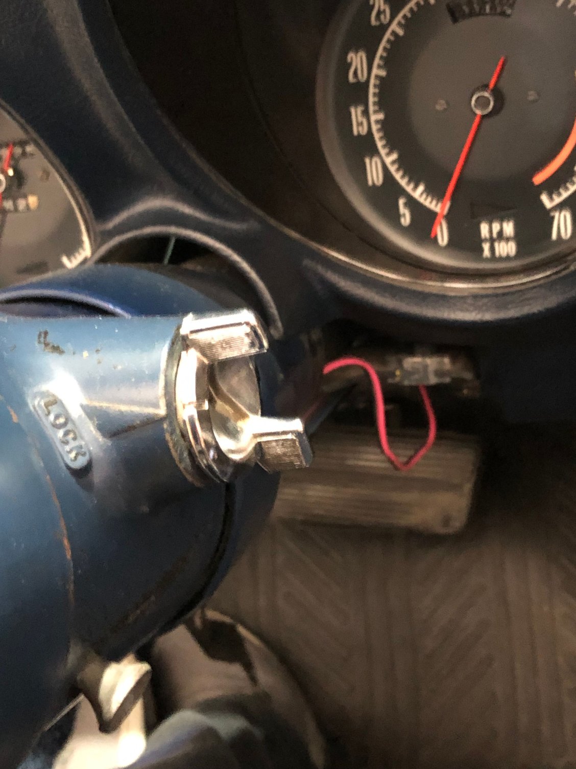

Thank you for the quick reply. Where would the ground strap be located on a 73? The shock is definitely coming from the steering because it only happens when I’m touching the key guard area

If I had to guess, the shock has something to do with the buzzer in the horn relay/key in warning circuit.

plus. check the 2 ground wires are attached to the exhaust pipe just under the tranney and the body grounds

Having just gotten a jolt when replacing broken plastic parts in my '72's upper column, I can unequivocally say that the horn button contact could be a culprit if it's somehow making contact with the housing.
