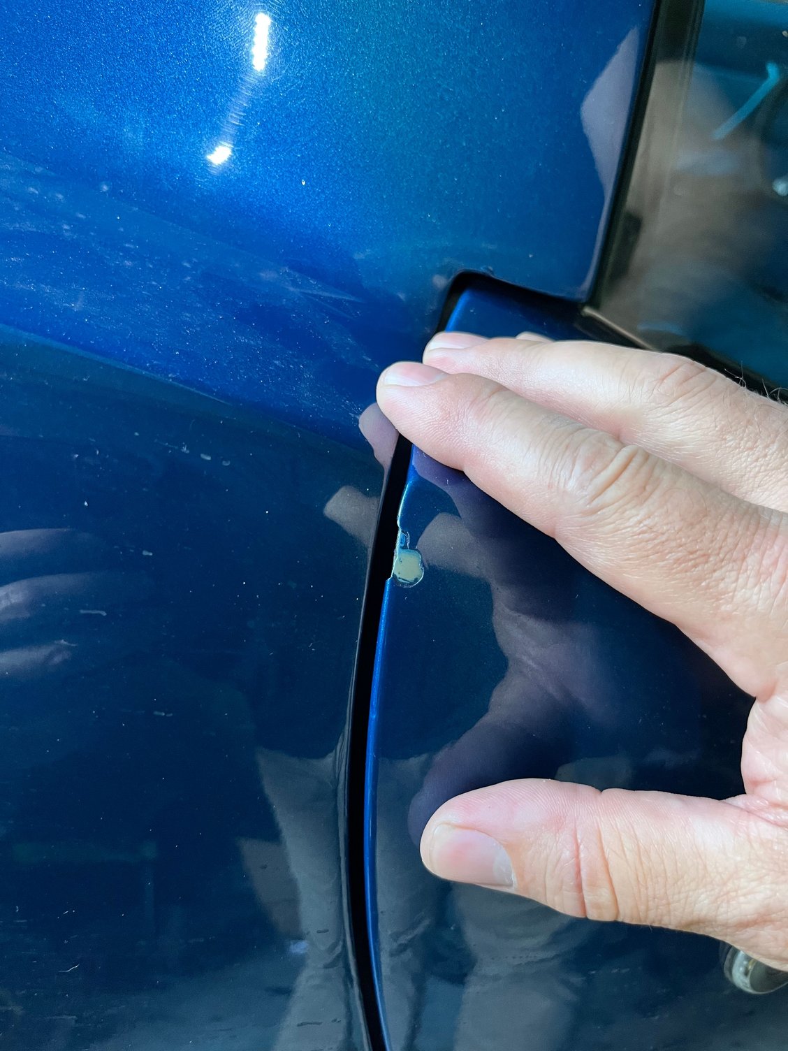

I’m happy to have this professionally handled…. I just don’t quite see this calling for a complete respray.
The paint is dirty but it mostly looks like this.

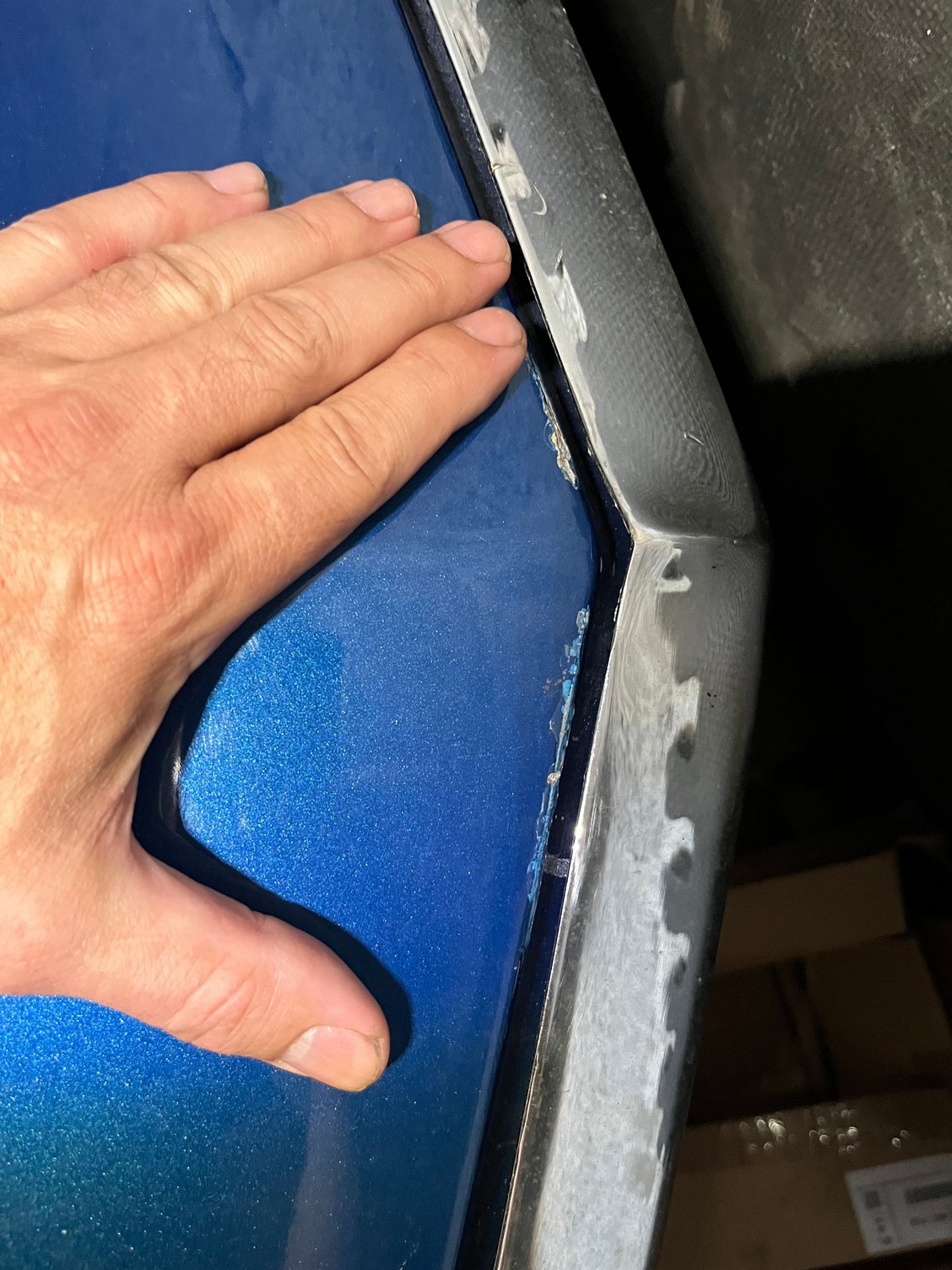

Ok. This is by far the worst bit, but I can see the front end being redone. Yes, I underestimated how long the nose is.
Hand to give an idea of scale. That was a 9/16 socket.

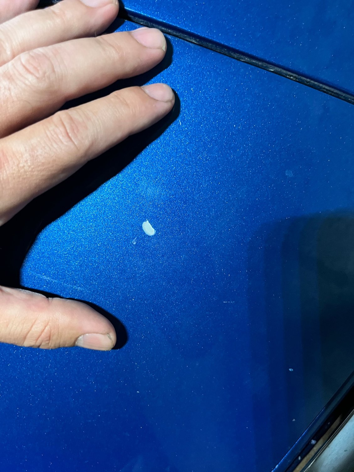

This is the deepest chip.

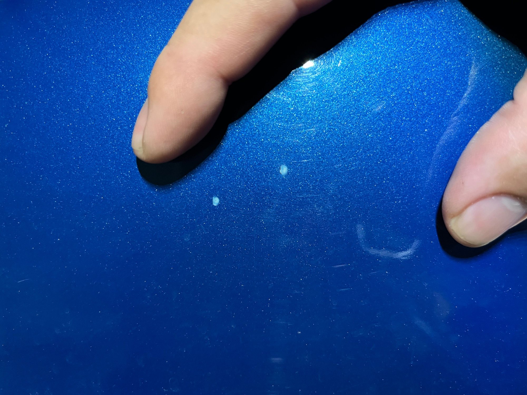

Smaller ones are like this

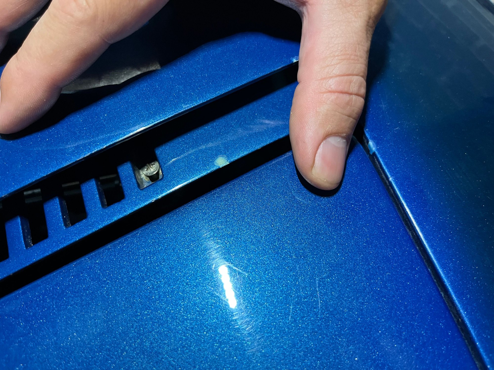

And this. Quite frankly the smaller ones don’t really bother me.

yeah you should be able to get those fixed.

From what I see it looks like there's at least a couple layers of paint on your car already. If so, your next repaint should be one where the car's stripped to bare fiberglass, and not a simple scuff and shoot repaint.
The size and depth of those chips don't look like "normal" paint chips, and might be the result of paint that's too thick (too many coats of paint), poor surface prep, or both. The chip on the door edge looks like the fiberglass itself may have been chipped/damaged?

I think you should be able to get a very respectable result with touching up those chips.
Build up the chip area with base colour then a few coats of clear so it is higher than the original paint.
Then sand it flat and buff it to a shine (giving time to set etc)
Will always be visible under inspection but will be way better.
