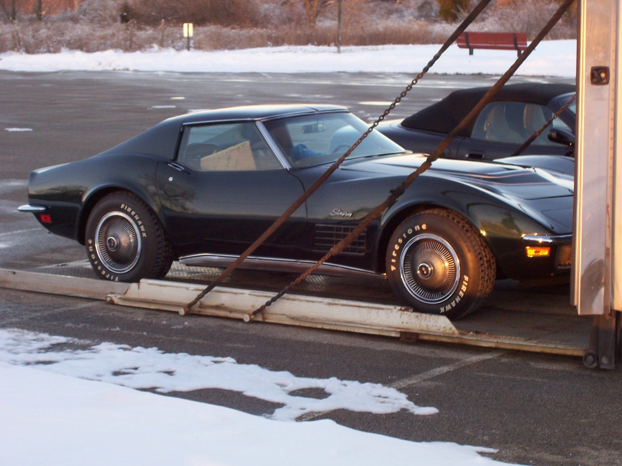

I bought a single leaf from Pull;=a=Part...driled holes for the spring bolts...removed the old flat main leaf from the original spring pack and installed the "new" modifiedmain leaf...the car rides a little softer because I didn
t like the extra-firm feel. Total invested $30 including hardened drill (bit) to drill thru both ends of the leaf.
Pics in my thread...see table of contents on page 1
PHOTOBUCKET SCRUBBED ALOT OF MY REBUILD PICS
