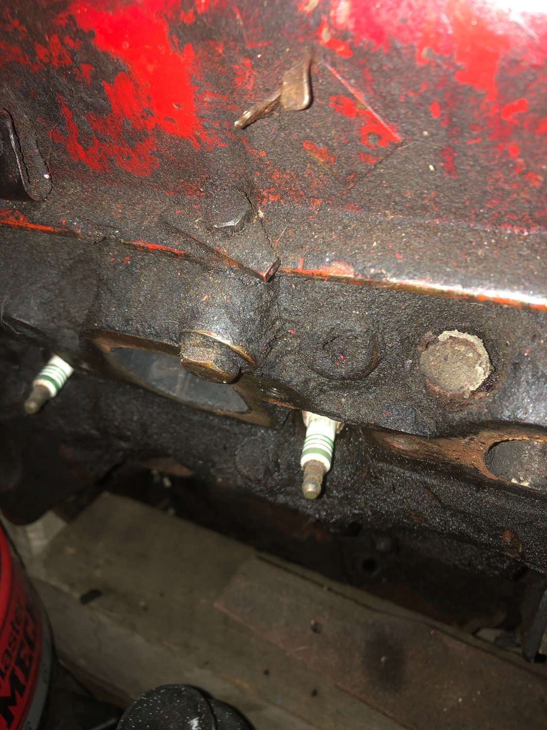

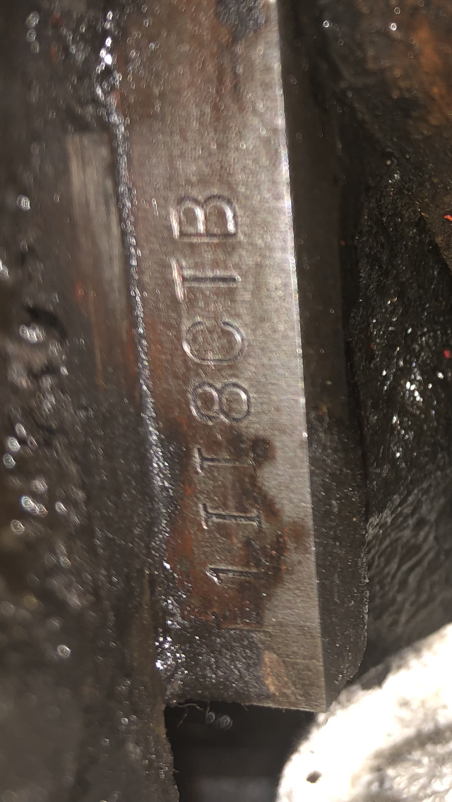

As per my last post I took some pics I am trying to identify this motor .. unfortunately the owner has passed away but his wife said the engine block was a corvette 427 I am not sure if the spark plugs would be that small on a supposedly big block.. Any help would be appreciated ..

70s small block. None of them are from a Corvette, though one use of the "CTB" code was for an LT-1.
5 options are listed here, and in the Lime Book
https://nastyz28.com/gm-chevy-codes/...s-suffix-3.php
Do you have any other photos? It's pretty easy to tell a small block from a big block. The exhaust ports, and valve covers, are immediately obvious. Don't judge by the spark plugs.
EDIT: The photo with the spark plugs didn't show up before. But clearly a big block. @67:72 has the proper link/information below, for a big block (sorry, not an LT-1)
Link to your other thread.
https://www.corvetteforum.com/forums...ck-engine.html

Likely a 72 Chevrolet BB 396/402
Big blocks also had the CTB (the engine code starts with a T). Also from the nasty Z/28 page:
Dang! Guess it's not an LT-2.
Good find! I clicked on the wrong link.

don't think you need to dig it out any further. it is a late, nothing special 402. mid america chevelles has it as camaro, chevelle or full size car. 210 or 240 hp. maybe interesting to see what head castings. but otherwise not a sought-after engine. last year for the 396 or 402. i think they were all 402 but some were marketed as 396.

I was only saying 72 b/c that’s the year of the motor in question according to the stamp
