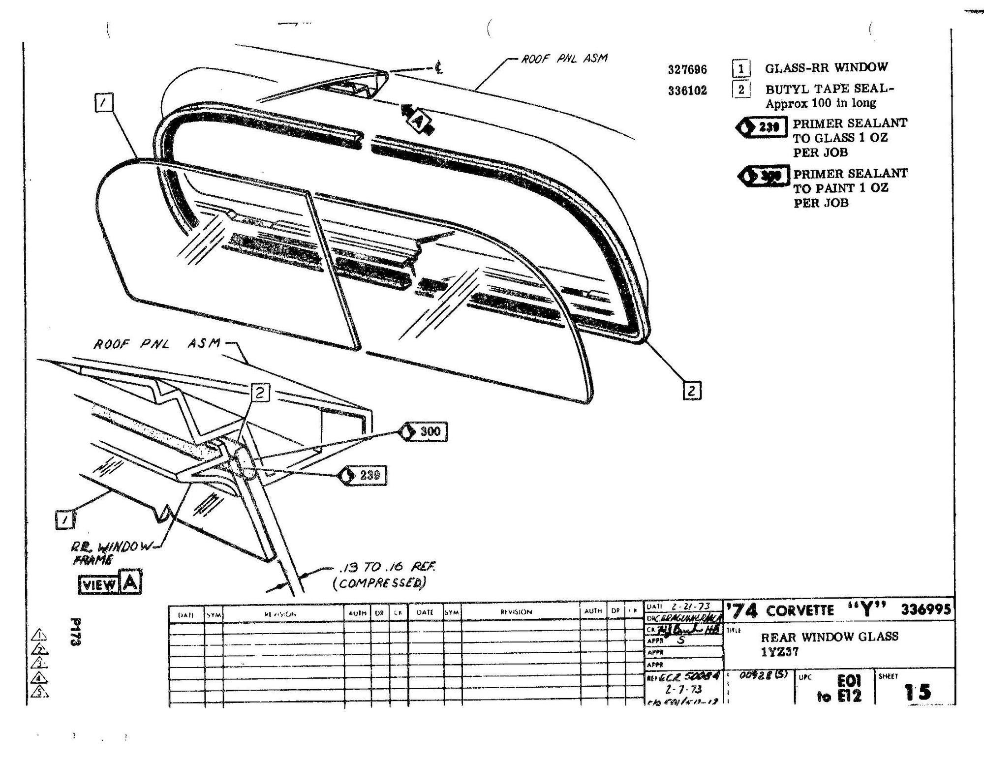

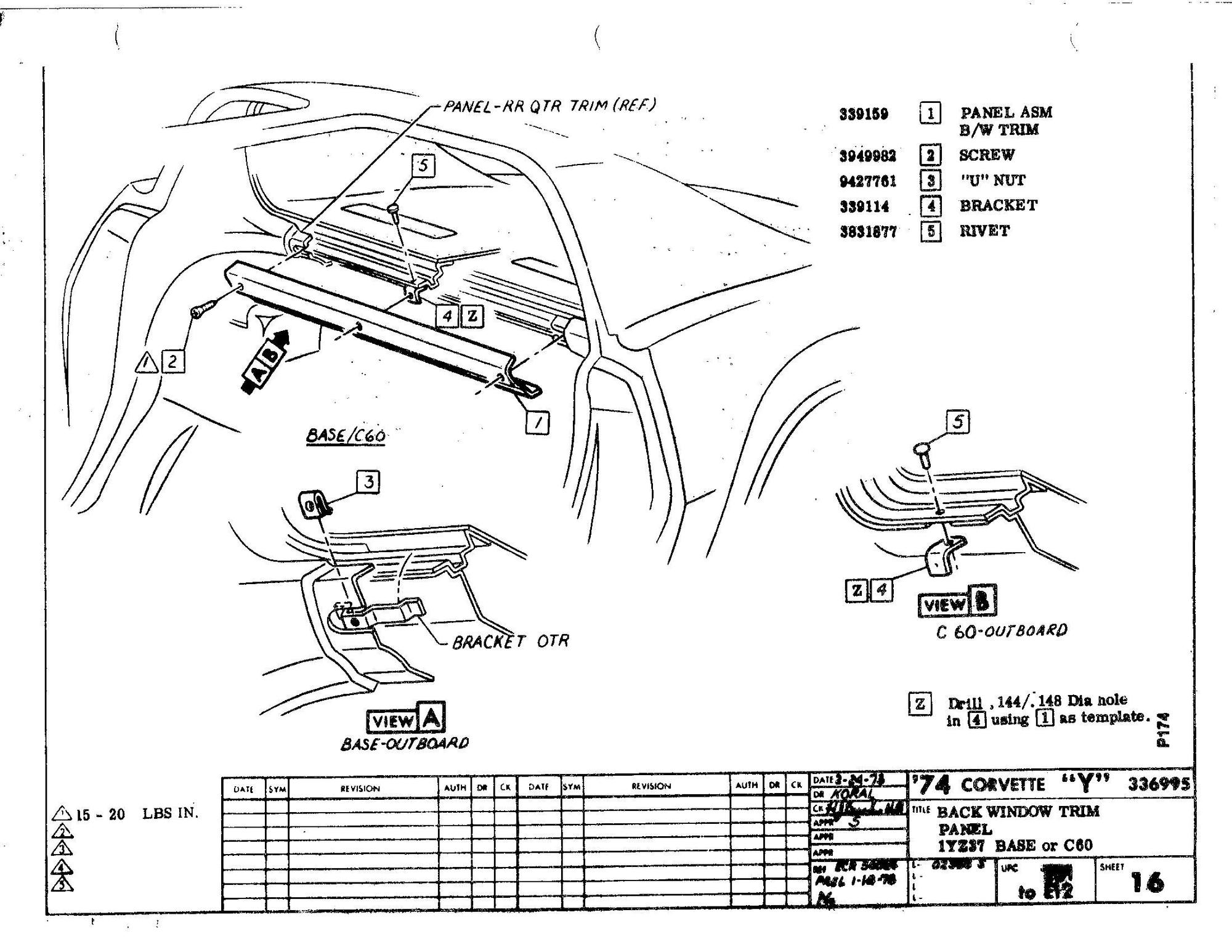

Replacing the rear window seal and trim is a good DIY project.
Remove the front trim:
Then remove the frame that holds the glass in place:
Then remove the glass and clean it and the car body.:
With both surfaces spotless apply the butyl tape to the body and install the glass.
The butyl tape will hold the glass in place as you reinstall the frame and trim.
Enjoy your now leak proof Corvette!
