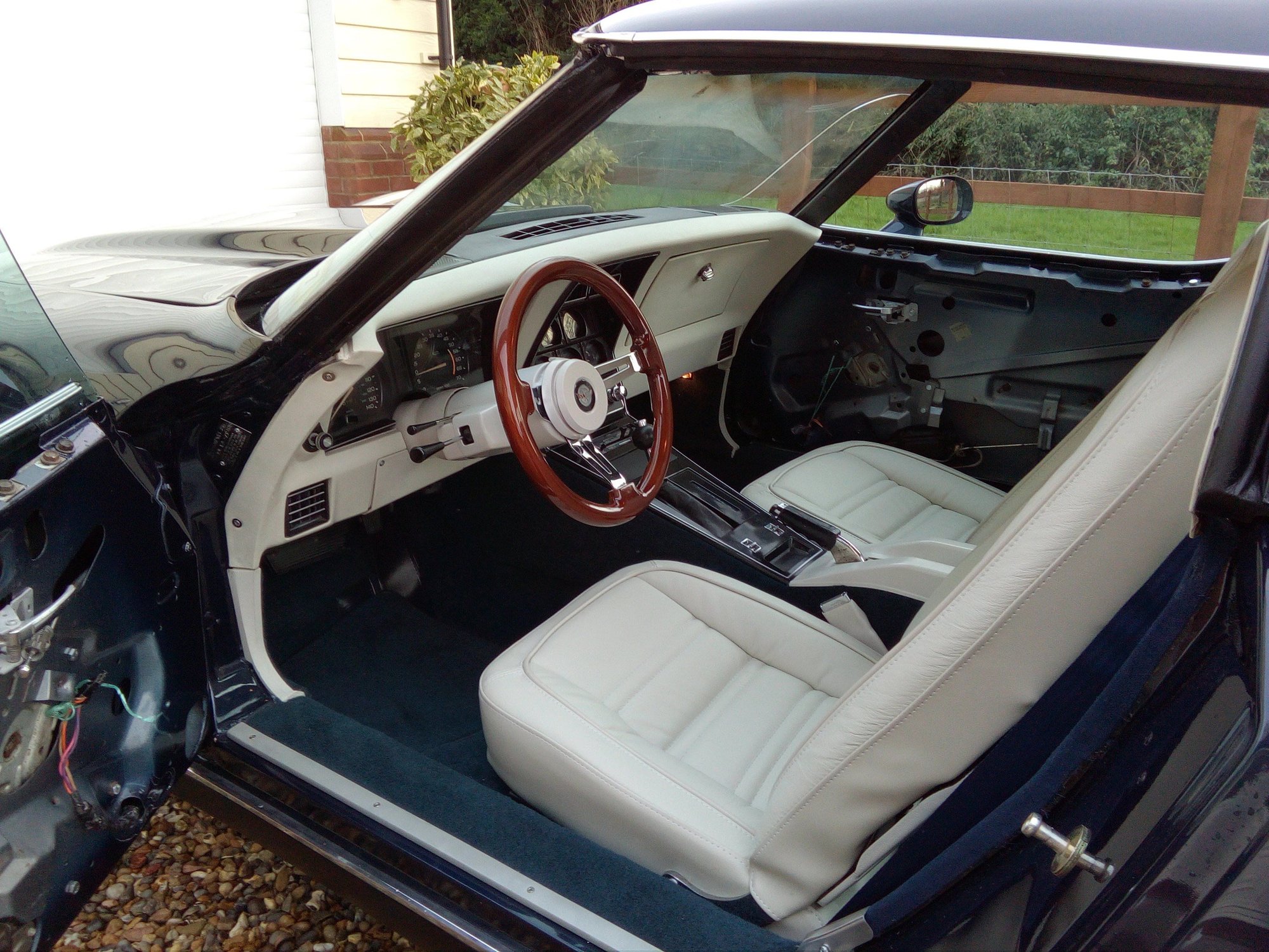

Not certain what bit of the carpet you mean, but the new carpet for my 78 has rubber/metal section covered in a sort of felt material attached to it which fixes it into the door opening, as shown.

Early 79s had the trim like the 78 in the above post. Late 79s did not have the channel that snapped over the jamb, carpet tucked behind the jamb.
I believe you need to reuse the trim piece, gluing your new carpet inside. Or maybe you could tape the carpet in place and slip the channel over it.
