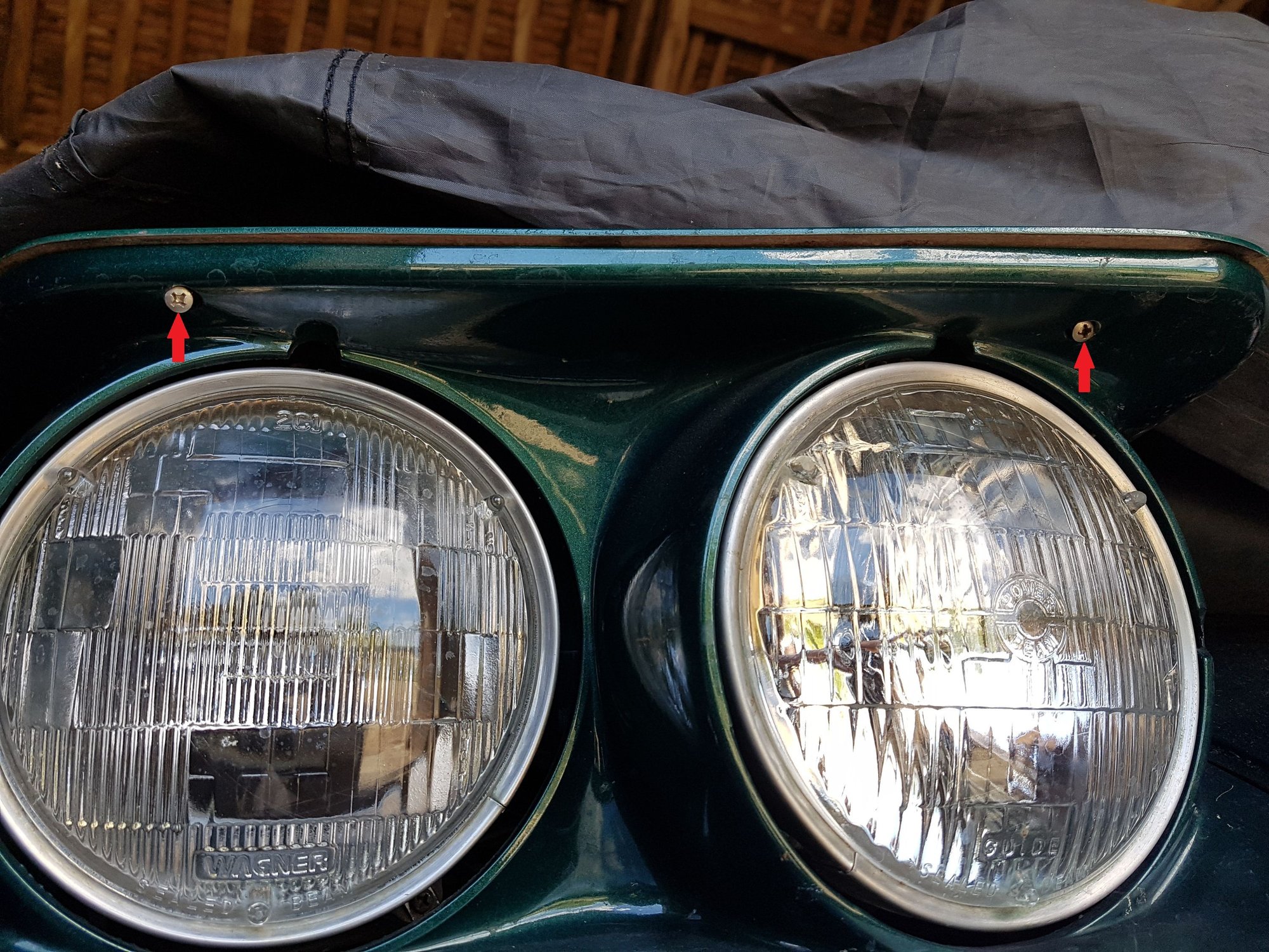

2) The 2 little front bolts of the passenger headlight bezel were replaced by 2 screws that damaged the original thread (see photo). I will restore the threads with helicoils. In this case, I don't know the correct size. Can you tell me please ?

The original screw thread size is 8-32.
