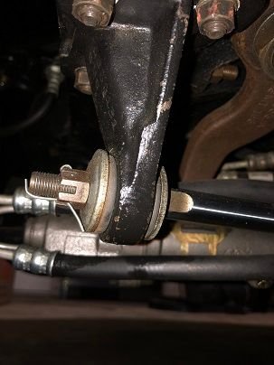

This is probably a really stupid question, but is the ram of the steering cylinder supposed to be secured within the bracket, or move freely like the pic below??

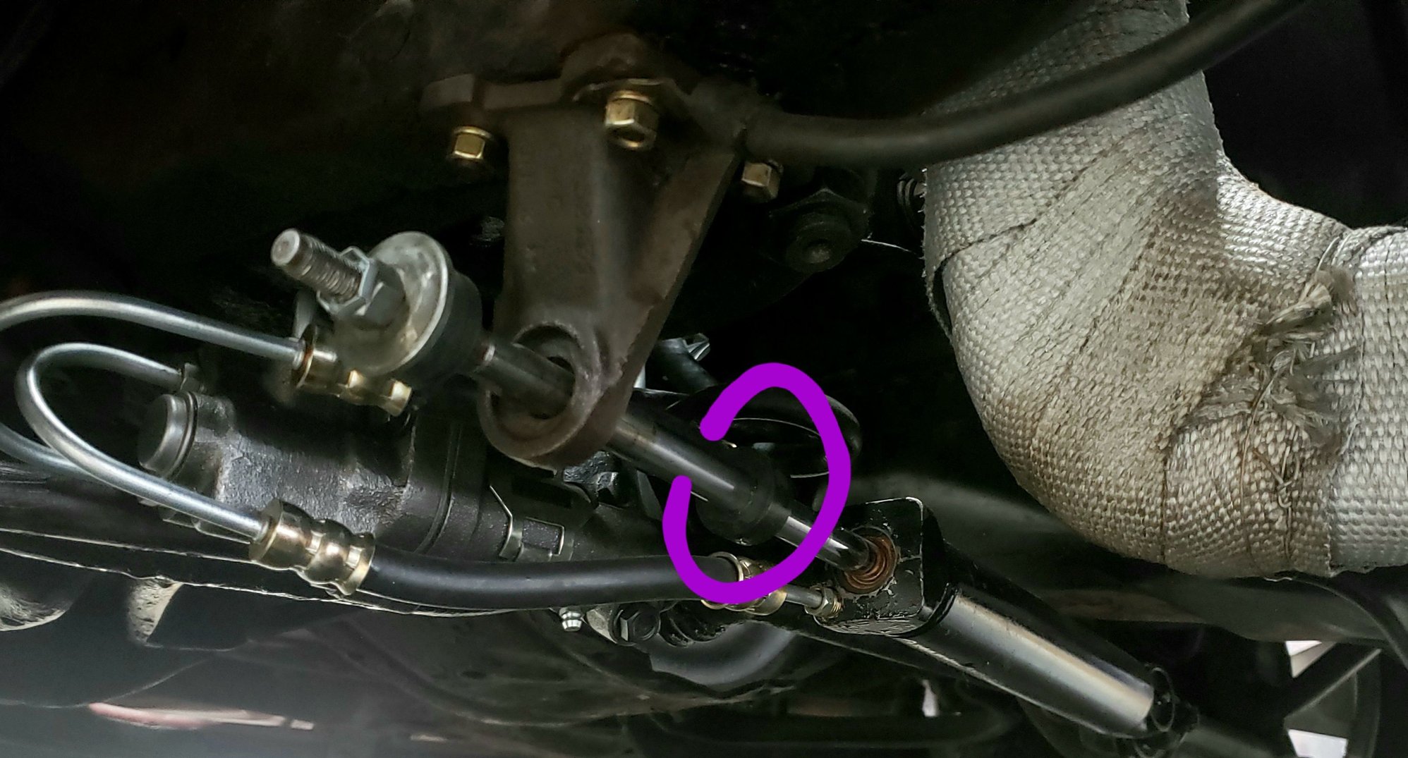

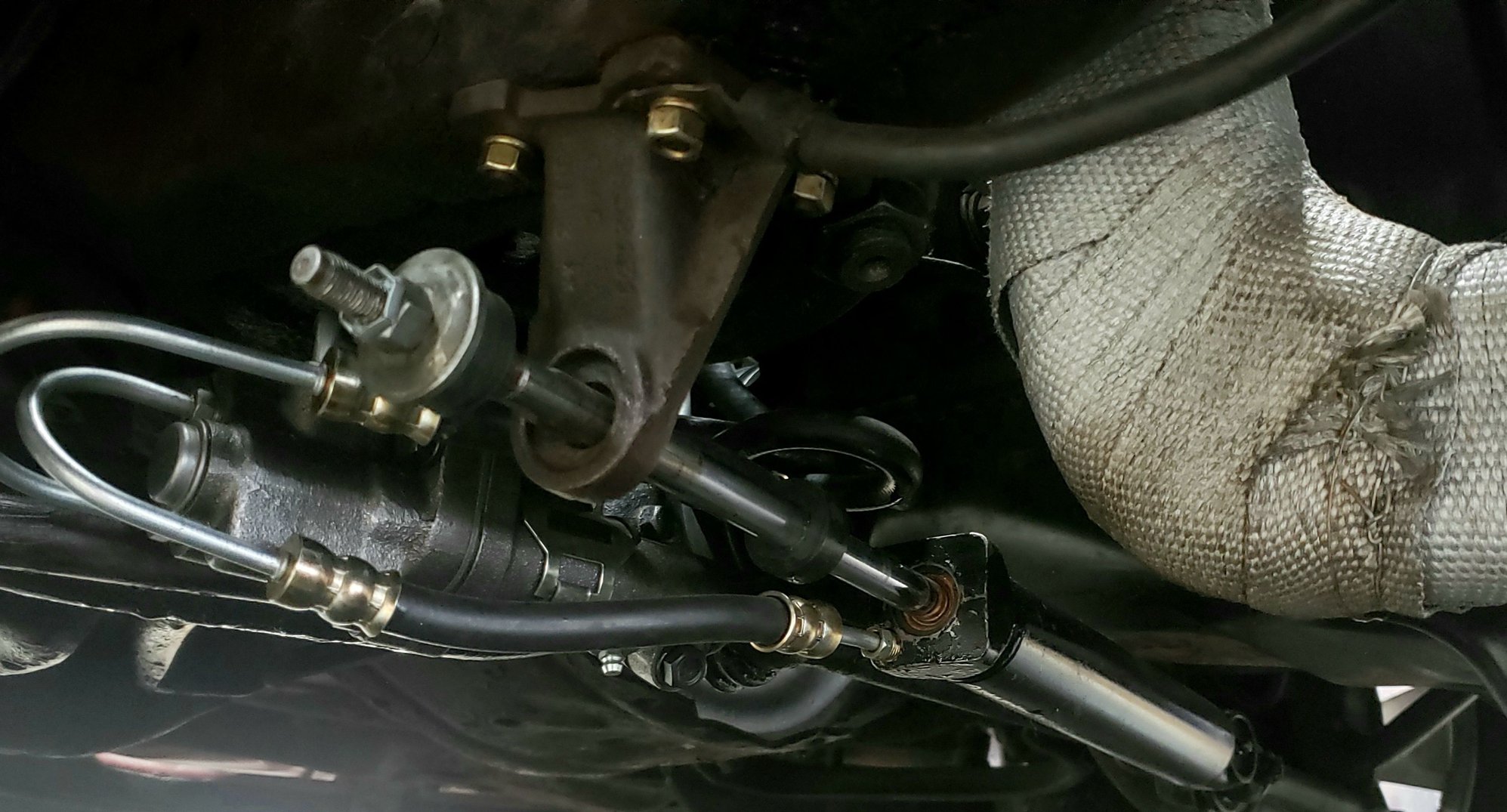

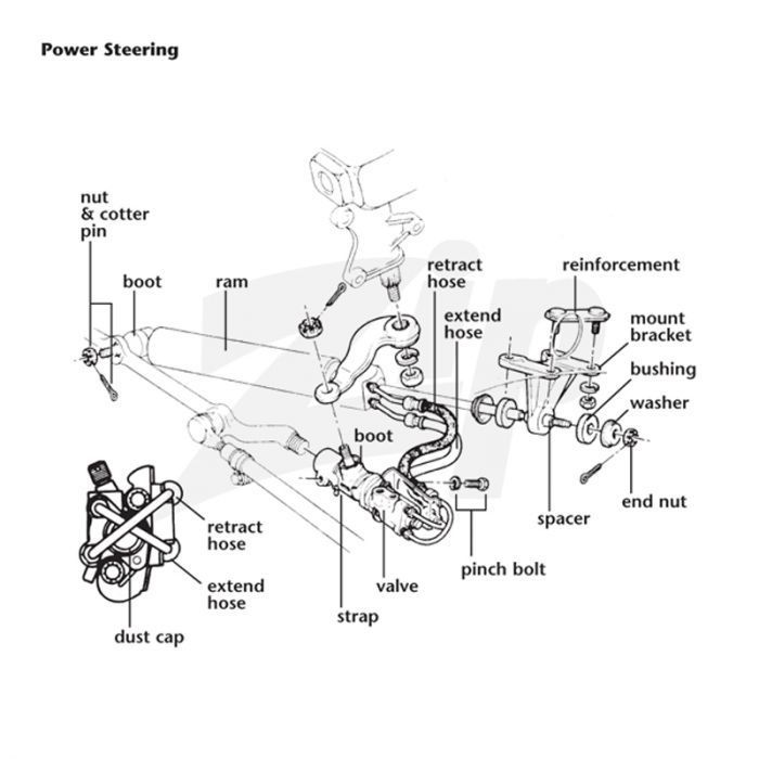

That is incorrect. you need another bushing and retainer on the other side of that mount. That rod must be secured to that frame mount.

You mean these? I believe they came loose.
Retainer & grommet

Nothing came loose, the steering cylinder was improperly installed. You're missing the bushing and metal grommet retainer that is pointed out in a couple pictures above. There is also something weird going on with the way the mount bracket is mounted.

that pic did the trick! PO didn't have it installed correctly, I just always assumed it was supposed to be the way I had it.
So I took her for her maiden voyage to DQ just now and I have POWER STEERING!! Yaaaaaay!

I was missing the rear washer, that was the issue. And there's nothing "weird" about the mount bracket bolts. I opted to replace the stock nuts with Grade 8 nuts and lock washers. They are thicker than the stock.

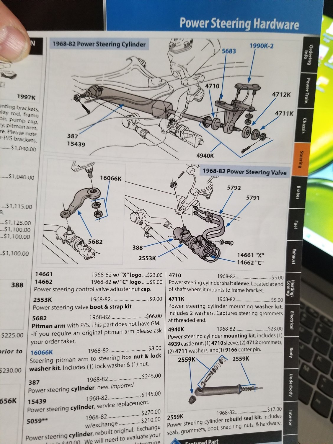

Paragons parts catalog has really good assembly pics and its free
That's Badassery right there! It looks way more informative than the AIM.
