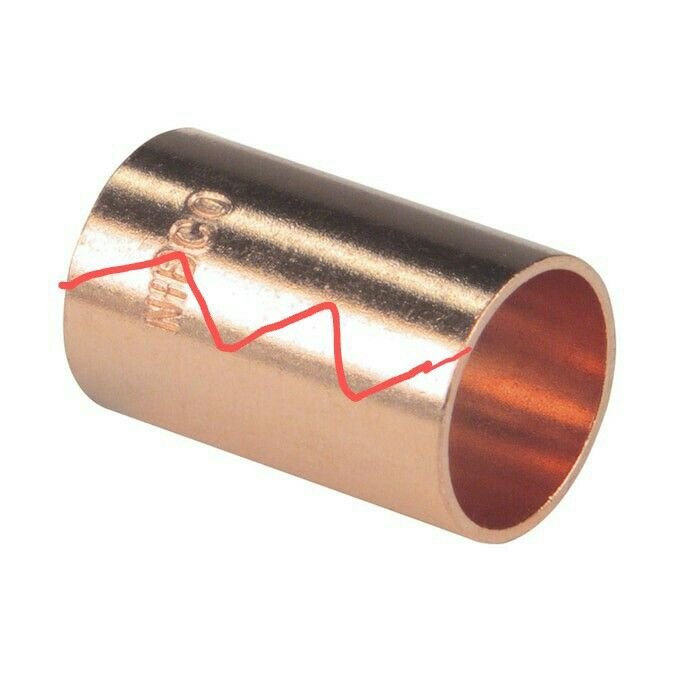

Try wrapping a thin sheet of serrated copper/.010-.020 thick onto the header tube...slide on the sidepipe...then retighten the clamp
FIRST.......Cut serrations into the copper to get a tight seal.....
