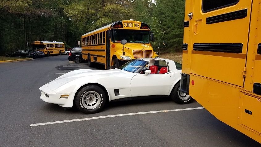

Originally Posted by Bikespace
Check the tire's max rated sidewall pressure, and don't exceed that.
I run 35 psi, and with a very disadvantageous manual steering system (short holes on arms, 14" steering wheel, 255s, lots of caster), it is manageable if the tires are spinning. Always back into parking spaces.
Hella brave dude, sneaking her in there between two buses perpendicular to you.
