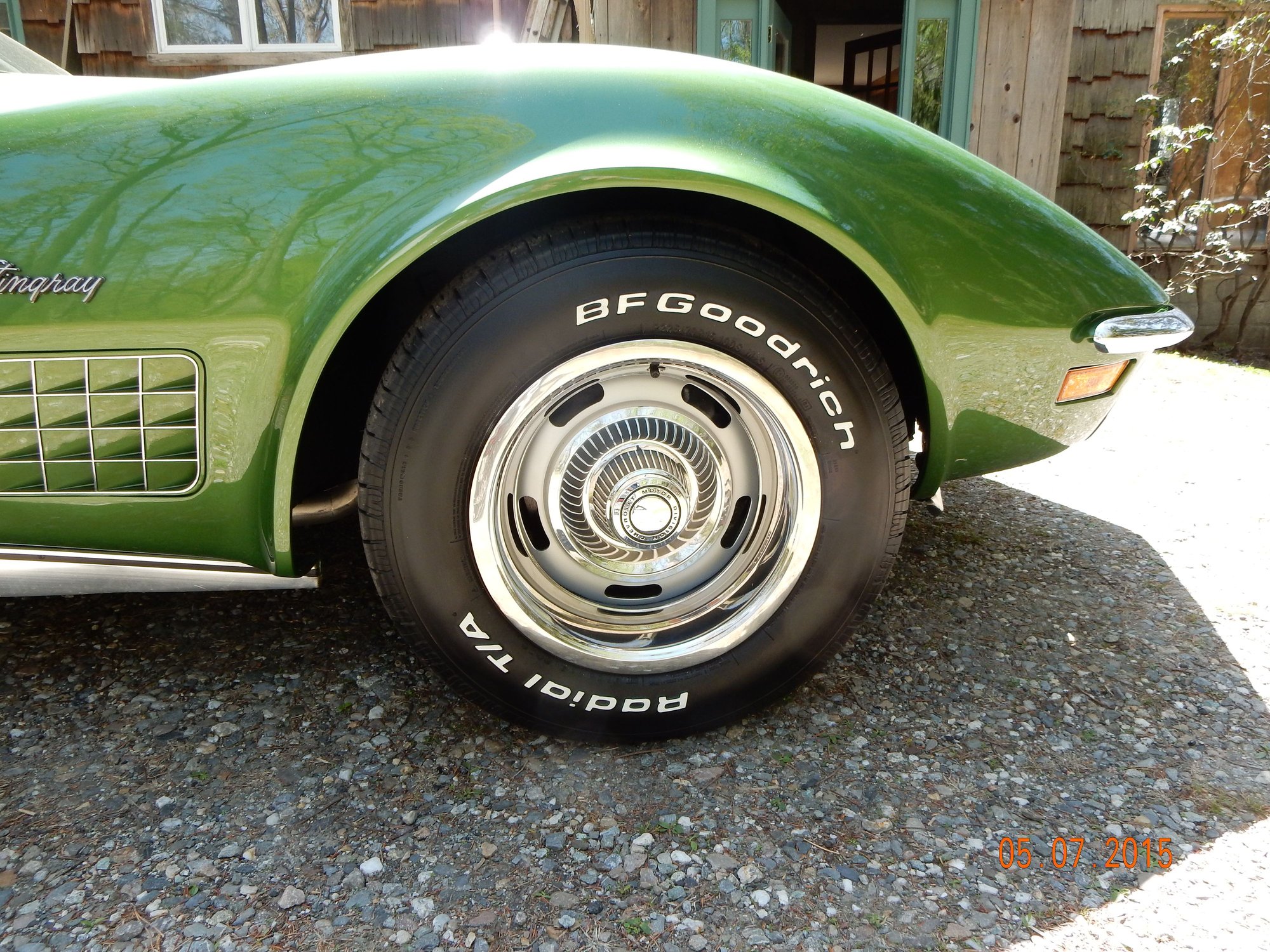

Old Jul 22, 2022 | 09:32 AM
PJO's Avatar
PJO
Veteran: Marine Corps
Joined: May 2002
Posts: 2,474
Likes: 755
From: Laporte, IN
Old Jul 22, 2022 | 04:43 PM
