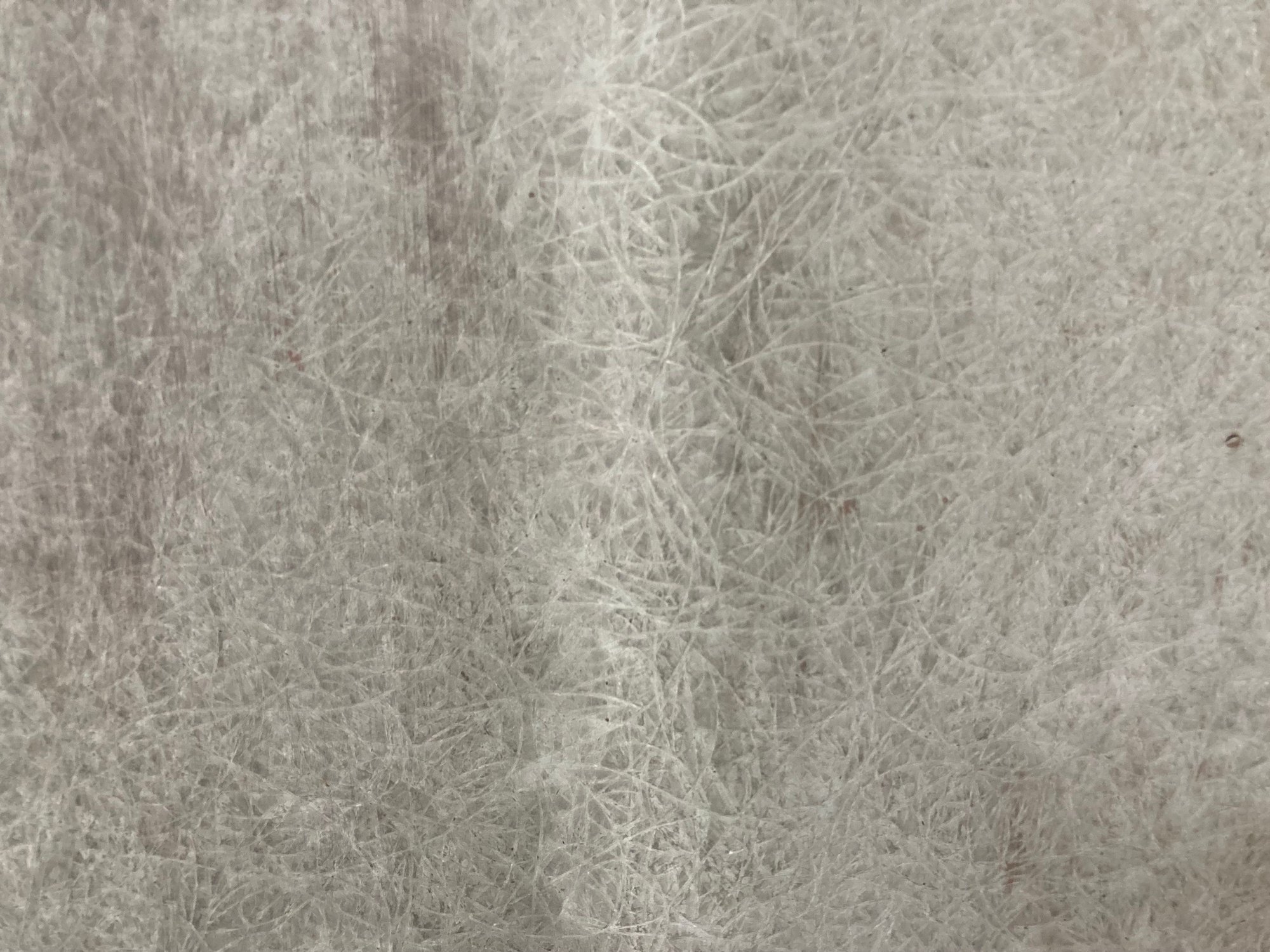

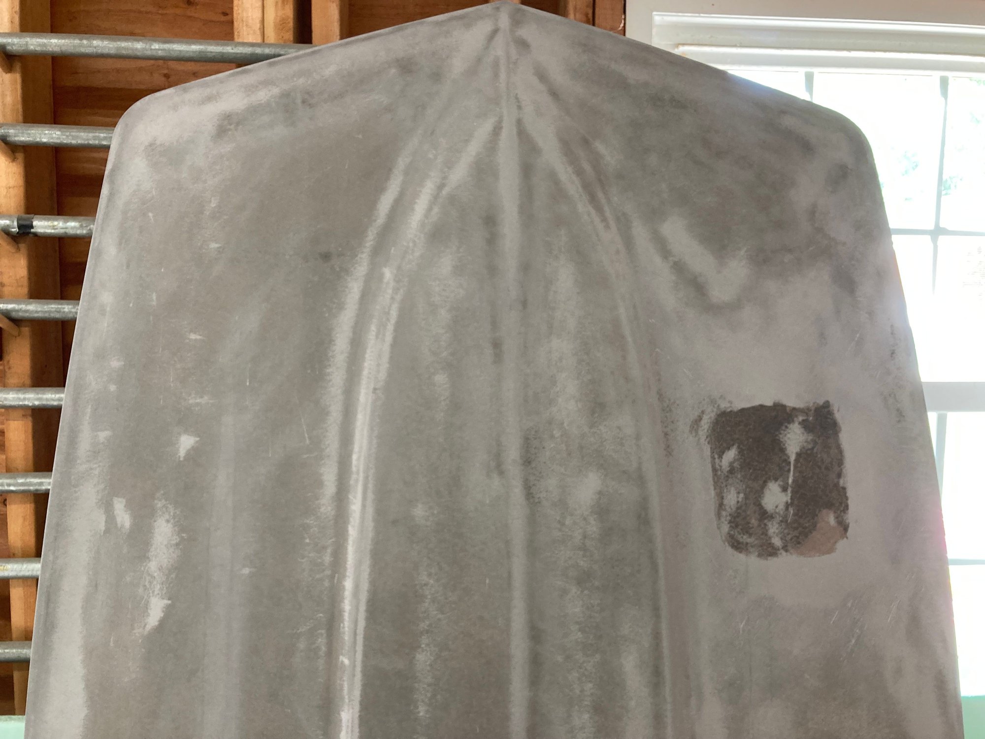

Light gray in color...Lighter spots show where the DA just scuffed the surface when stripping...Dark spot is a repair made long before I bought it.
Close up shot of the hood.

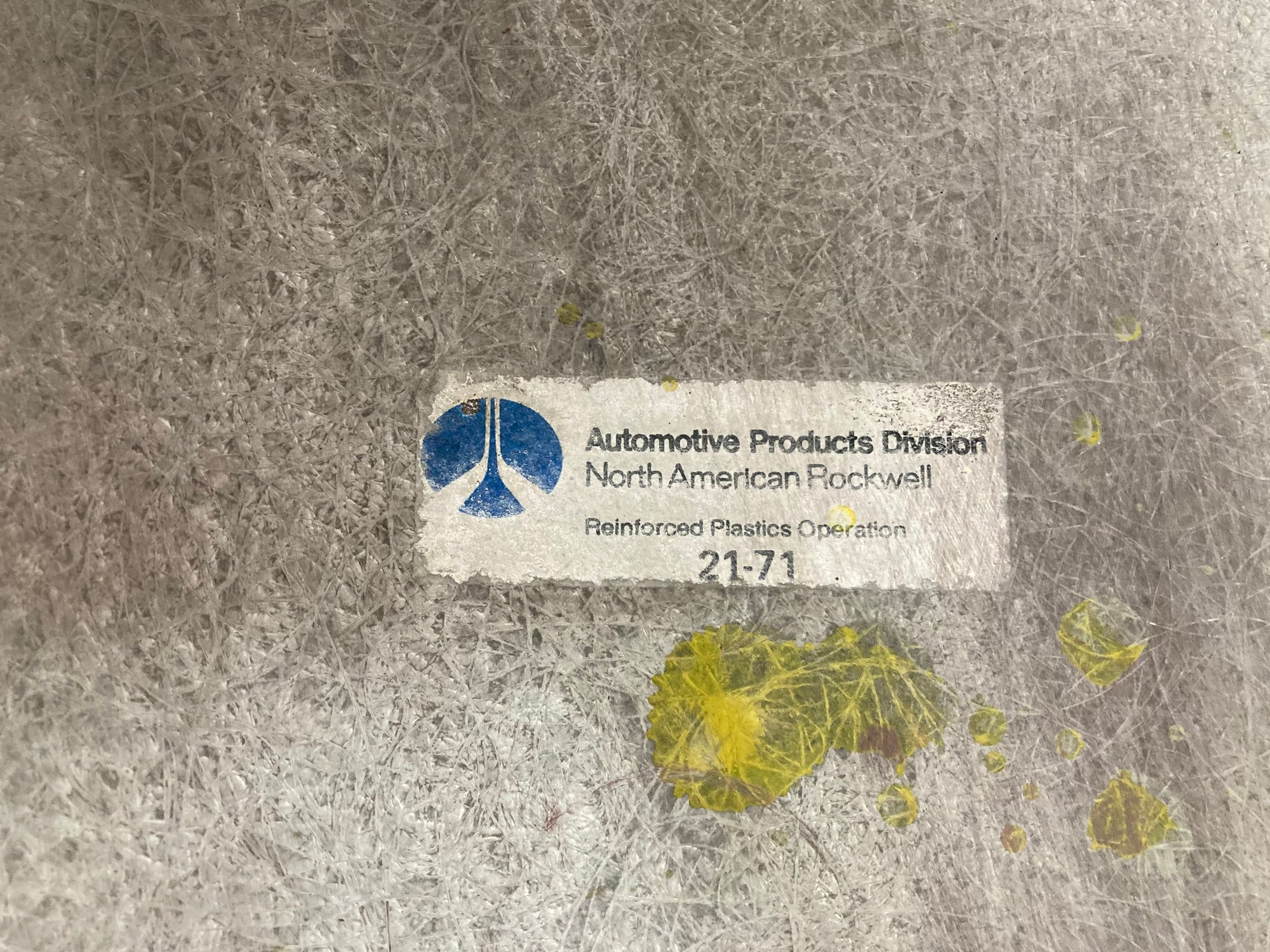

Label on underside of hood.

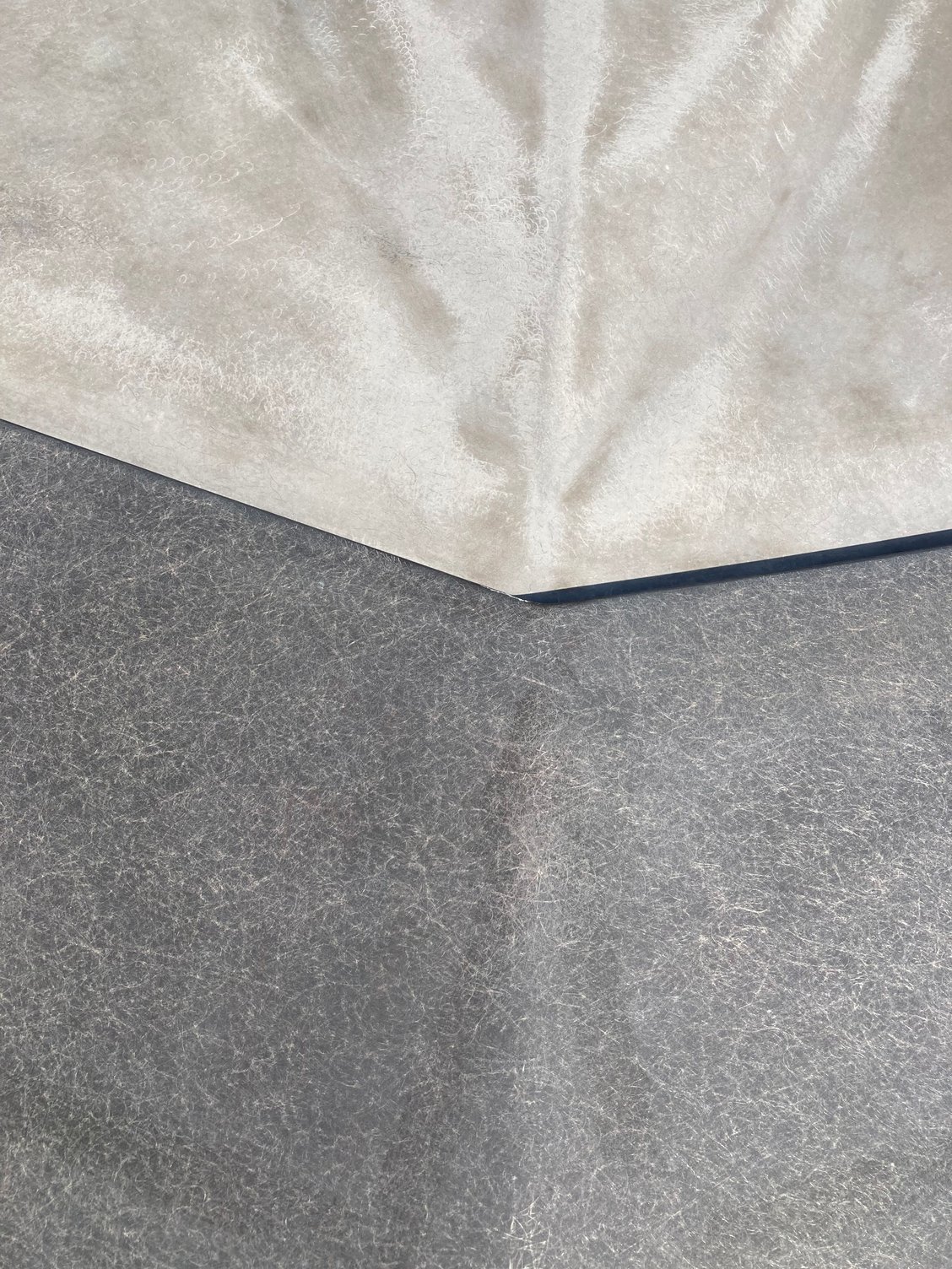

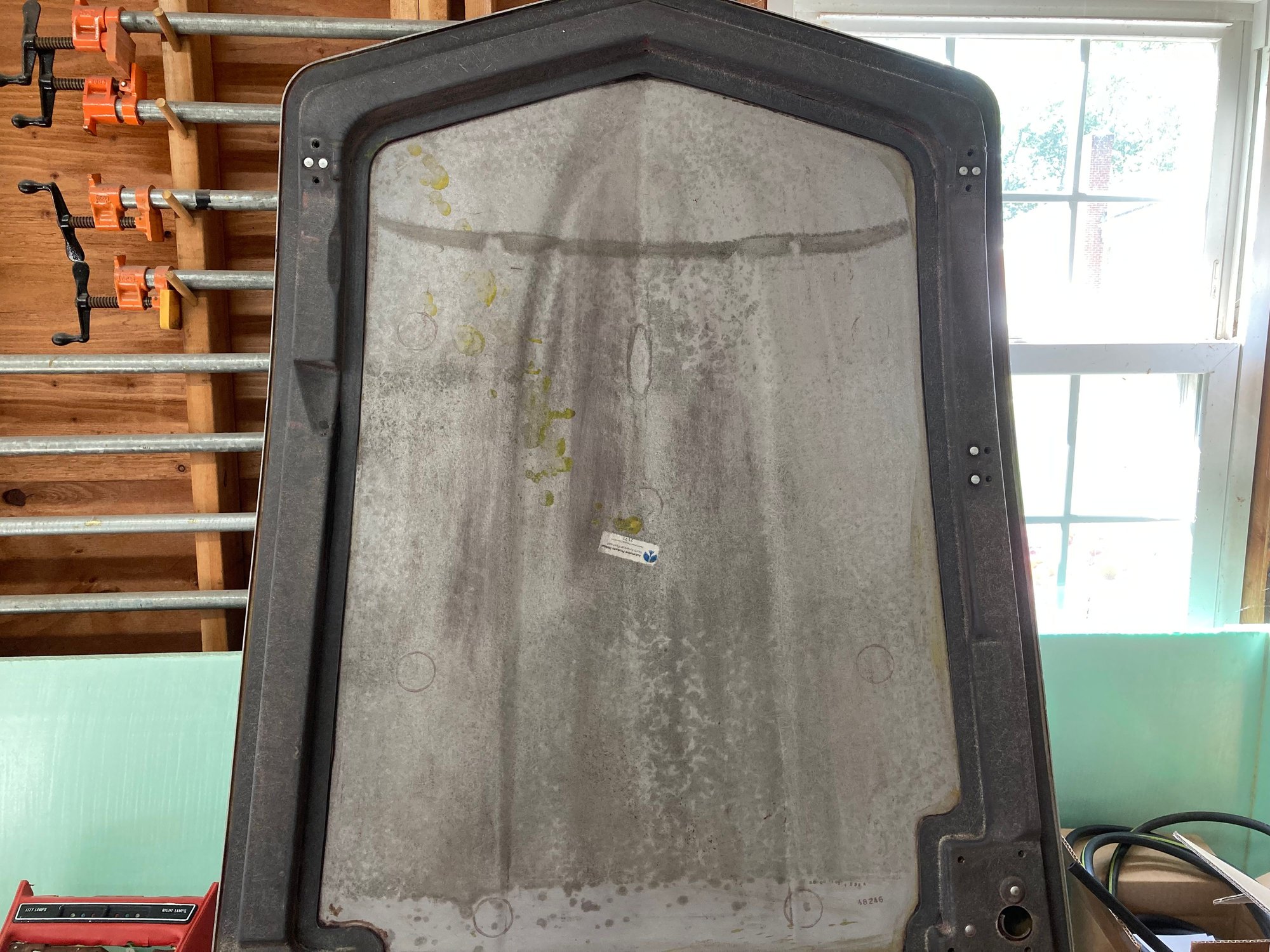

Underside of hood. Support frame and skin are drastically different in color...hood is relatively smooth on both sides. Smoother than the inside of the fenders.
Close up of hood and headlight support bar area.

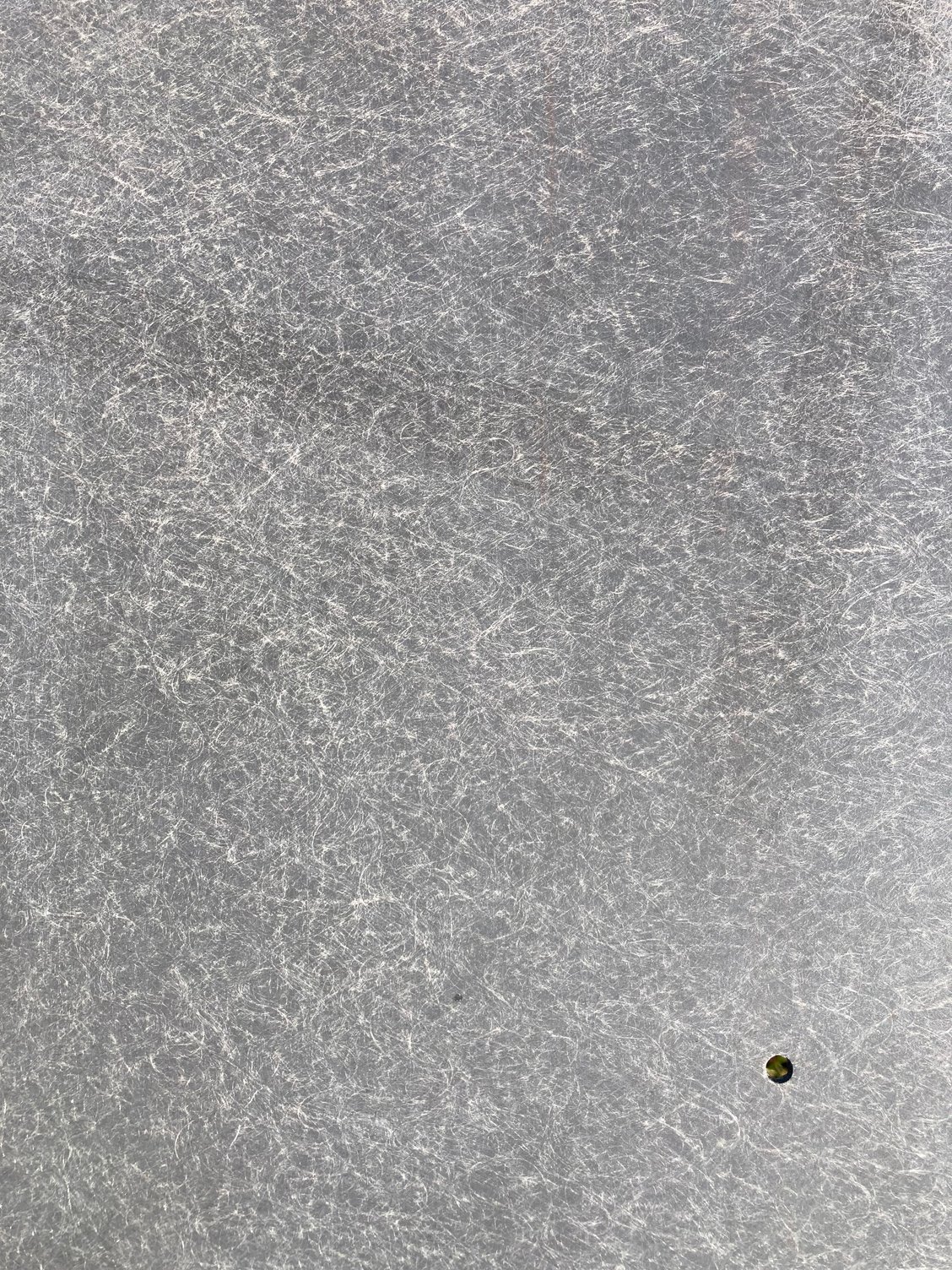

Close up of the outer surface of the nose. The hole is for the emblem between the headlight buckets.
This sticker is located inside the D/S fender right above the hole for the Egg Crate. The surface is certainly rougher on the backside.

Sure looks like fiberglass to me! Not sure why it would be anything but.

I always thought the early vettes, pre 73 were fiberglass and then in 73 they were made from SMC. When I started to strip the body panels I began to wonder if I had a mixture on this car. Then I read how they seemed to increase the use of SMC year by year. I was hoping to use poly resin for the repairs on the nose since it's supposed to be a little more forgiving and less expensive. Being a novice at fiberglass and reading about repairs that simply peeled off has me a bit anxious so I was hoping to get somebody who knows what they are doing to confirm I have fiberglass...so far. I only have the front clip stripped at this point. Lots of sanding in my future. Lots of learning as well.

My 71 inside hood is somewhat smooth but gets rough, like press molded, on the edges where the hood mount frame is bonded to it. My front fenders are textured and are for sure press molded.
The rear of my 71 is much smoother all over and is for sure SMC.
