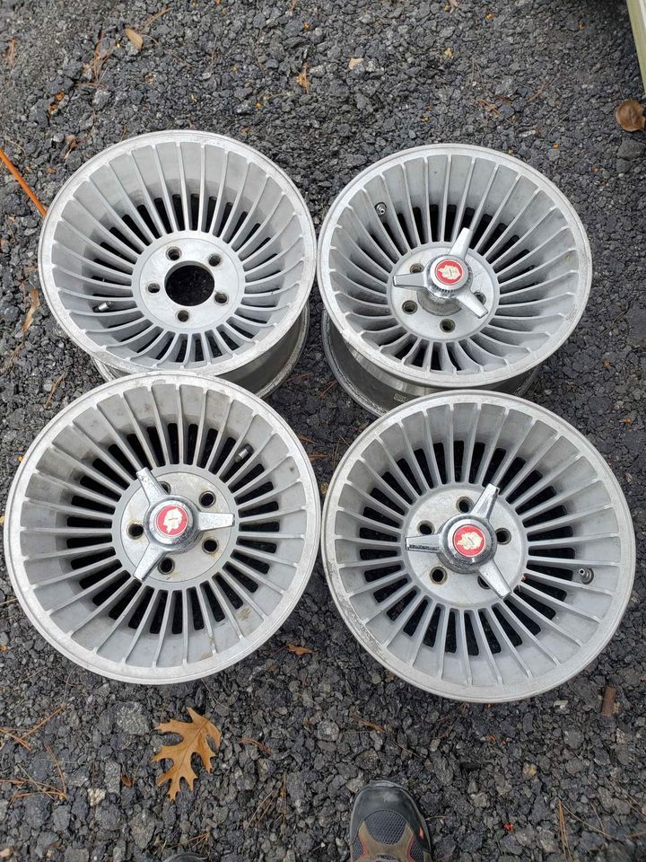

I have tires being delivered. 2x 255/60/15 and 2x 275/60/15. Anyone know if these tires will fit on these western turbines?? 15x8.5 rims. Not sure of the offset.I know the tires will fit the rims and lug pattern matches but not sure if this set up will fit properly in the wheel wells?
I have a 79 C3.

Did you double-check the back-spacing? Were they previously on a C2/C3? Your front tires 'might' rub a little at a turn going into, like, a gas station. But minor trimming might resolve that (if they do rub).

thanks for reply. They are for sale locally on marketplace so wanted to check if anyone here had done it before buying them. They came off a C3. I know they fit. But not sure with my size tires. And since I’m unsure of the offset of these rims I’m not sure how much they’ll come past the wheel wells (or not).

If you can go look at them, lay a straight edge across the rim and measure from the flannge surface up to the straight edge. That is the back spacing. If its 3.5 they may stick out in th erear and rub wheel well at the bottom edges when you turn the wheel. I had to trim out the inner lip a little at the bottom
Where in Mass are you . I think I saw those rims of FB market place. He says they are the correct offset for C3s If they dont fit there was some 82 collectors editions up in NH for 1500 bucks.

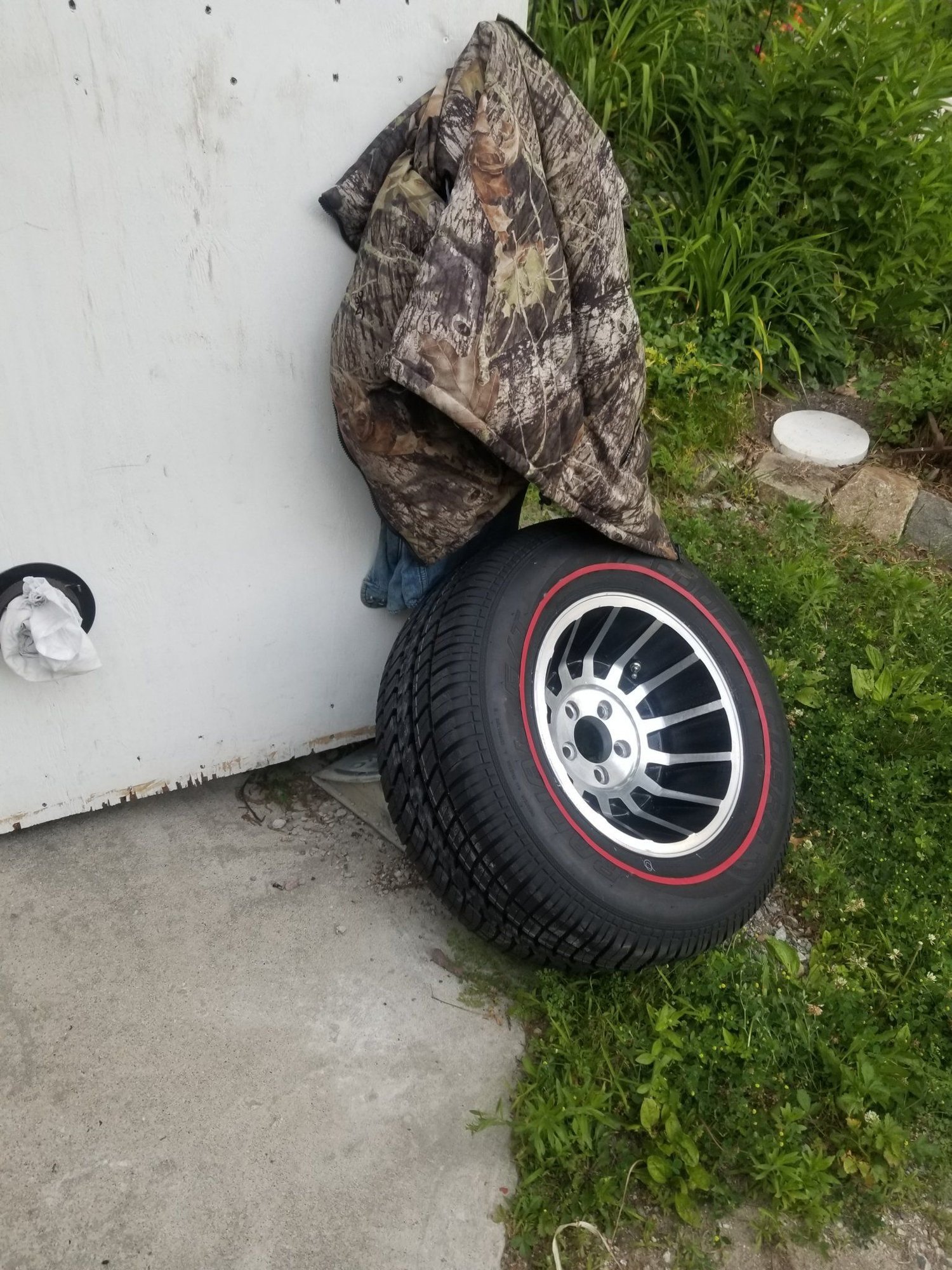

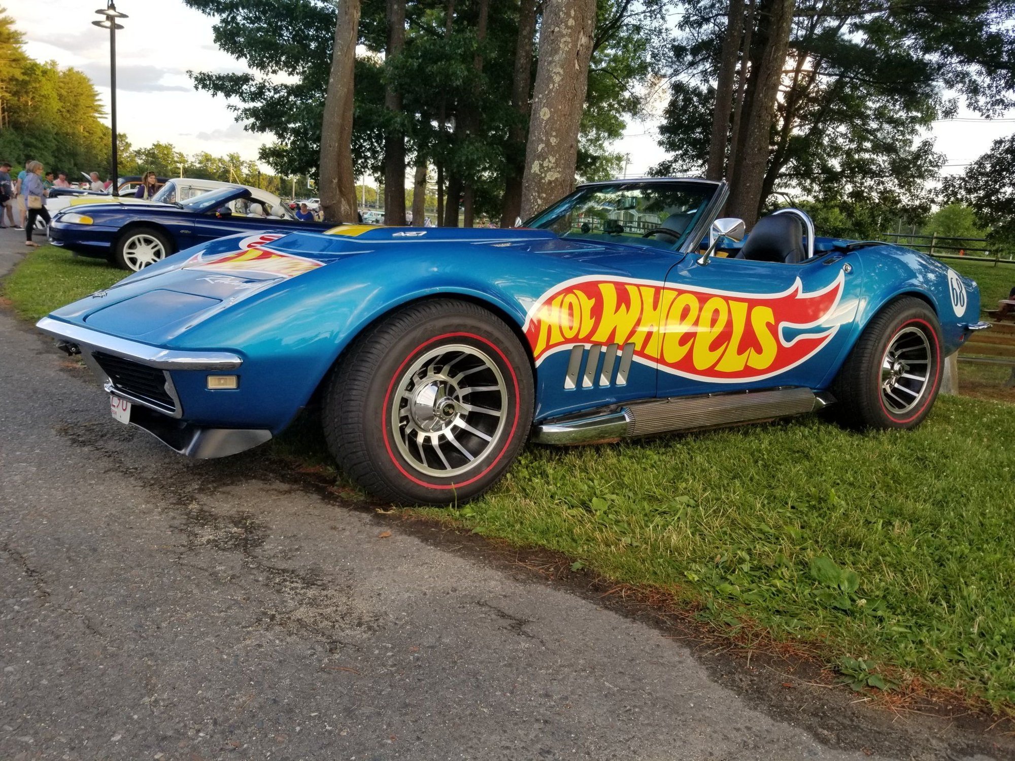

I have a slightly different style but they will look awesome if you get them

oh I like those too!! Also westerns? 15s? Redlines thanks on a hot wheels.

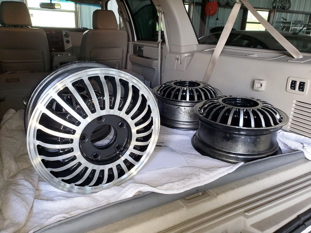

I bought a set of turbines for an Eldorado (very unusual offset). Had them straightened and refinished by a wheel specialist. They turned out great.
