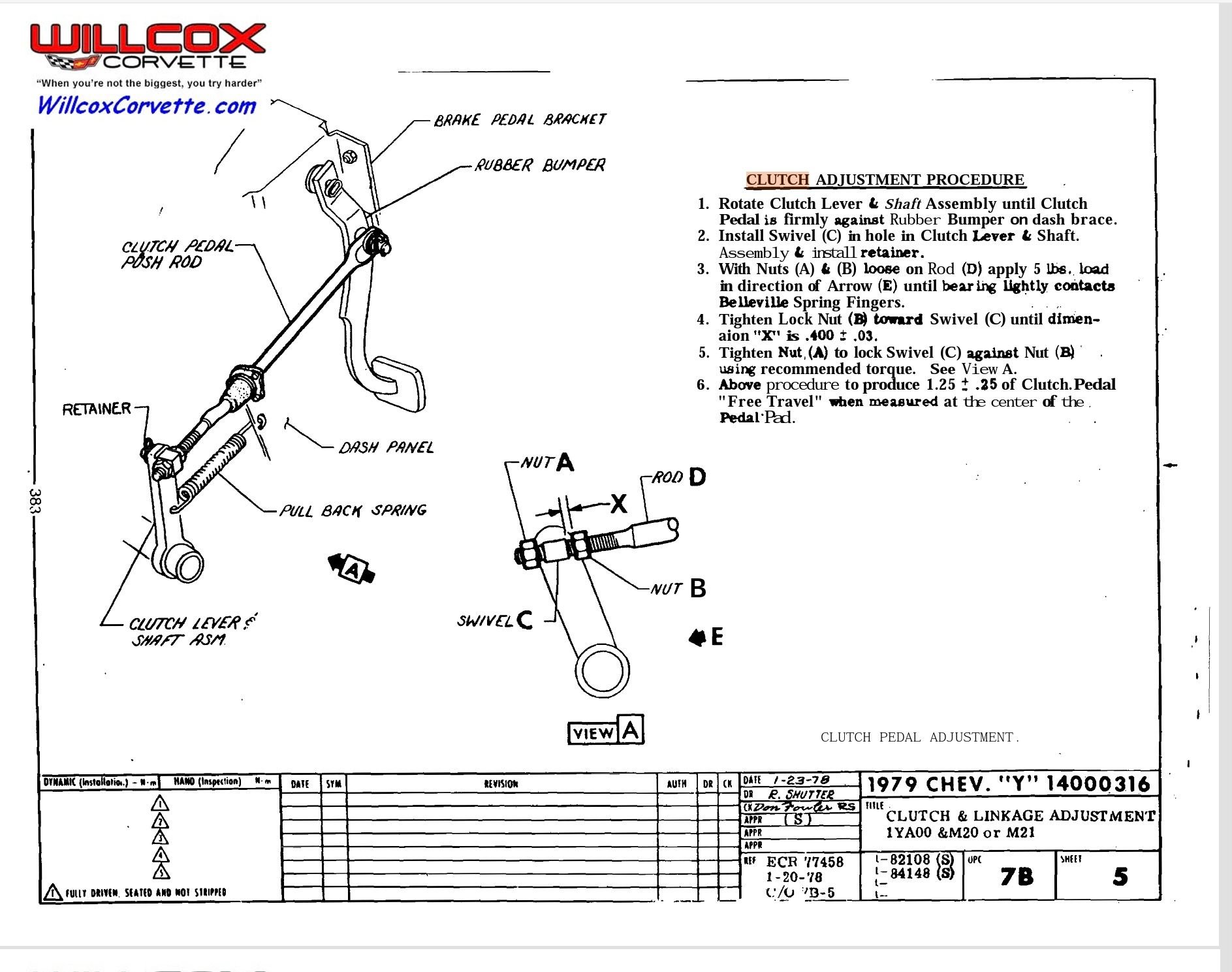

- check transmission fluid…if not changed in memory…change it..i like synthetic
- inspection and pictures of linkage..loose nuts etc..
- linkage alignment
​​​​​​- clutch adjustment verification
post 59 to 6x may be helpful

Your shop manual has the procedure to adjust the clutch linkage. Perhaps some worn engine and/or transmission mounts are causing the engine to move relative to the clutch shaft.
Do you have a crossmember-mounted (stock) shifter? The movement could be seen there, too.
Get under the car (safely!) and take some pictures!
