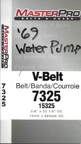

After a bit of trial-and-error and a few trips to NAPA, I found this one that works on my non-smog L71:

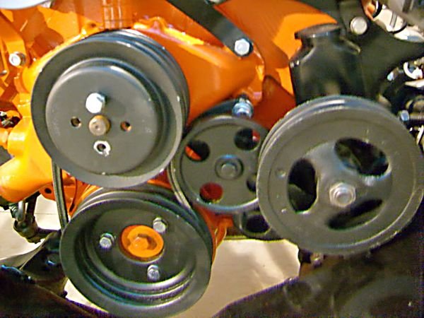

Crossed up, Does your car have the 68 style idler pulley, or the normal 69 style?

I have that belt.I removed it when I put the smog back on. I could measure it for you.
it May have a number. Let me know.

If your tensioning pulley is a smooth pulley with no groove for a belt and pushes on the belt, then the only way to get a correct belt on is to remove the fan and loosen the pulley enough to slip the belt over the crank pulley and then on the water pump pulley and then bolt everything back together. It is a time consuming pain, but I haven't found an easier way to replace it. The belt that I ended up using is 31.86" long and has a GM number 3952336, Zip FB-298 and Paragon 2481.
If the pulley has a groove for a belt then this info won't work, but I have never seen a grooved pulley.

Thanks for the info, but mine is the early style with the grooved pulley

It’s 46 5/8
Quanta products
they will help you out.
