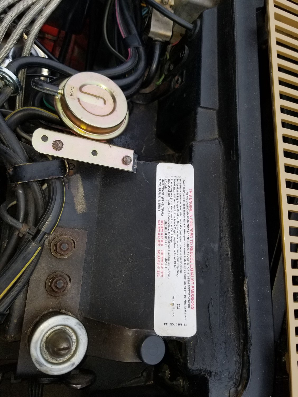

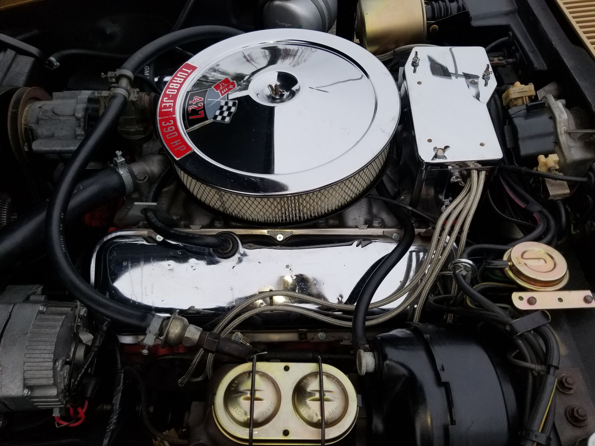

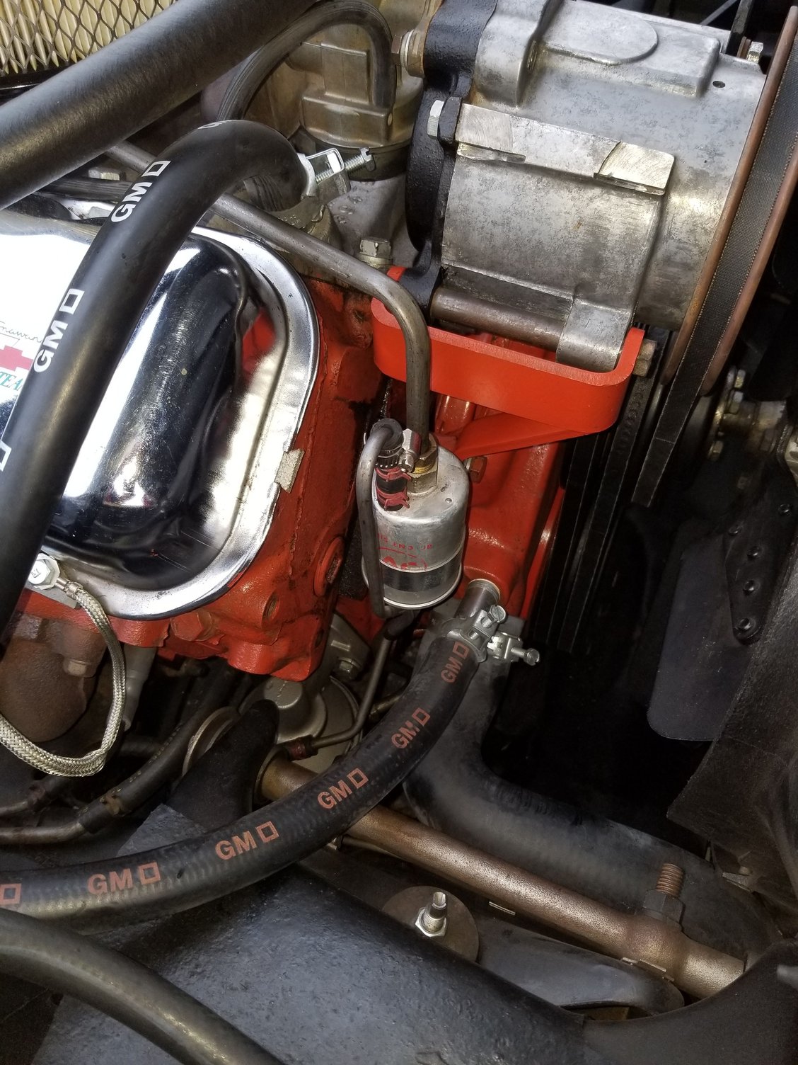

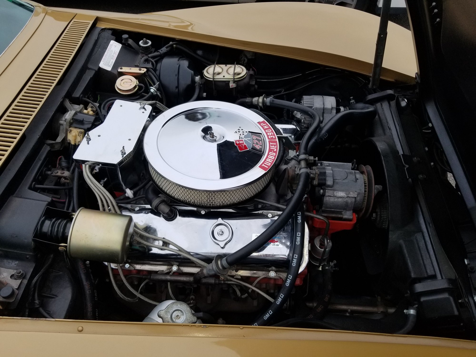

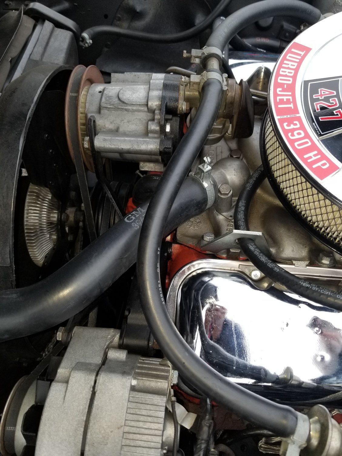

I took these at a car shoe of an NCRS nearly perfect car or so says the owner. Bought at Mecum...yada yada yada. Anyway these are all the pics I have, hopefully you can see the fuel line vapor return. I just happened to take them because I was originally told the big block cars didnt have fuel return lines......guess we can scratch that off the identifying traits list

Thanks RR! Pictures have helped as I see that line runs just over the fuel pump and not near the other components that were causing me concern. Thanks again and as usual it’s so helpful having forum members helping others out.

L36 doesn't use the steel clamp with the upside down P marking.
