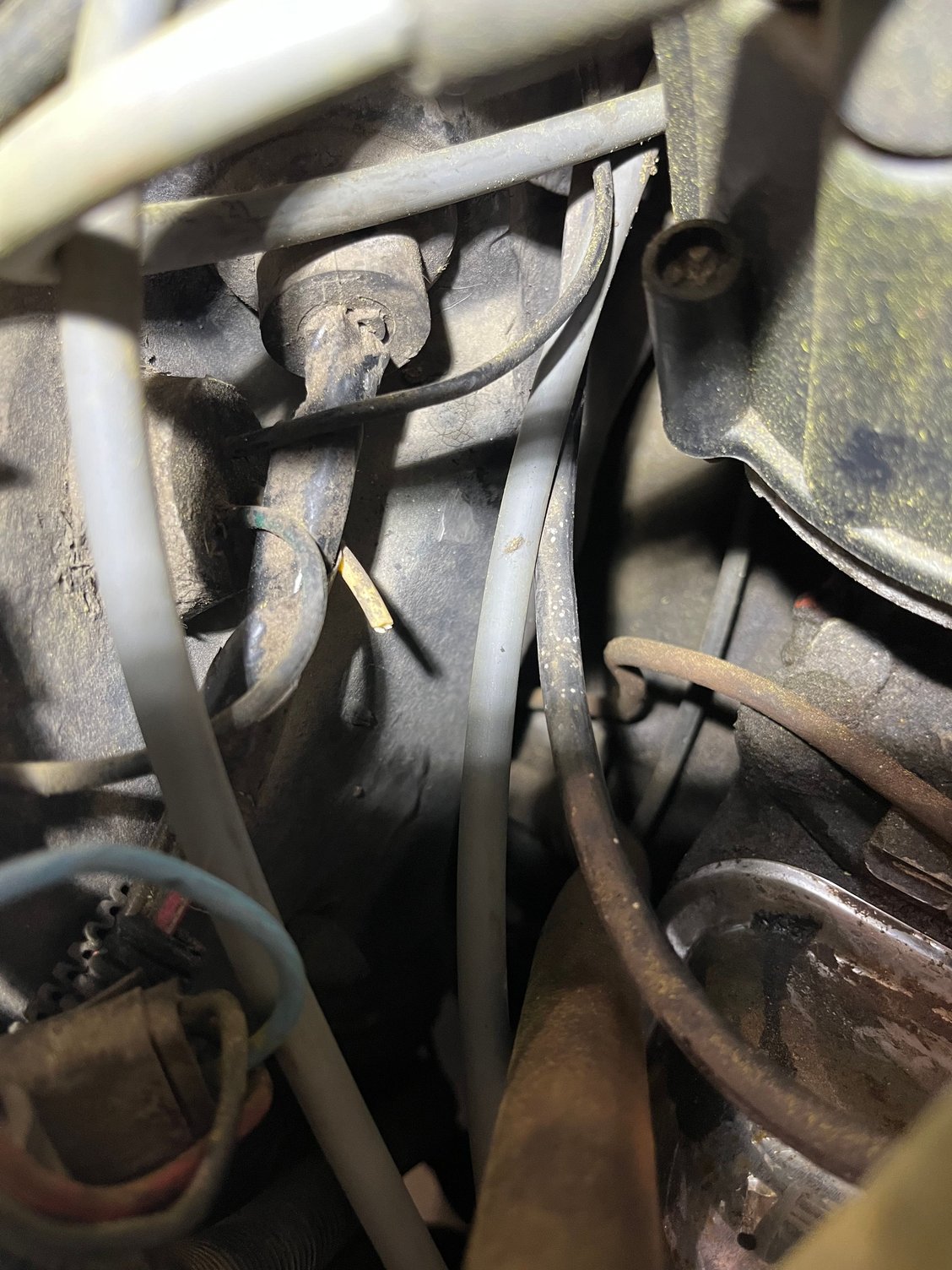

What/where should this broken line go?
How it looked when I got it mid December. Spoiler delete. Sold the American Racing wheels.

The white vacuum line goes over to the hot water/coolant shutoff valve. It supplies vacuum to the shut off to shut off the heater core.
Is that why it’s always warm air coming out vents?
Any photo of the valve it goes to?

Yup, that was my first thought to.

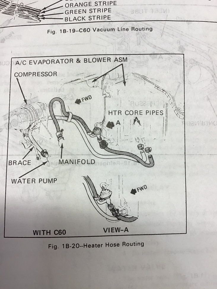

look here
https://www.corvetteforum.com/forums...e-79-w-ac.html

the valve never worked that well. install a shut off valve. the first and most important thing to keep the interior cool is keeping hot coolant out of the interior.

This line was next to it and also unattached? Where does it go?
To Broken line
