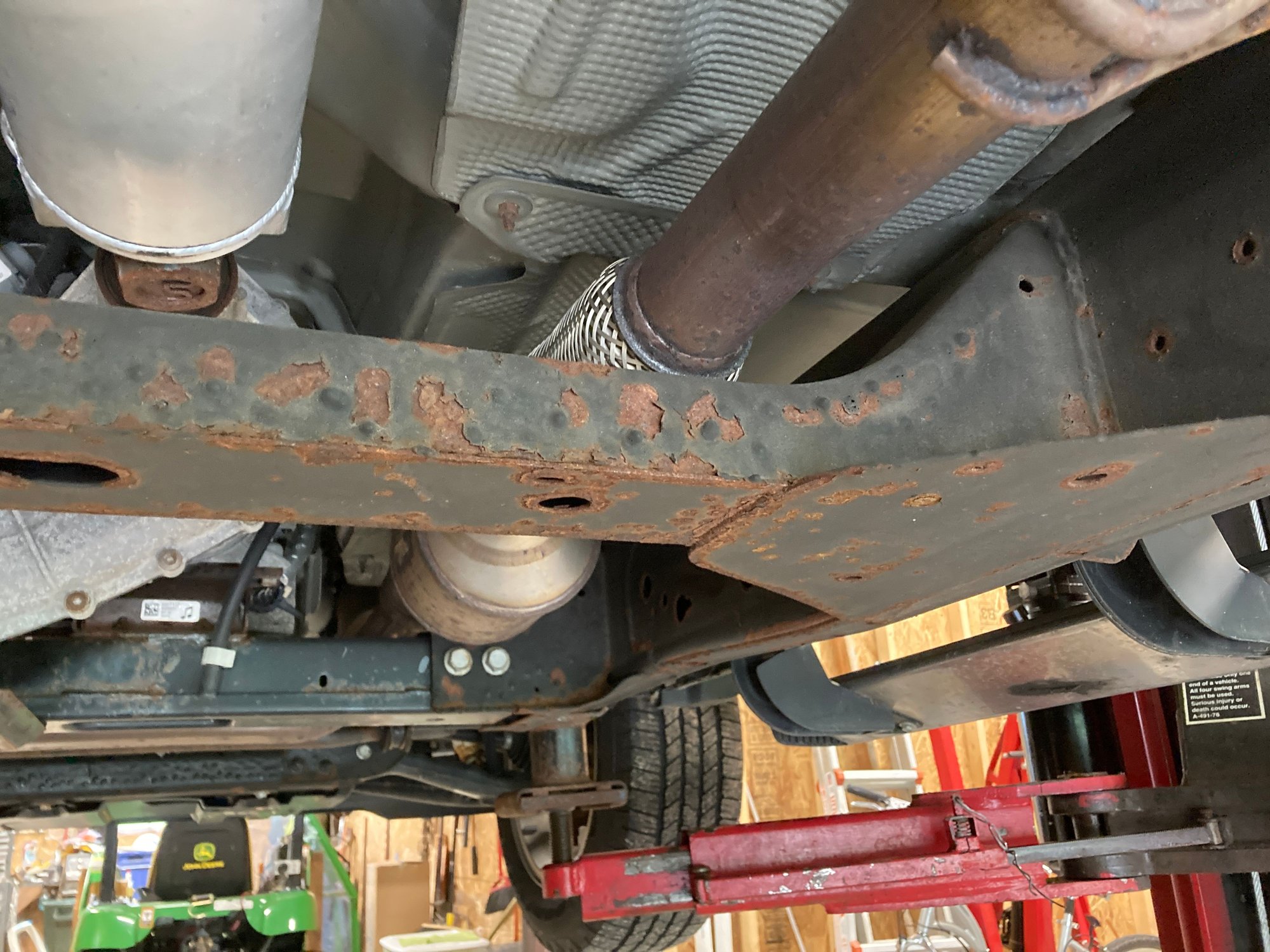

Sorry this is a little off topic but I think there are more rust control experts on here than anywhere. Lol
I just bought a 2016 GMC with only 13k miles on it, and it must have sat outside a lot in the last 6 years. Everything but the frame shows no indication of exposure, it’s in really nice shape, even still has the new car smell.
The frame however is starting to show some scale. See pics.
I was wondering if I brushed off the loose stuff and sprayed por-15 over these areas if it would arrest the rust progression. Or maybe some other product? Are those brush on rust converters worth anything or are they snake oil?
Thanks in advance.

That's not bad. POR stands for "paint over rust", so it should work just fine for you. Wire brush the lose stuff and scuff up the painted part with a Scotch Bright pad. Prep is important when using this stuff or it won't stick to the smooth painted surfaces.

I would brush it not spray it.

I would use POR 15 over that, but clean the rust off first anyway.

You can wire brush it, then use a rust converter on it. You could then paint a good protective finish to protect the metal for years to come. Make sure you use some internal frame spray to protect the inside of the frame as well.

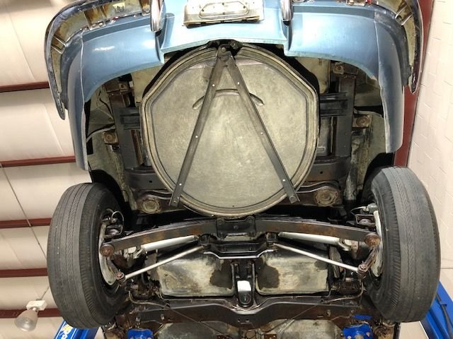

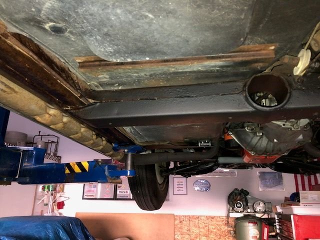

Clean the loose paint/ rust dirt off and then brush on the Gempler's. You can paint over it but not really necessary. I am not a fan of POR-15. You can find posts debating Pros/Cons.
Before Gempler's
Before Gempler's
After Gempler's

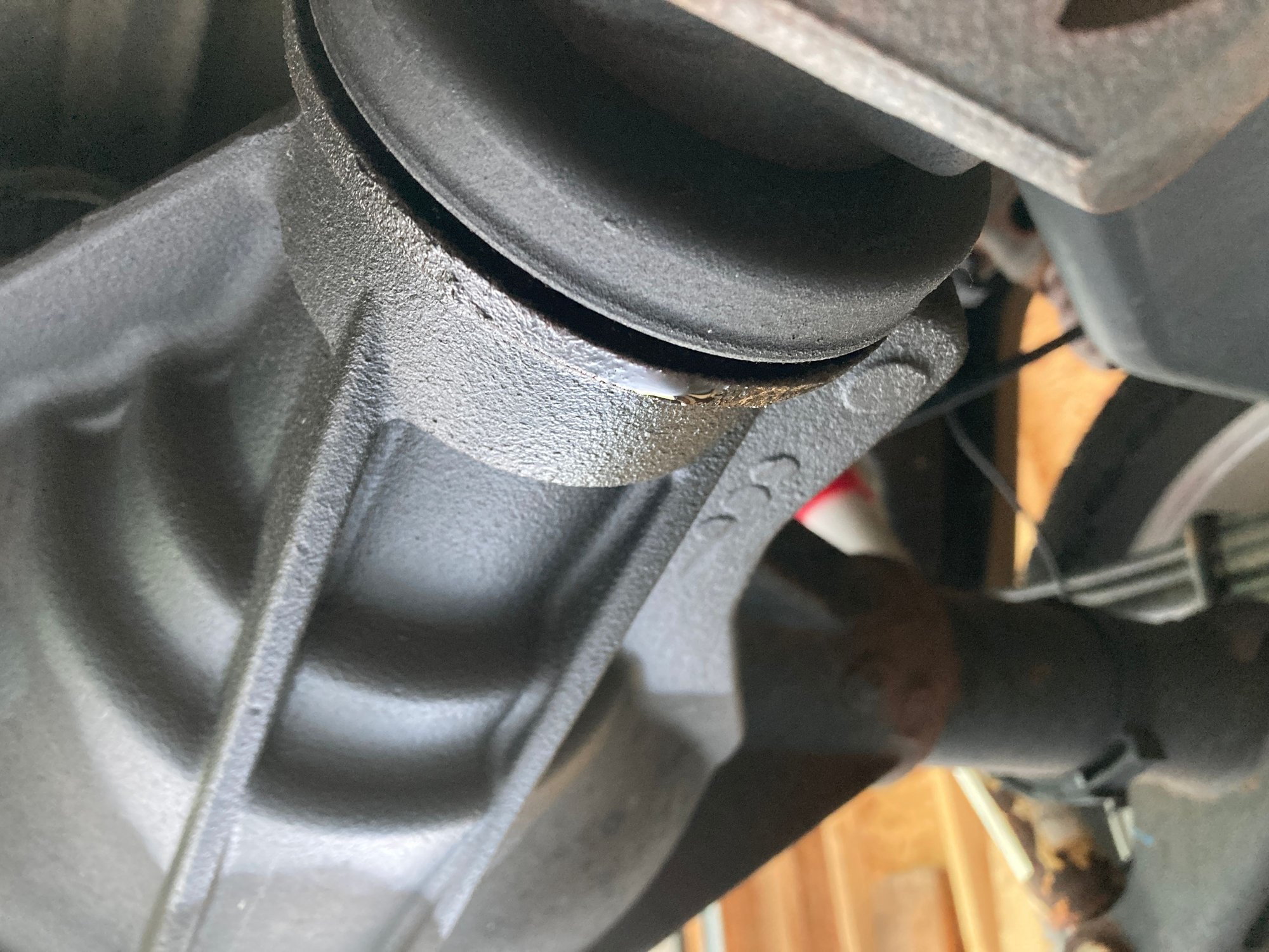

Looks like a pinion seal leak?

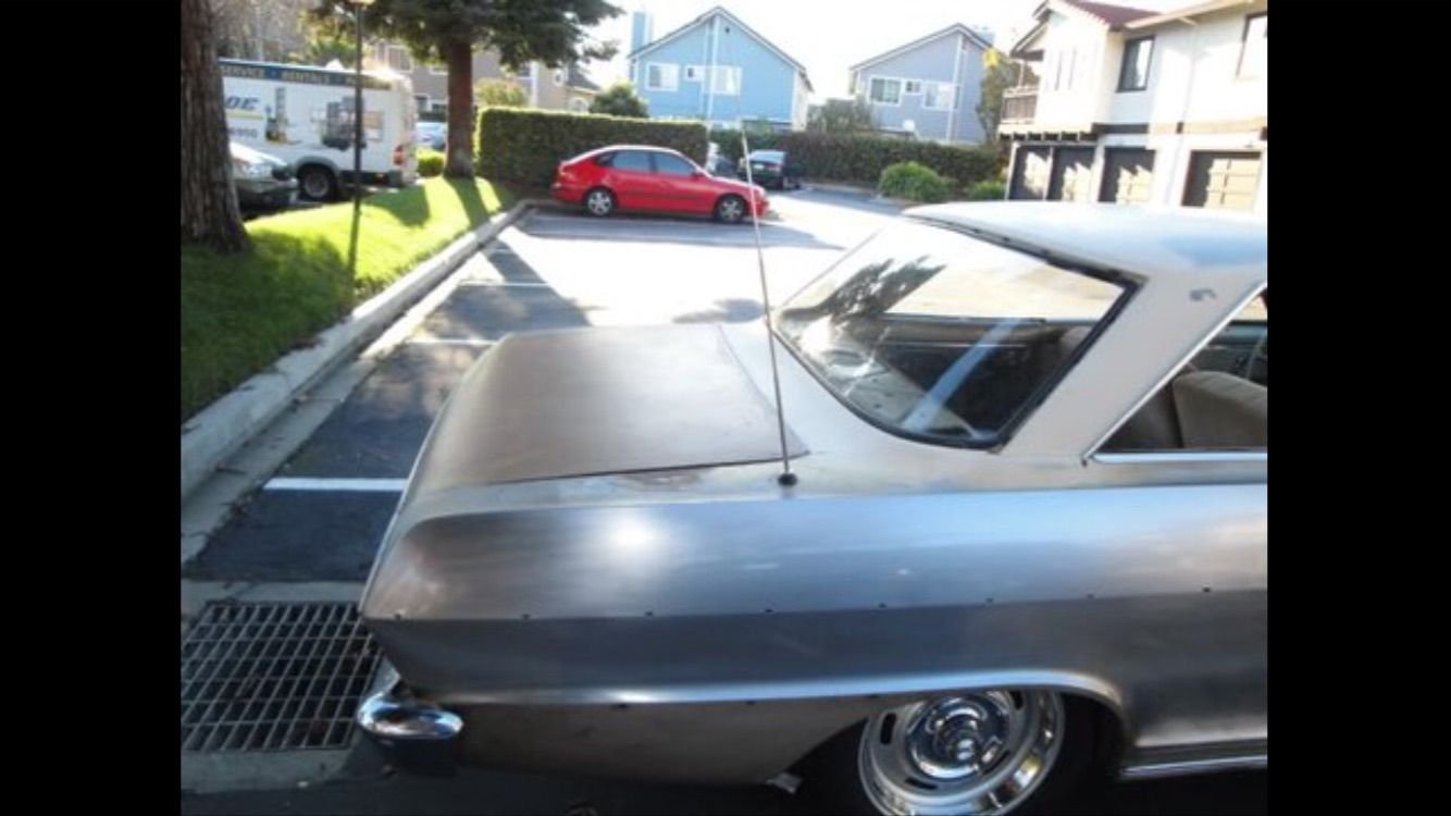

I'd saturate it with WD 40,over time the oil will attract dust,dirt and will protect bare metal. The quarter panel of this Nova was bare metal and stayed outside for maybe 3 years. Every couple of months I'd get other there and re apply a fresh coat of WD 40 and it was good for a couple more months. All my friends that paint thought I was nuts but it worked for me.
That's the self lubricating chassis RPO, my Vette had that too until I pulled the motor and did the rear main
Funny you should mention that, my truck in the OP does have a very slight pinion seal leak, just enough to cause a drop to form but not fall. Probably again due to sitting a lot over the last 6 years. Due to that age, I didn’t get any warranty, but I’m debating asking them if they will cover the repair anyway.
