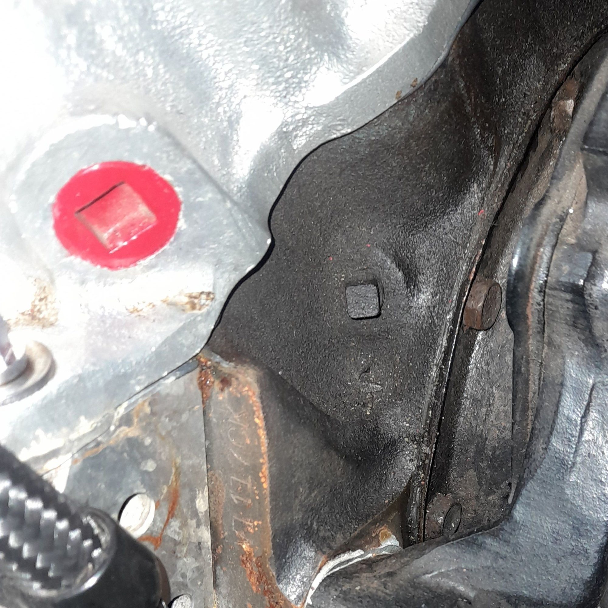

What is the purpose of the screw in the front of the engine and what’s the best way to keep it from leaking?

Its an Oil Pressure Port that nobody uses.
Remove, clean threads, wipe off port, dab of Permatex Black.

Yes, remove pipe plug. Clean and reseal.

Yellow thread tape will also work - yellow is petroleum rated

its a oil fitting only found on flint cast SB

be carful getting it out it might give you a hard time

Suggestions on getting it out? The oils leaking out so it should be lubed….

get the correct square head sockets

Open-end wrench
Channel locks
Vise Grip
In order of resistance.

Well, you made me go look. Yup, I have a pipe plug there to.
And just look at how grubby my engine is looking! Now I have to get cleaning! See what happens when you look!
