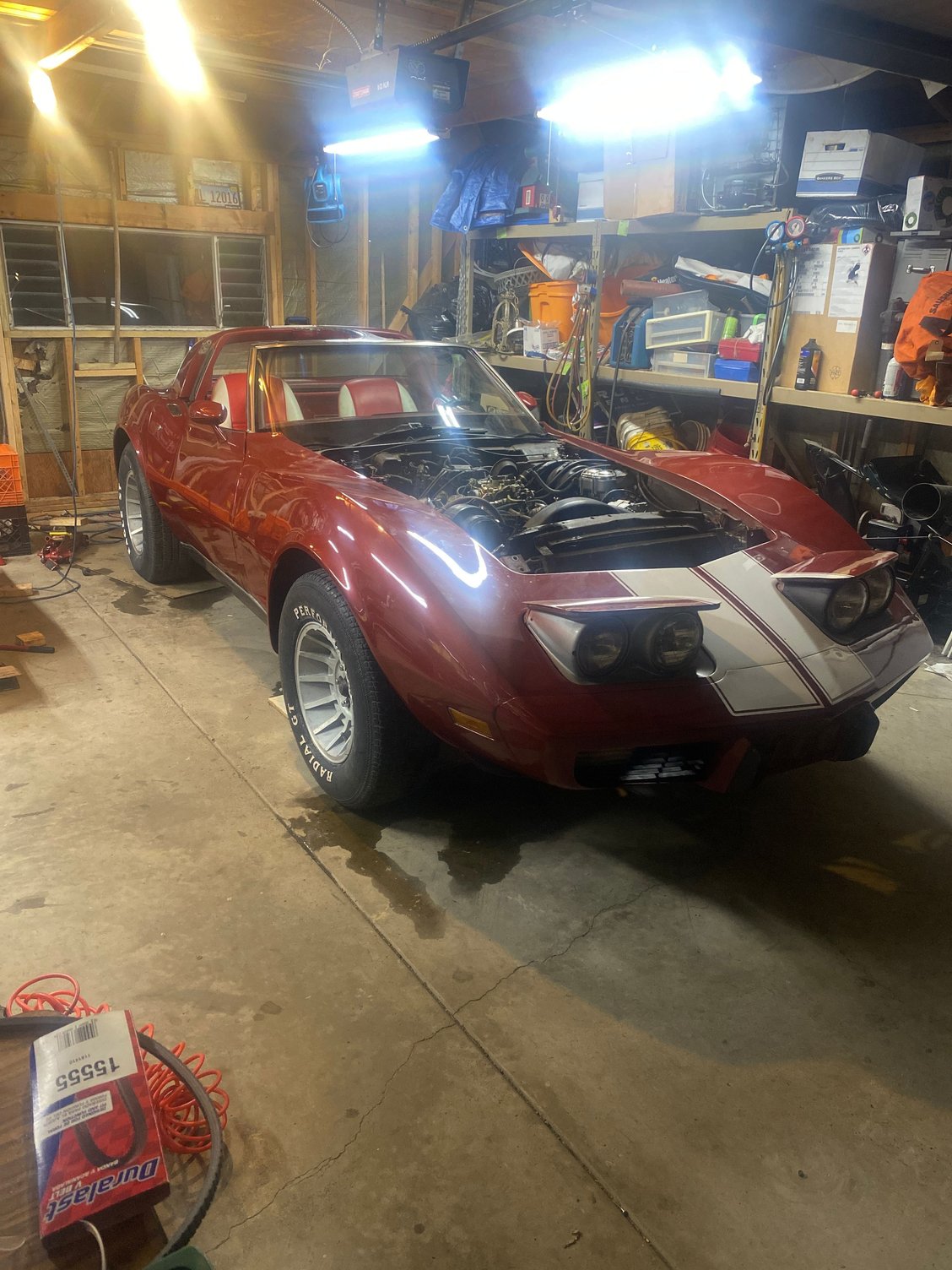

My little darling 78 L48 has been through hell. Every task is a world of wonder. Seems prior butcher removed the timing mark indicator. Looks like he changed the harmonic balancer. Since it’s bright gold. Why is an unknown? The gold thermostat housing has kid written all over it! Anyhow pretty sure timing chain is good. Distributor moves back and forth smartly with crank. Engine now runs with rebuilt carb. Vacuum gauge reported late timing. Started to set up timing light. But the indicator normally on chain cover is long gone. No mark to shoot at.
I plugged dist hose and twisted dist to achieve best vacuum. While adjusting to hold idle speed. No tach yet. Soon. Once fairly steady around 16”. Worked mixture screws to gain vacuum. Running 18-19 at idle. Clearing carb each adjustment. She holds idle fairly well. Reconnected vacuum back to ported on carb.
jumping on gas secondary start to open.
car is on stands. With foot on brake she drops in and out of drive as expected. I think she will motivate around the block for the first time very soon. Original gas was dark amber!
My big question is how do I replace the timing indicator? From what I remember it’s welded to the timing cover? That means radiator and front of engine get removed.

Having one shipped in as we speak. She’s come along way in 6 weeks. Dead hulk to she got her new dancing shoes yesterday. The sidewall rubber was like gator skin! 1980 tires where I bit nerve racking at 65! Let’s hope Goodyear is still good. Waiting for a new front hub! Seems 2 new wheel studs walked away and another played havoc with the dust shield.
nice shiny metal now. I’ve found a simple way to pull calipers. Plastic wire ties. Front and rear at ends of each pad. Channel locks to push the pad back. Wire tie to hold. I do open the bleeder to make the squeeze easier.
mince back on. Pump the pedal hold and burp bleeder. Hoping to plugs rotor and cap tonight.
Seems this ole girl goes to school Monday!
