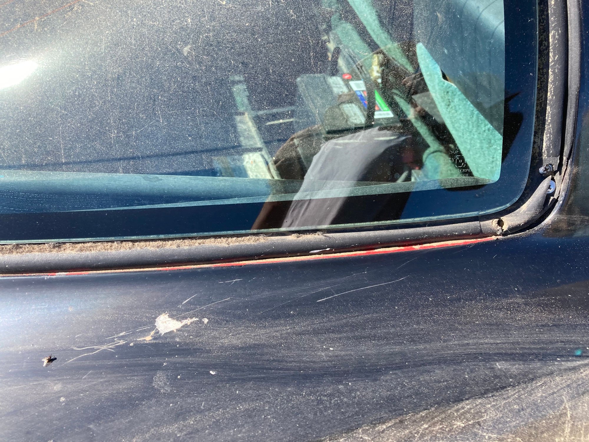

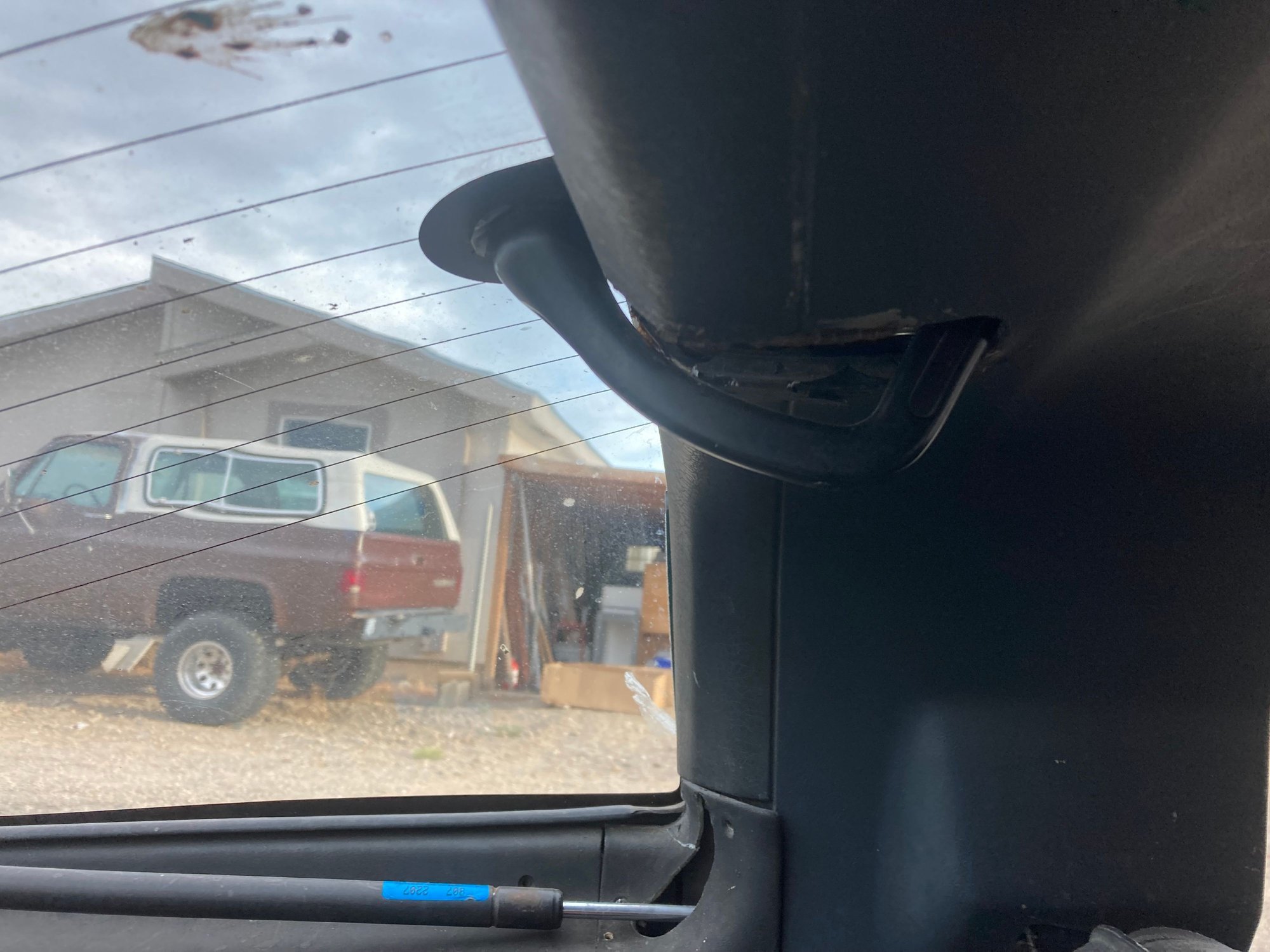

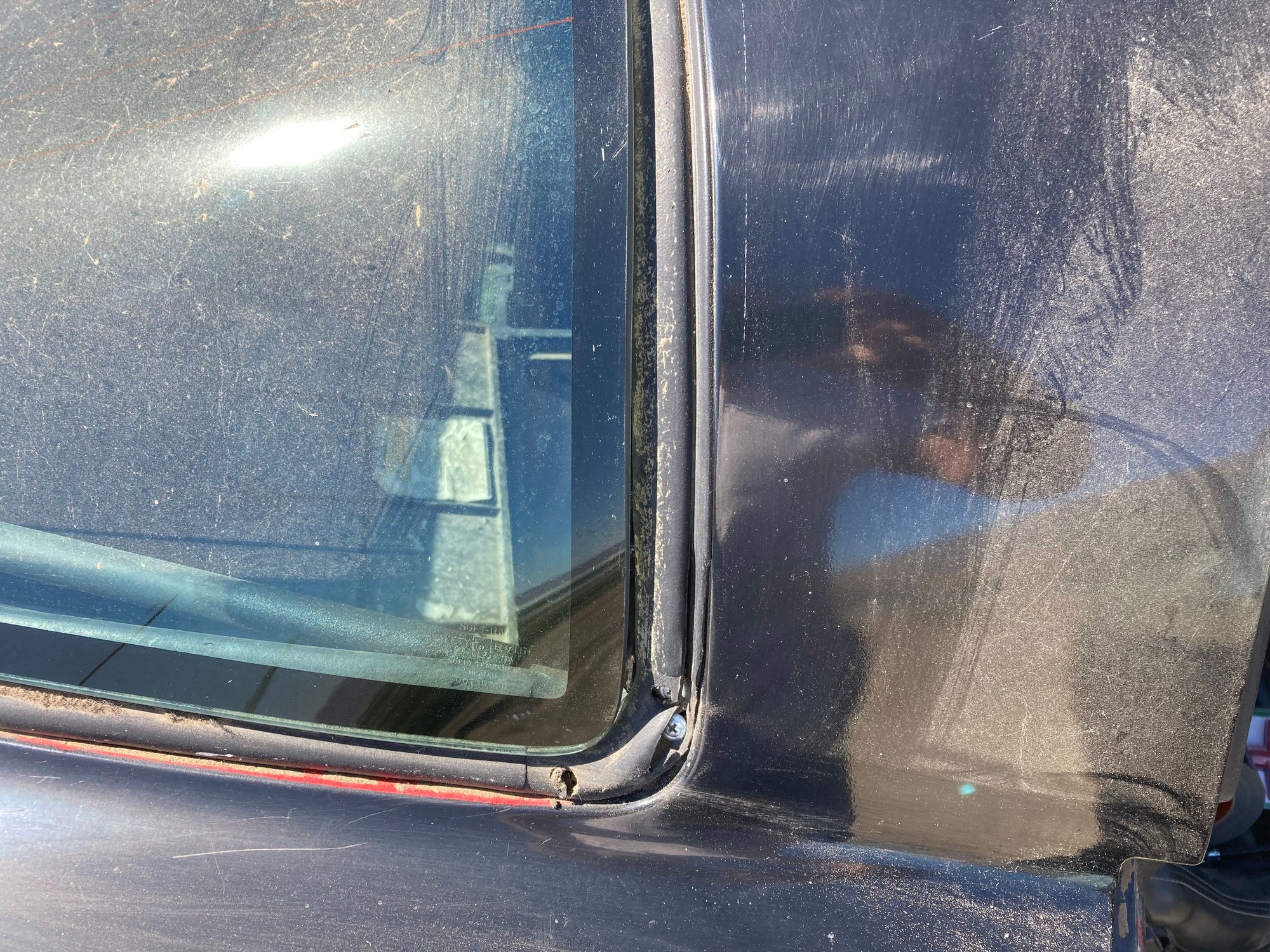

My '79/80 has an opening rear hatch. I don't know if it is an original '82CE hatch or aftermarket. At any rate, the installation was not done very well and it doesn't fit right so it leaks. I could probably spend a bunch of time adjusting it, replacing rubber seal and try to get it to fit correctly but I don't really need to have an opening hatch. A fixed window would be fine for me and I've been told the opening hatch is valuable but I have no idea what it is worth.
If it is worth a decent amount of money I'd be happy to sell it and replace with a fixed window. Anyone have aby idea what it might be worth?
Here are some photos including the release handle.

Not original for sure and you are correct...I bad job of a mod as well. 82 CE was the first year for rear hatch from GM on a C3.

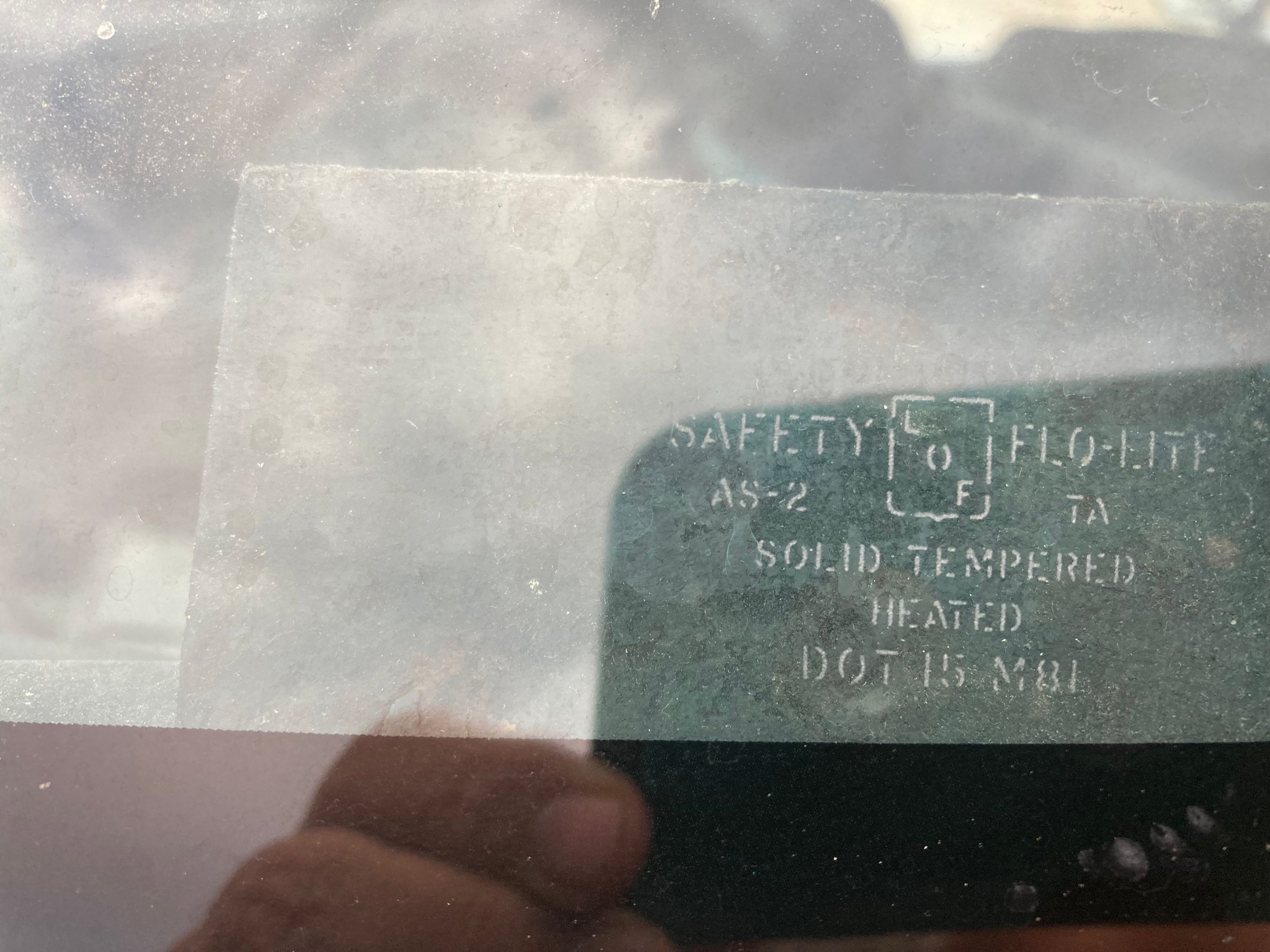

Thanks for the info! Here is the stamp on the window. It says 81 but don't know what indicates the month.
Here are hinges:

The date on the glass is the "TA", not the M81. I'm watching the grandkids right now, but I can check the codes when I get home later.

Those hinges look OE, but the install/holes look BUBBA IMO, not by a professional shop. Either way, it may be a gem to keep or sell. A vette wrecking yard would be a good bet on the fixed rear glass as mentioned. GL

I second Bucaneer on the hinges. They look just like mine. I decided a while back that if something ever happened to my rear glass, I was just going to back with a standard glass. No way I could pay thousands of bucks for a piece of glass unless it came from the Sistine Chapel.

The date code is the "TA" to the right of the LOF logo. The dare decodes as August (T) 1979 (A).
