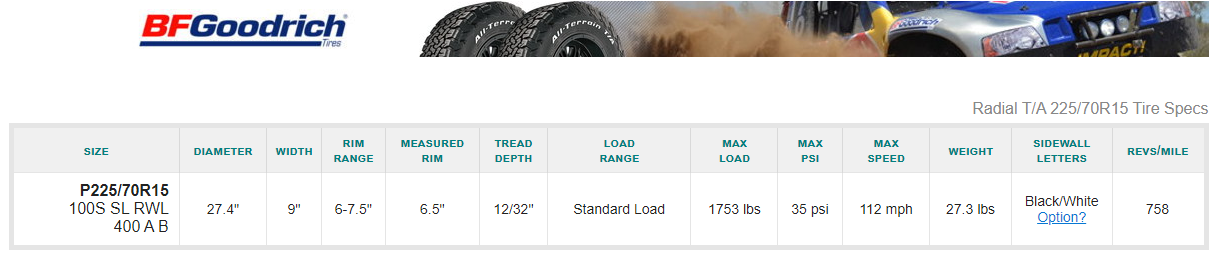

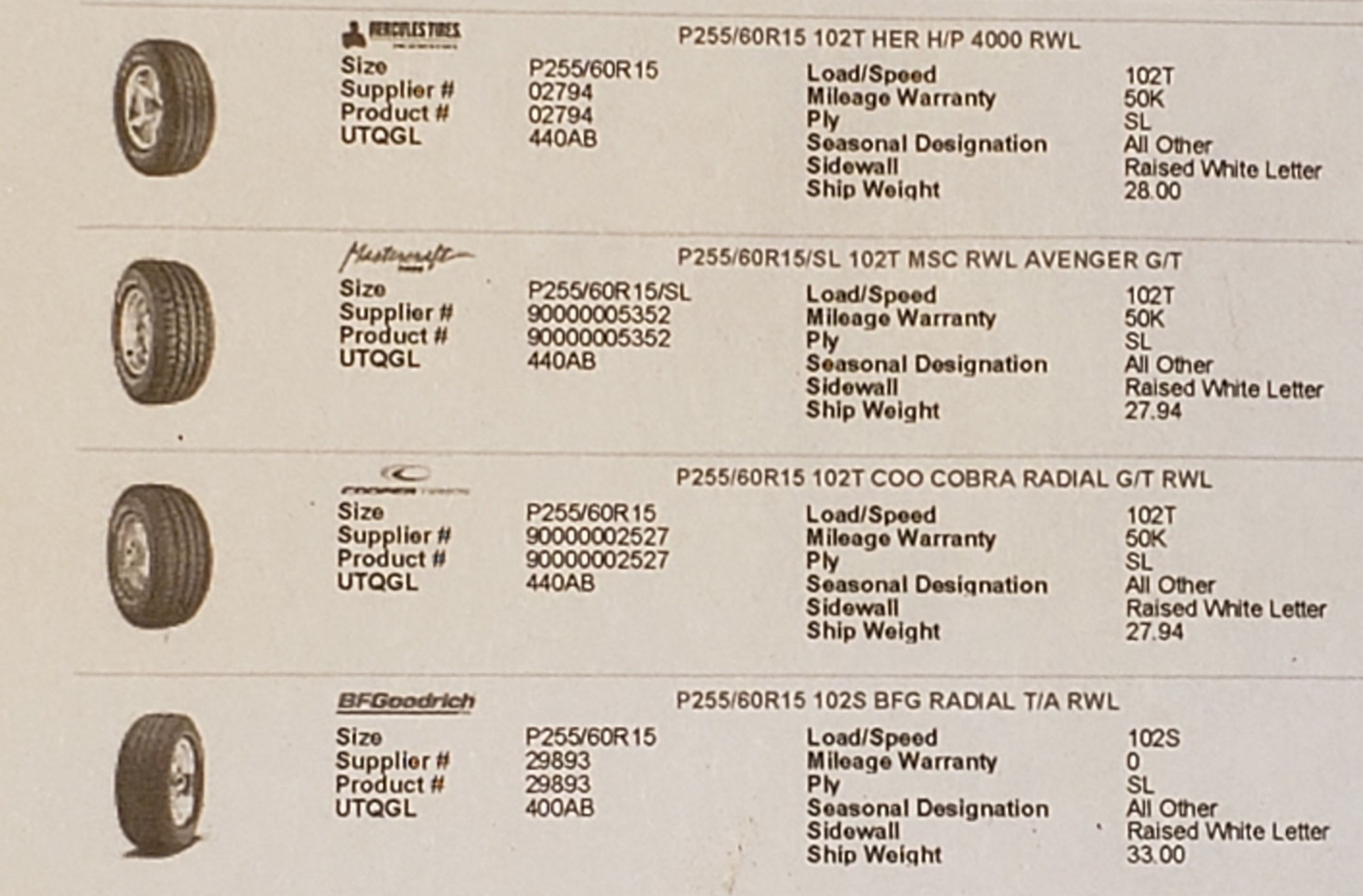

Different size,,,,,compair these,,,,,

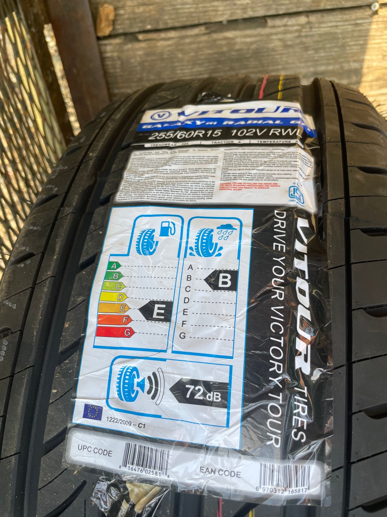

I purchased a set of Vitour Galaxy V-rated tires in 255 60 15.
They have very good reviews from my research.
Unfortunately, I’m still in the middle of my resto, so I can’t give any firsthand experience with how they handle.

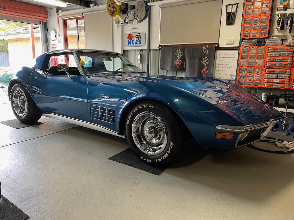

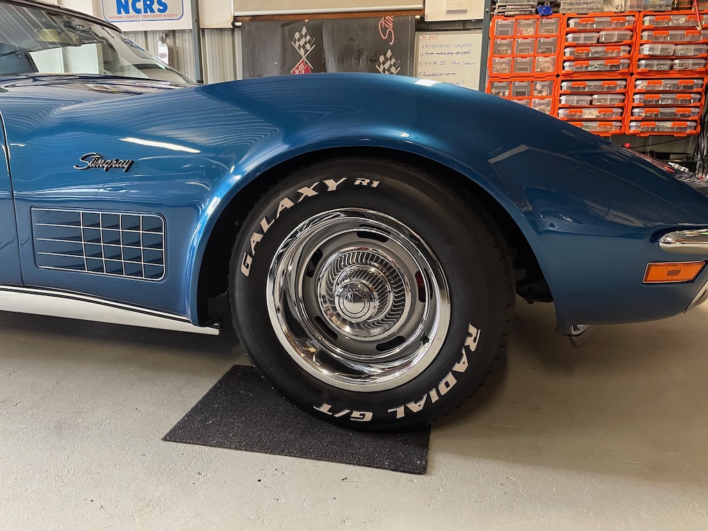

I also have a set of of Vitour Galaxy’s on my 71 (215/70r15). They drive very well and needed minimal balance weights.
I normally run 18’s but wanted a classic set as well and I am more than happy with these. Much more grippy and higher speed rating than the traditional white letter tires that have been around for years with no improvements.

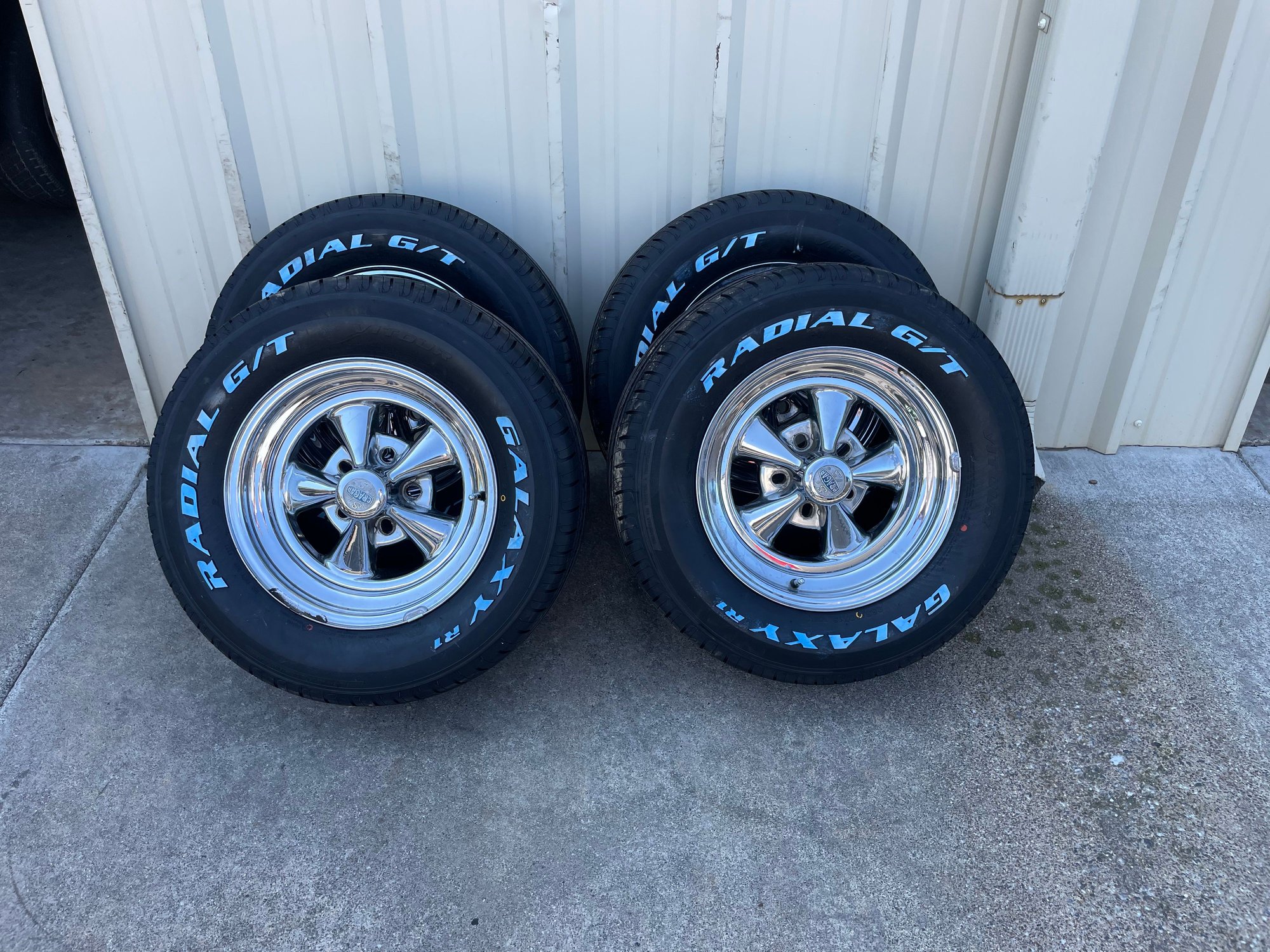

Does anyone have the same problem that the Galaxy quickly become yellowish?
I can clean them and take a ride, after which they are already yellowish again. Mine are from 2018.

Not speaking about the Galaxies in particular, but other cars I have with whitewalls or RWLs do this these days. The white areas become kind of brown. Doesn't seem to matter who the manufacturer is.
Not sure what you can do about it. Tires back in the day were easily cleaned and didn't leach like this. Of course, gasoline back in the day didn't corrode carburetors and oil back in the day didn't flatten camshafts. Oh well.

I have noticed this as well, but I wipe the letters over with adhesive remover and they are nice and white again.
It seems to last more than just one ride but it’s like the chemical process of the rubber causes the change way more than years ago.
It seems that all the current white letter tyre brands have this sort of issue to some degree.

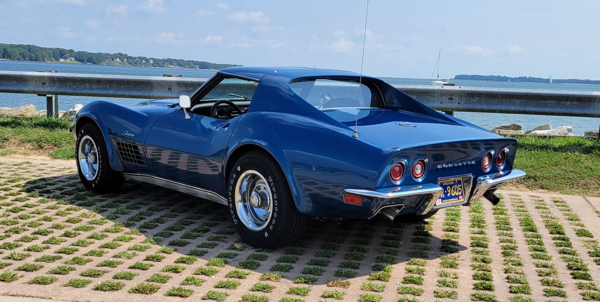

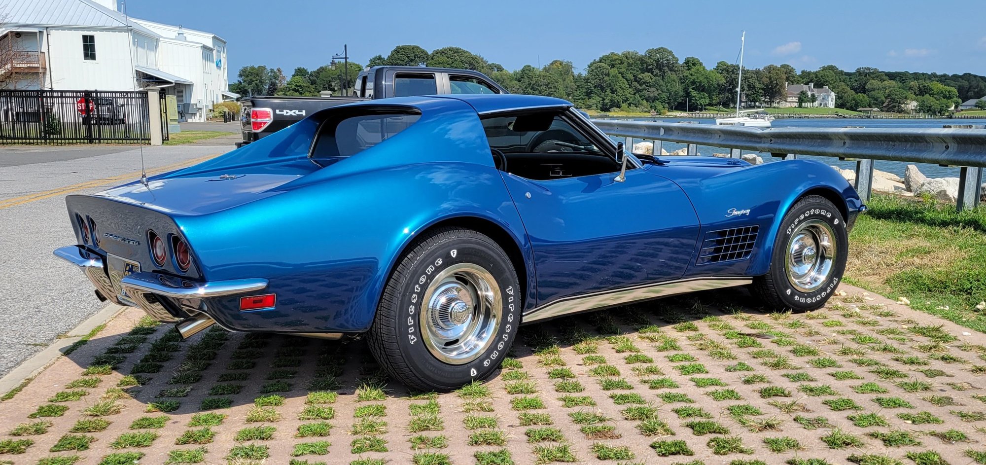

Well, I did it. Went with the Destination LE3s. No complaints. They are smooth, quiet, look good, and handling is crisp. Not bad for a 'truck tire'. Nobody is gonna confuse em for Pirelli P Zeros but no 15" tire is gonna do that. It's a solid alternative for those of us that want to stick with OEM size white letter tires.
