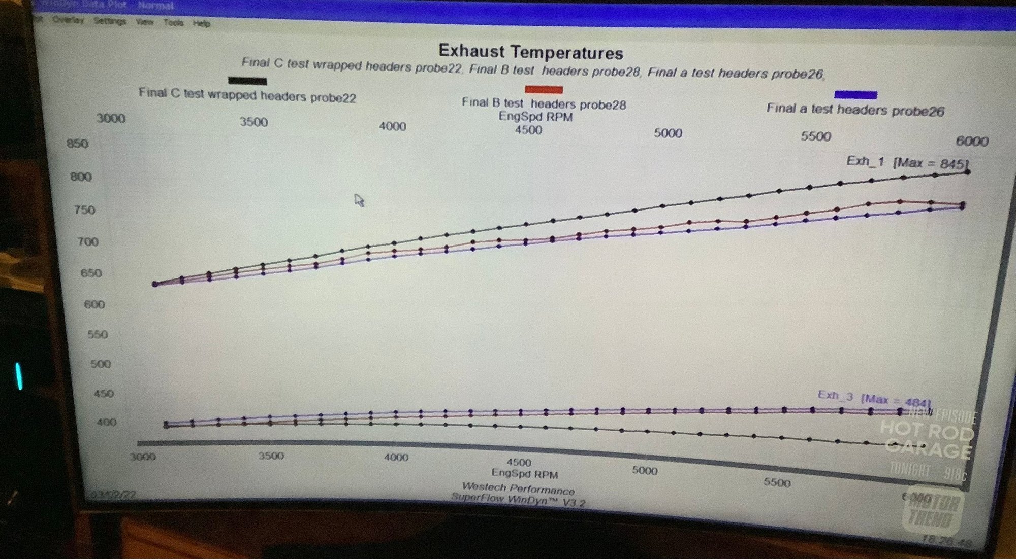

Finally!,!!
in the never ending heat solutions for some on the c3..
a real thermocouple comparison (not ir gun due to emmisivity differences) which includes
painted, ceramic, and heat wrap
I always thought strange all the advertisements never did side by side comparisons with a thermocouple…
I always thought bs on all the adds with ceramic and reality vs perceptions..
ceramic gets you barely 10f degrees difference on outside
the wrap 59f
and mainly at higher rpm.
also internal egt corresponding inversely to outside temp.
great episode..
also bs on increasing hp with hotter exhaust gas temps.
no wonder oem uses heat shields.

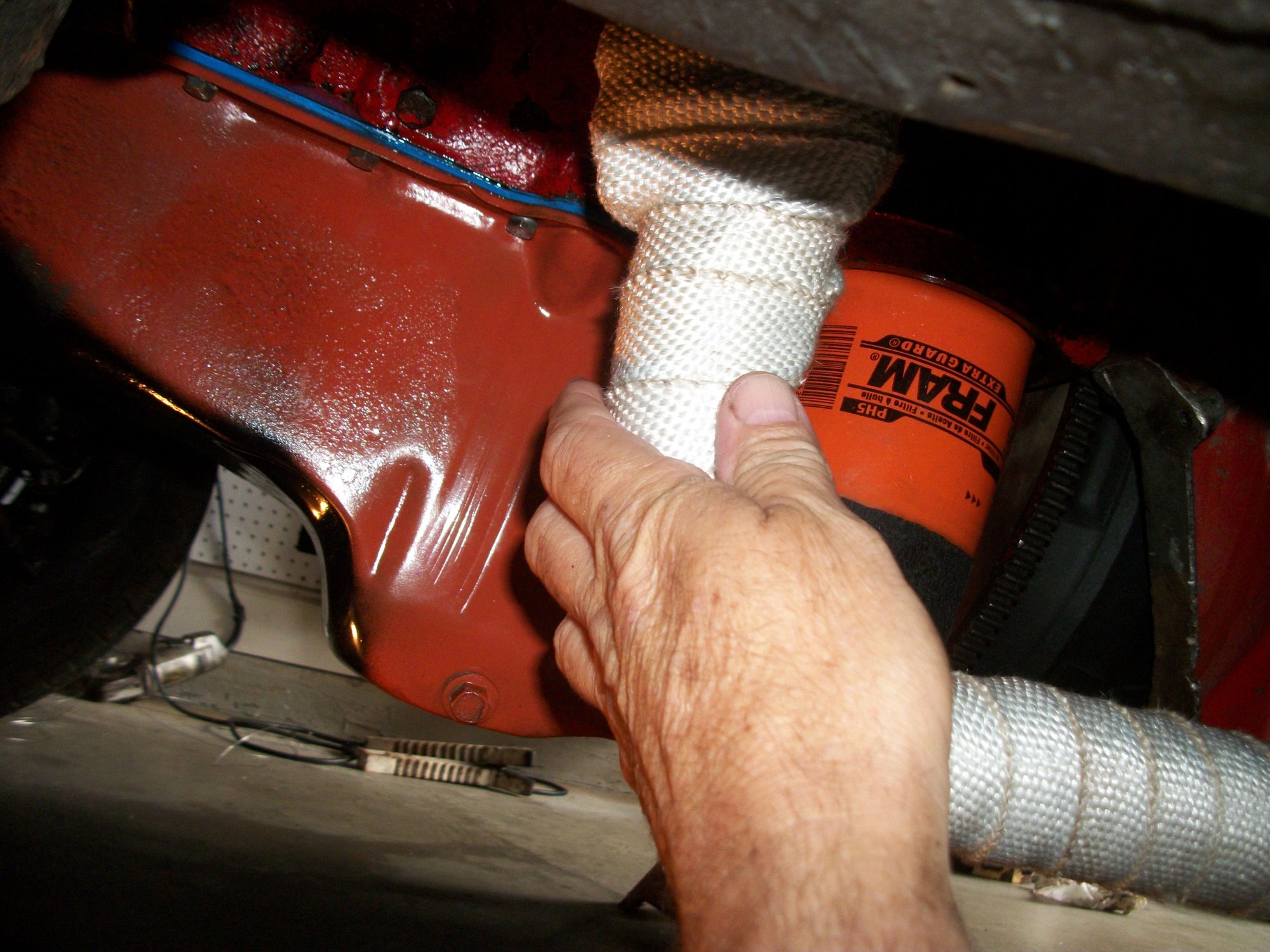

Finger-Tip Test:
On the other hand...I wrapped the black stuff around one of my headers and at operating temp.
I COULD HOLD THE HEADER for 30 seconds before letting go

OE use heat shields cuz the longer the exhaust stays hot the more complete it burns off the HC's. especially before the converters. they only care about emissions. but at least they figured out more efficient is less wasted unburned HC and CO and learned how to make powerful engines that run pretty clean.

When the wraps get wet the pipes rust fast.

I think the reality is, no coating will make that much of a difference and an air gap aka heat shield/ wrap, are the best defense including contaning radiant heat.
i think even modern exhaust does not try to keep heat in the pipe, just mitigate wherever needed.
of course high heat coatings protect, decorate etc..and some performance but the heat claims were always nebulous in all the sites.
again hats off to EM.
would love to know what cast iron does
My street rod was a daily driver...five years later I removed the wrap to install better wrap....there wasn't a rust spot on the exhaust pipes or headers. Daily driver and wrap work well in evaporating the rain water.

I know it's kind of an added expense, but what if you wrapped ceramic coated headers?
In theory, wouldn't that stop, or slow down the rusting process? I had my headers coated from Jet-Glo.
I haven't run my engine yet (hopefully soon), so I don't know how hot they will get.
I saw that episode and was surprised by the results.
