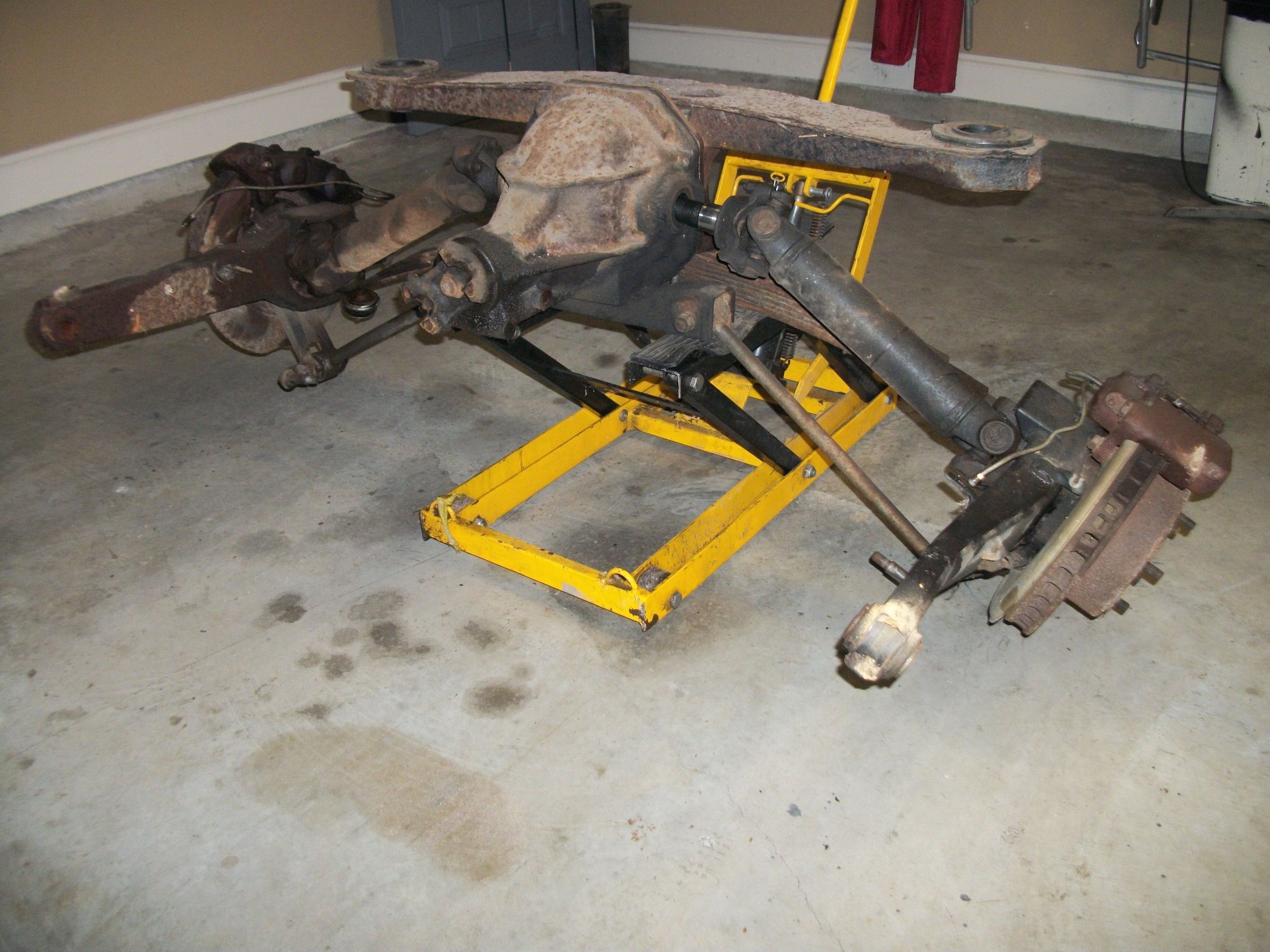

interpon's Avatar
interpon
Joined: Jun 2019
Posts: 7,658
Likes: 2,470
From: Indiana
op
post some pics of your rear suspension as mentioned in previous posts, especially where the bushings are INCLUDING the trailing arm bushing that are new..
they could be bad even though newer or even chinesium poly replacements.. hard to know history..

Old Sep 6, 2022 | 07:50 PM
C3Raybe's Avatar
C3Raybe
Cruising
Joined: Aug 2022
Posts: 13
From: Plains,Pa
