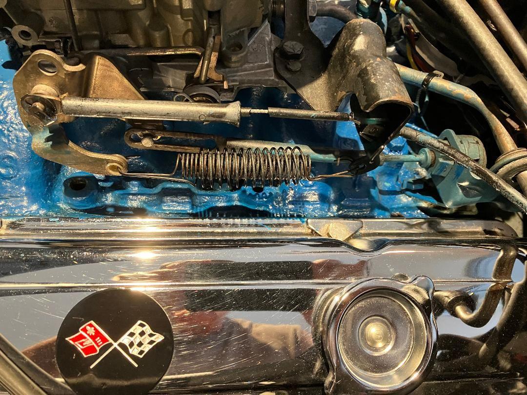

These are factory springs in the correct place, for a '76 anyway. Chrome added...
STA70972

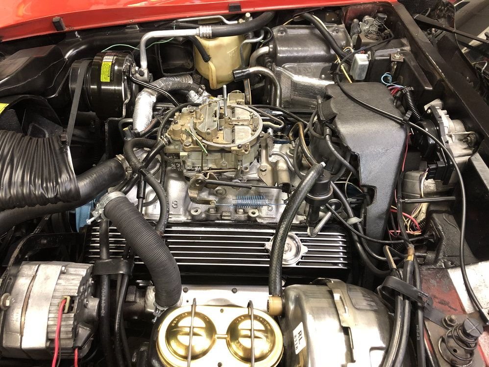

And a 79 stock.. no clue why one is blue
