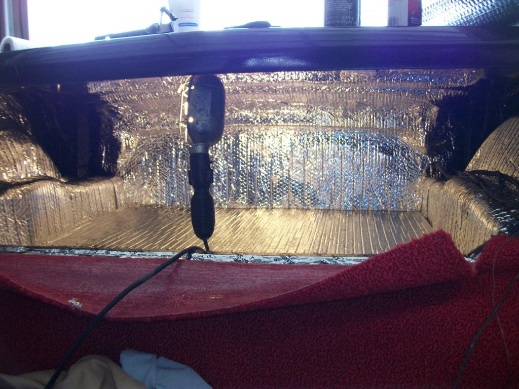

Compromise:
Dynamat for sound.
Exhaust and underbelly wrap for heat source.
Home Depot for outstanding reduction of interior heat.
Result.....98% decrease of Interior heat

Originally Posted by doorgunner
Compromise:
Dynamat for sound.
yeah, but you are gonna be abducted by spacemen wrapped in foil like that!
