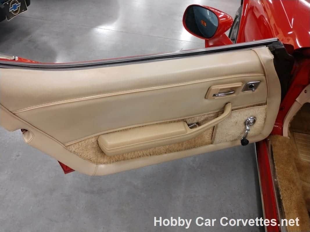

Can anyone help with a pic of a finished driver side door panel. Replacing panels and have no idea where everything goes, especially the mirror control.

Old Sep 13, 2022 | 08:51 AM
LowSporty's Avatar
LowSporty
Joined: Dec 2020
Posts: 246
Likes: 165
Here 'ya Go!

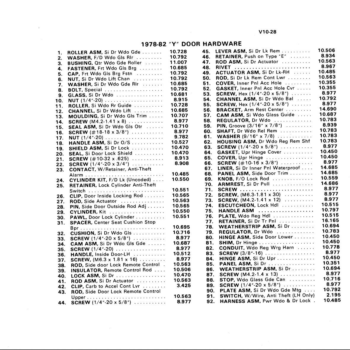

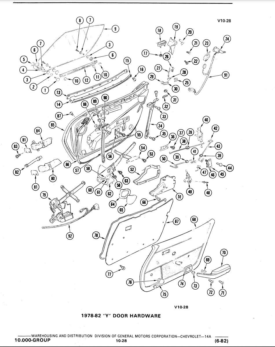

Old Sep 13, 2022 | 09:07 AM
interpon's Avatar
interpon
Joined: Jun 2019
Posts: 7,649
Likes: 2,466
From: Indiana
strongly recommend post #8 and get the parts manual
https://www.corvetteforum.com/forums...ette-lonk.html
note my 79 has 78 positioning of door locks but moved later on. Early build.
