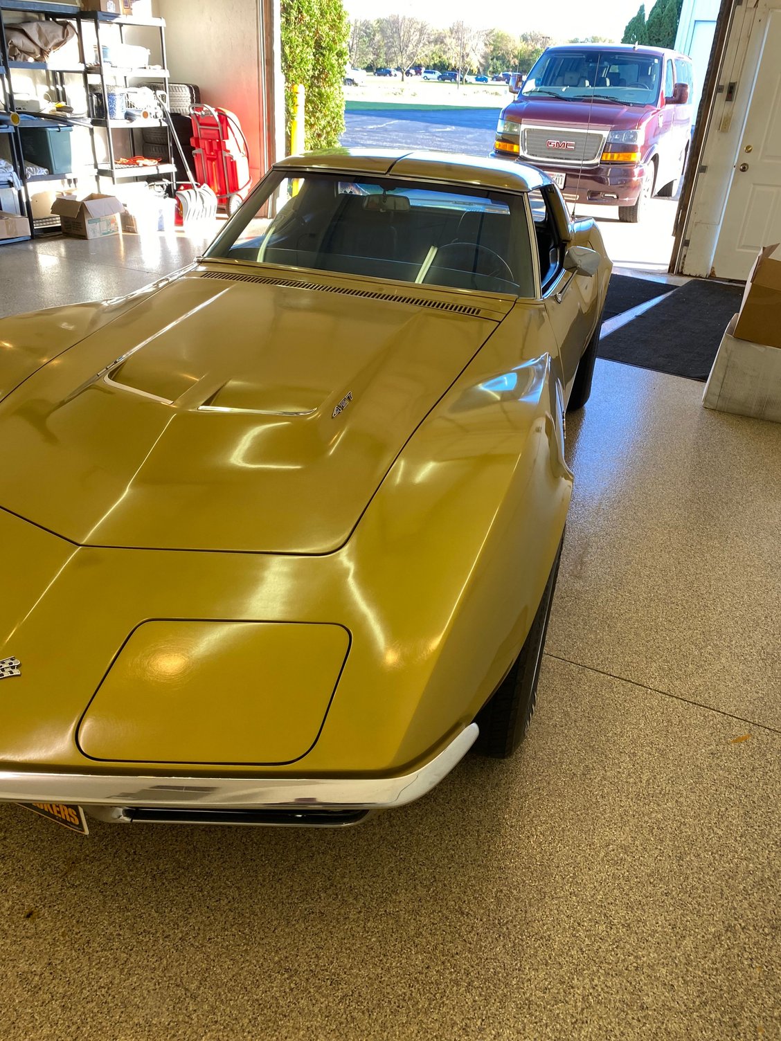

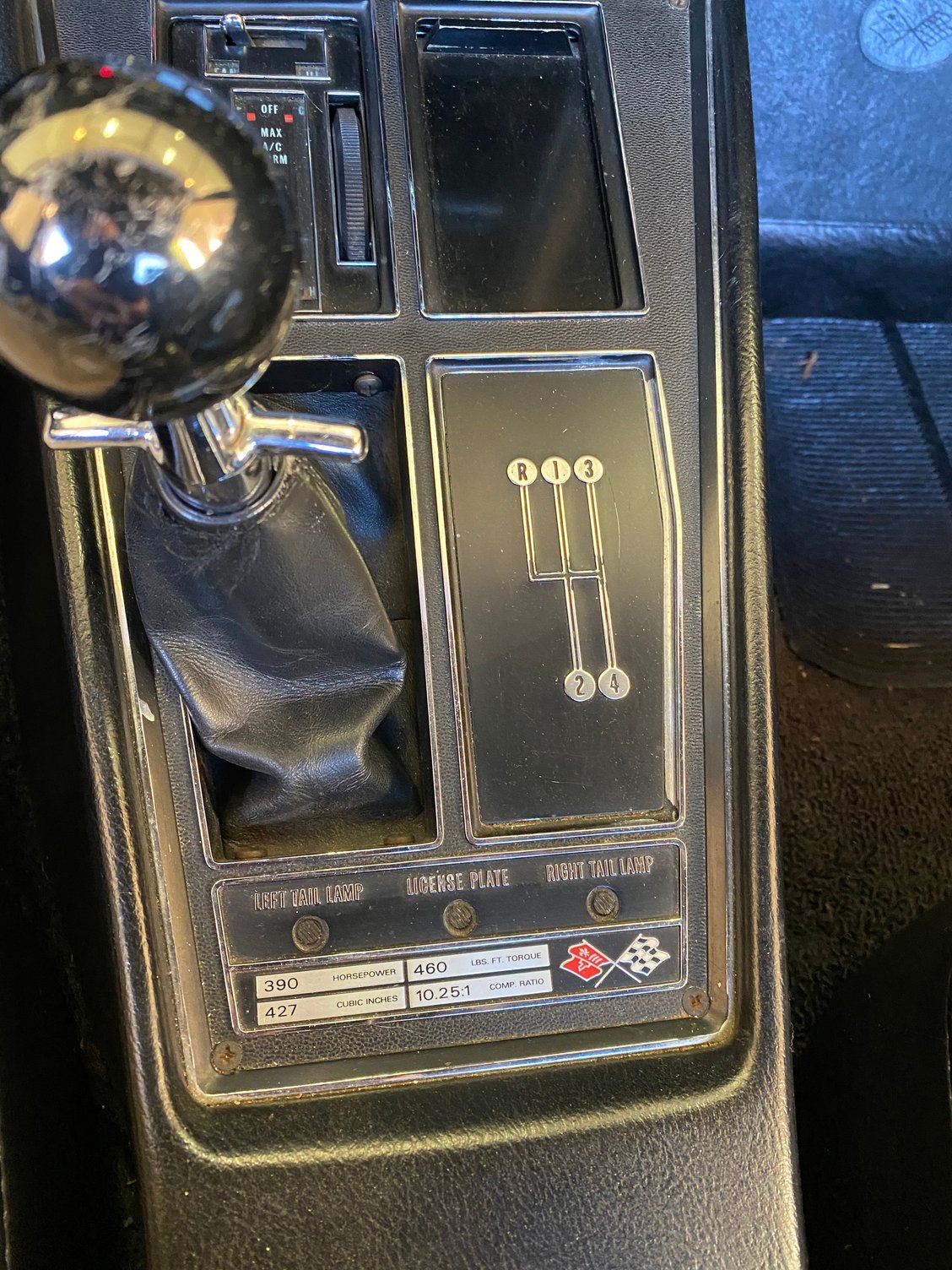

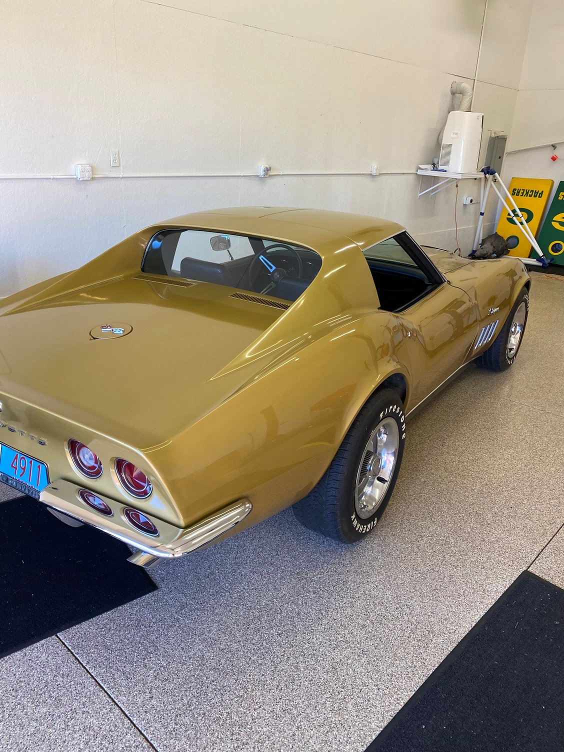

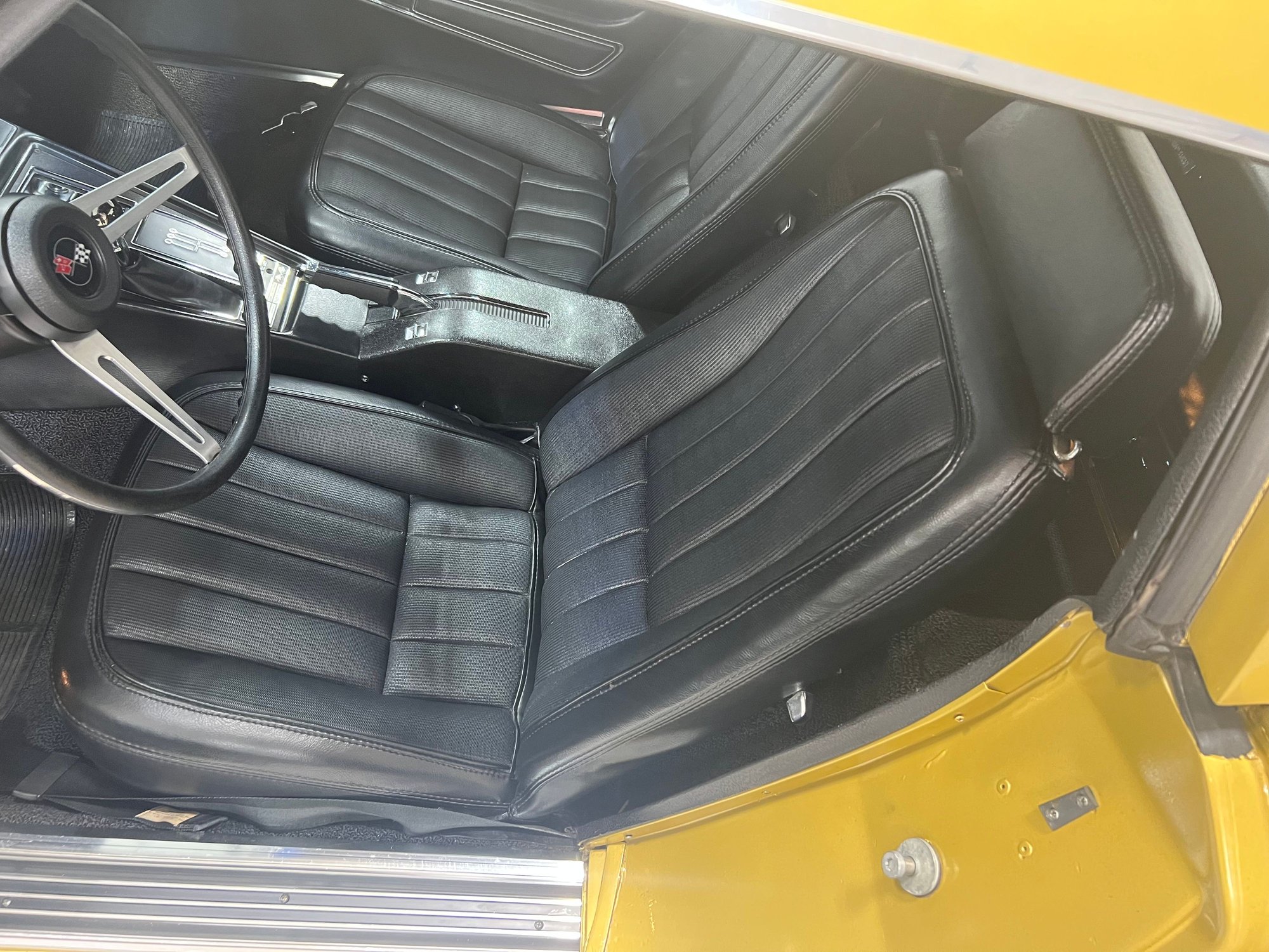

The shifter boot has been changed to a leather one it should have a rubber one ( leather started in 1970)
Headrests have been changed they should not have stiching around the edge

It sure looks worth pursuing based on the pictures. Few if any 50+ year old Corvettes are 100% original any longer. I like where it is housed as well as its garage mate, all indications it is/was owned by someone that had the means to properly maintain it. Just my 2 cents.

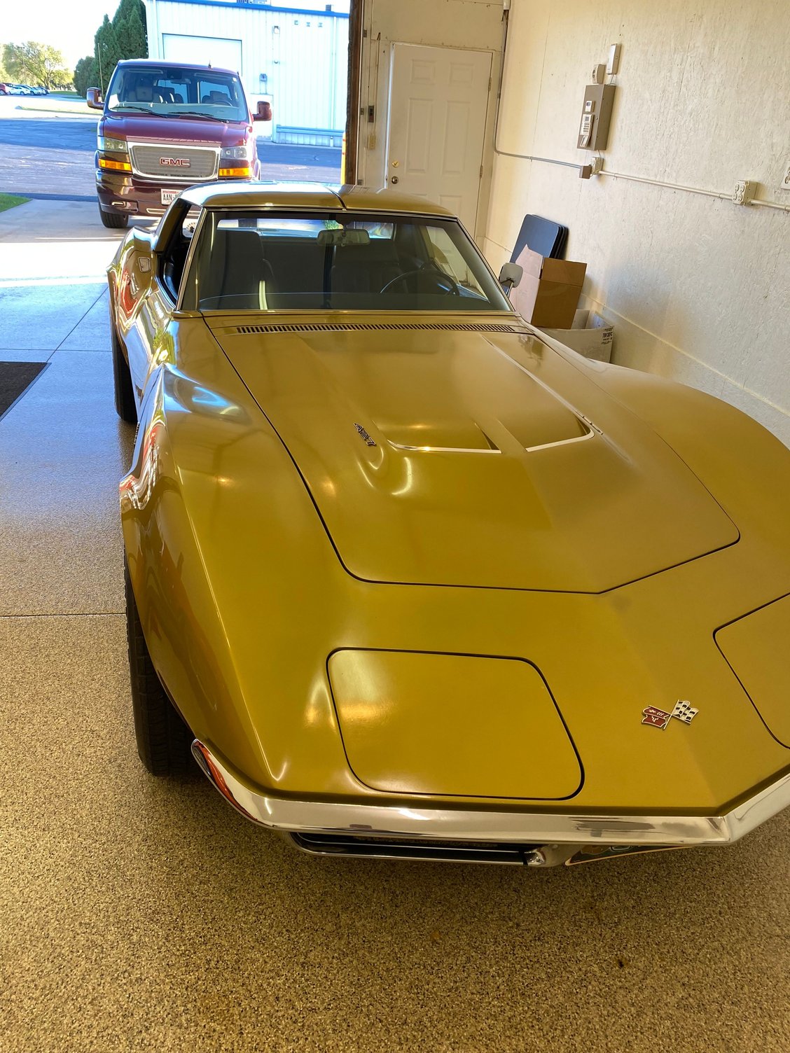

I'd like to see a better pic showcasing the "bumps" between the headlights and the hood. I've never seen an "untouched" 69 without them.

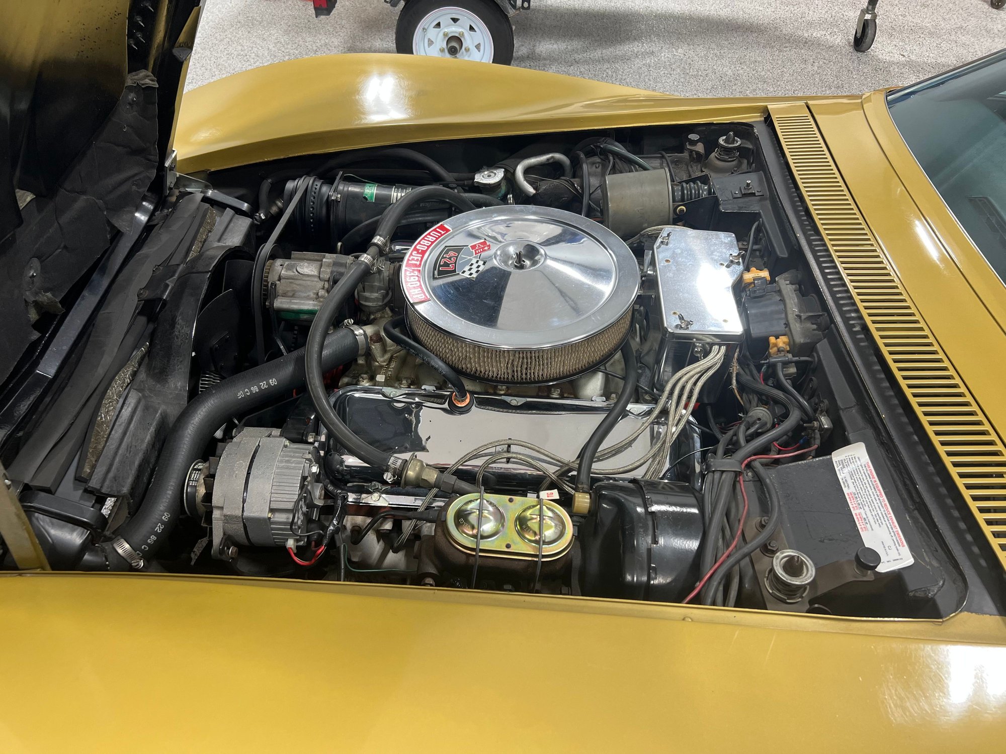

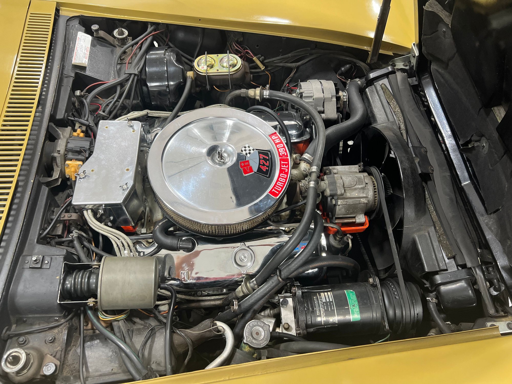

“Reliable” and a 53 year old Corvette are, generally speaking, mutually exclusive terms, particularly when you state that’s you don’t want the car in the shop all the time. If you want to wade into these waters, you need to accept the fact that there will always be the threat of something going off-song. Is is possible to not experience any issues week after week after week? Of course it is, but the chances of that happening are not good.
Look hard at the picture of the engine compartment. It is a minefield of potential problems, visible and not. For many of us who have owned these cars for years (I’ve had mine for 50 (yes 50)), it’s not an issue because we’ve probably touched every component and know how they work and how they fail. Now add in the rest of the drivetrain, steering, suspension, electrical, vacuum, etc., etc. So many potential areas to go wrong.

There is evidence the car has had a repaint.

As Chip Foose says "It's the paint that'lll draw you in." New paint is what gets the oohs and the aahs at the car show. I have spent twice the amount that I paid for my car 18 yrs ago and have never had my still original paint car in the shop. Do I trust it to get me home when I go for a ride? Not really.

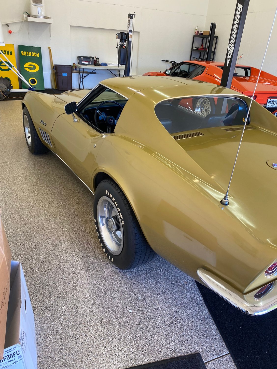

I dont know much about Corvettes but if I showed up to buy a car and a garage looked that clean and organized with what looks to be a de-humidifier and an air conditioner mounted on the wall it would sure make me more optimistic about the condition of things stored there.

I think this is generally true with greater emphasis on foam components breaking down over time due to the instability of the materials. It also depends on what the soft parts are environmentally exposed to. Rubber fuel lines are a common item that should be changed because of the chemicals running through them. Rubber brake hoses likewise. Wiring is usually OK but heat can make the insulation brittle on wiring in the immediate vicinity of the engine, trans, and exhausts. Rubber weatherstripping breaks down due to UV sun exposure but if garaged it can have a very long life. Vinyl dash and door panels likewise.

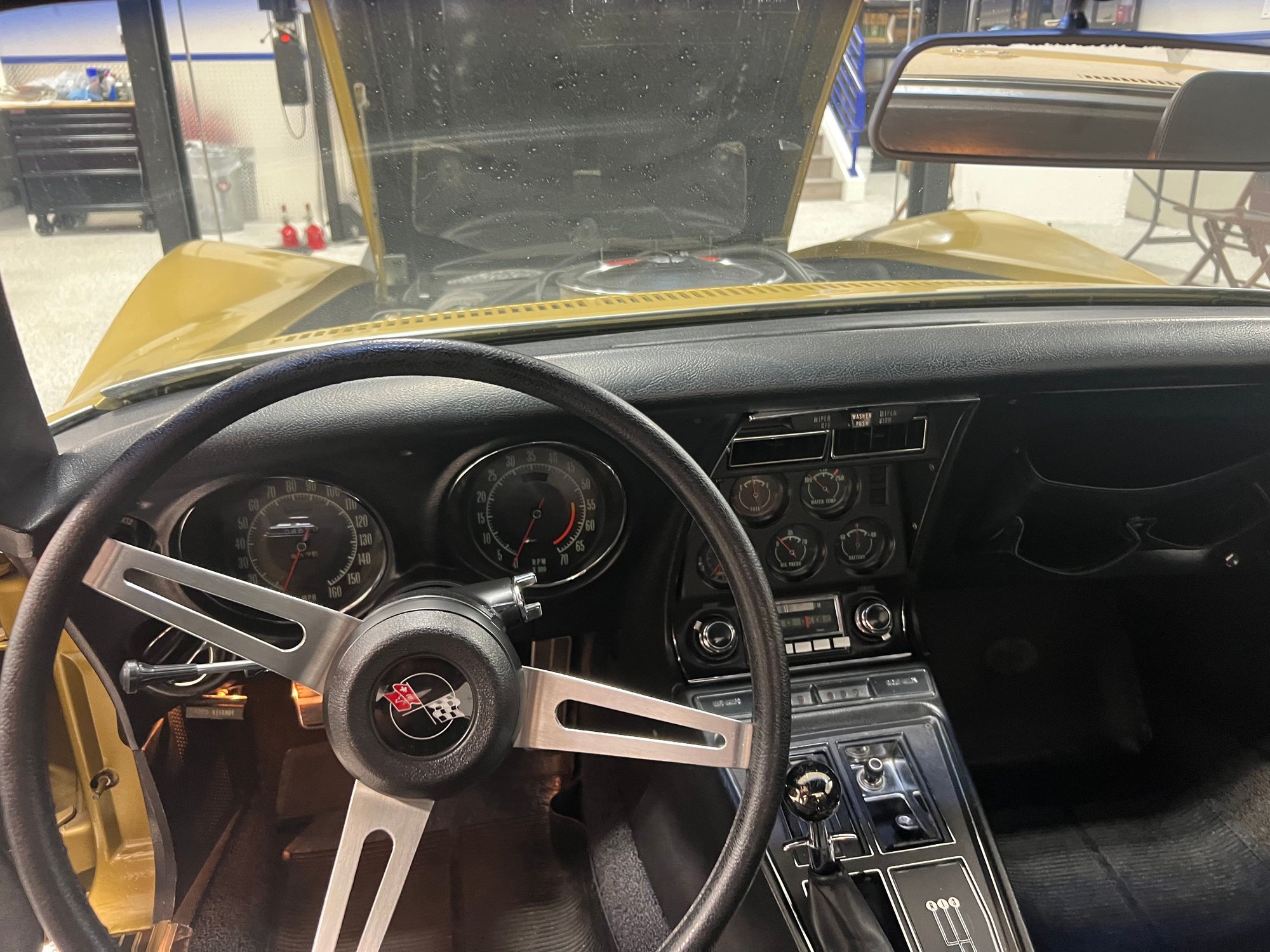

The seats in this one look good with "puffy" panels between the stitching, so either the foam has been replaced already or the originals are in excellent condition. Original seat foam turns to yellow powder, so if there's not much evidence of that under the seats, there's nothing to worry about there.
Looks like a solid, original car from up top. The 427/390 is a joy to drive and own – not as finicky and complicated as a tri-power setup but a lot of oomph to it. It's no slouch. Love my '67 390!
