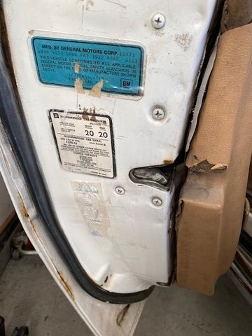

Pretty cool to see the stickers on the side of the door.

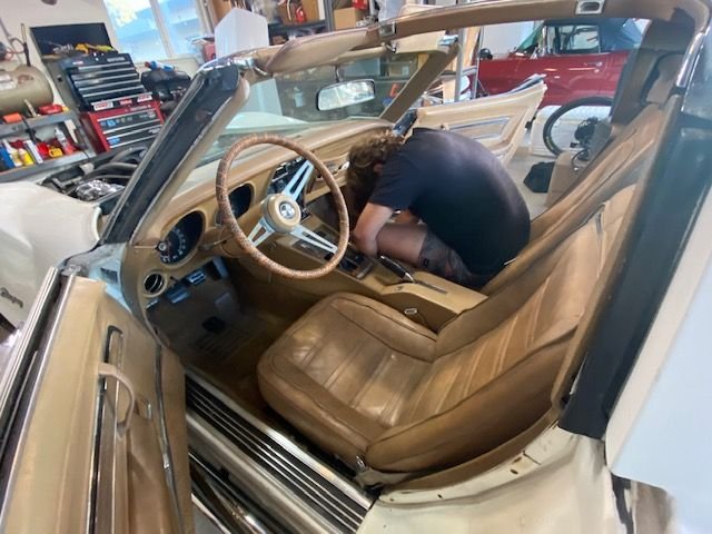

My son installing the seats. We will have to get the seats redone at some point. For now, he took the passenger side and installed it onto the driver side. Plus. we have to paint the rear back of the seats.

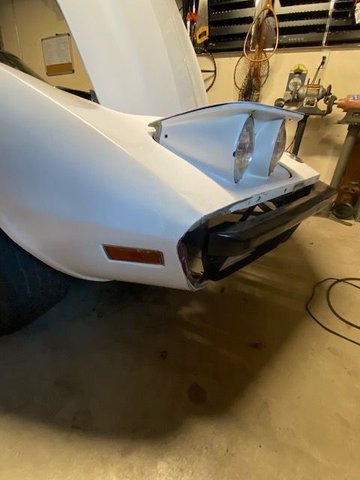

Lights are working! The relay on the driver side needed to be replaced. Now, the lights go up and down on both sides.

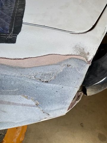

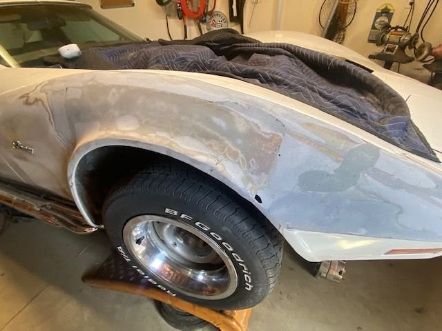

He can drive it primered up for now. Same thing has to happen to the rear bumper. There is one crack but its all there to make fix it.

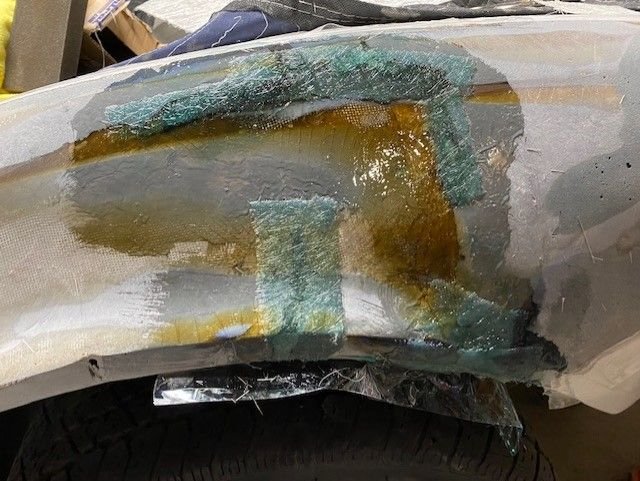

More glasswork:
I can work on it for a day then let it dry with a heat lamp then sand and add more glass the following day or a couple of days later. Slow work but its getting there.
