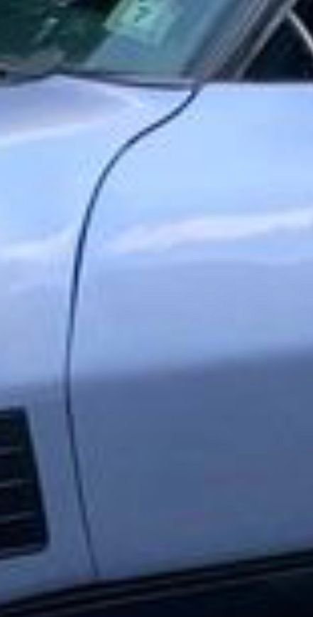

There is a 1970 that I’m looking to buy. All the gaps in the car look fine except for the two main doors which have a bit of a weird gap. Does that look like a something concerning?

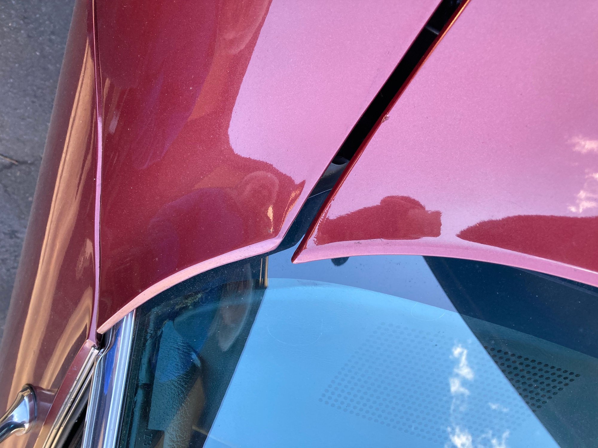

Rookie guess: the chrome trim along the rear edge of the hood is missing. When installed it makes the hood rear edge appear to be level with the top of the door edges. You can barely see the chrome trim in the pic below........

Other than the trim. If your wondering about the vertical gap. None of them are perfect. These are hand assembled fibreglass cars. The fit and finish was awful. Some cars are better than others, but what I see looks pretty normal.

fit and finish from the factory were horrible. They were assembled by hand and sent down the line. Your gaps look normal for the time period. My 1 owner car was never hit and hood gap looks like this . I would be cautious if all the gaps were perfect.. hope that helps

The gaps you show are of minimal concern. C3s have heavy doors, especially after the steel crash bar was designed in after '73 (?) - their long length and cantilever effect exacerbates the issue. The weight wears on the hinge pins and bearing sleeves. This car may be merely showing the wear in the upper hinge. The way to check is to open the door to various degrees and lift up; a worn hinge pin/sleeve will have movement that you can feel (and it's possible you may hear a clunking sound – though these don't look that sloppy). Replacing the pin and sleeve is pretty easy and quite inexpensive.

the trim is there but was painted black smh. I intent to remove all the black paint and go back to the chrome.
