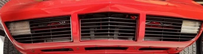

I like the metal grill a lot better than the 75 grill plus the center insert. Is it possible to use all 3 grill sections from a 74 on a 75?

I believe the outer grills are interchangeable, but isn't the center section "solid" on a '75 (no grill opening behind licence plate)

Pretty sure the outer grilles might work, but the 75 and later front bumper is completely different in the center plate area,than the 73-74. The 75 bumper has the license plate area molded into the cover. The center space is open on the 73-74 bumper.
Tooch
73-74 front bumper & grille area
75 front bumper center plate area
