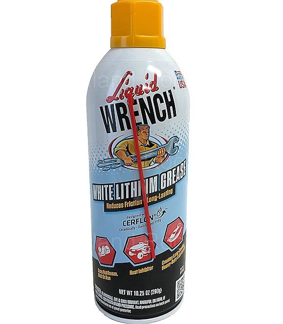

I use Lithium Grease on all my door locks on all my vehicles. Keeps them working nice and smooth. Works well for door hinges, trunks, and hoods also.

White lithium grease will work good for the linkages, but probably won't 'penetrate' into the deeper inner mechanisms of the latch where you have sliding and moving parts. You can try, if it doesn't do much, hit them with some WD40 or any penetrating fluid. The best would be to remove and soak the latches in like diesel or gasoline or a non-caustic parts cleaner, and brush all the old grease and dirt off. Then re-grease (then white lithium would be a good idea). But if the lock lever works better after just greasing or WD40-ing ...then you bought yourself a little time

White lithium grease is what I use on rod ends and such.
A good speay lubricant with Teflon in it or simular for locks and latches. WD 40 is little more than Kerosene in a can. It can help to free things and clean things. But drys away quickly and would be of no long term use.
