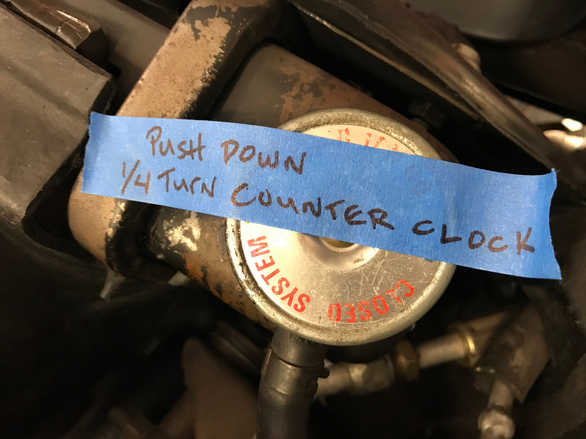

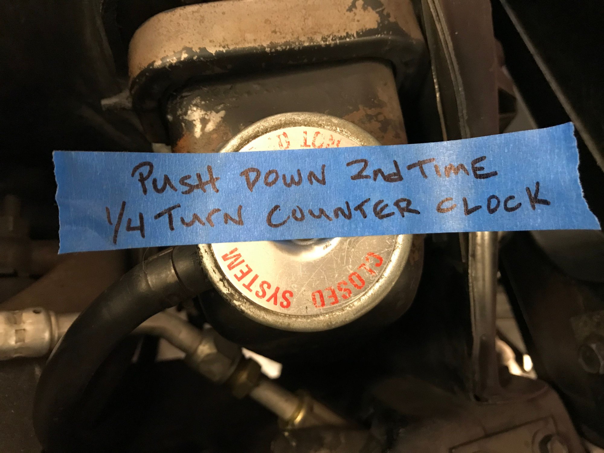

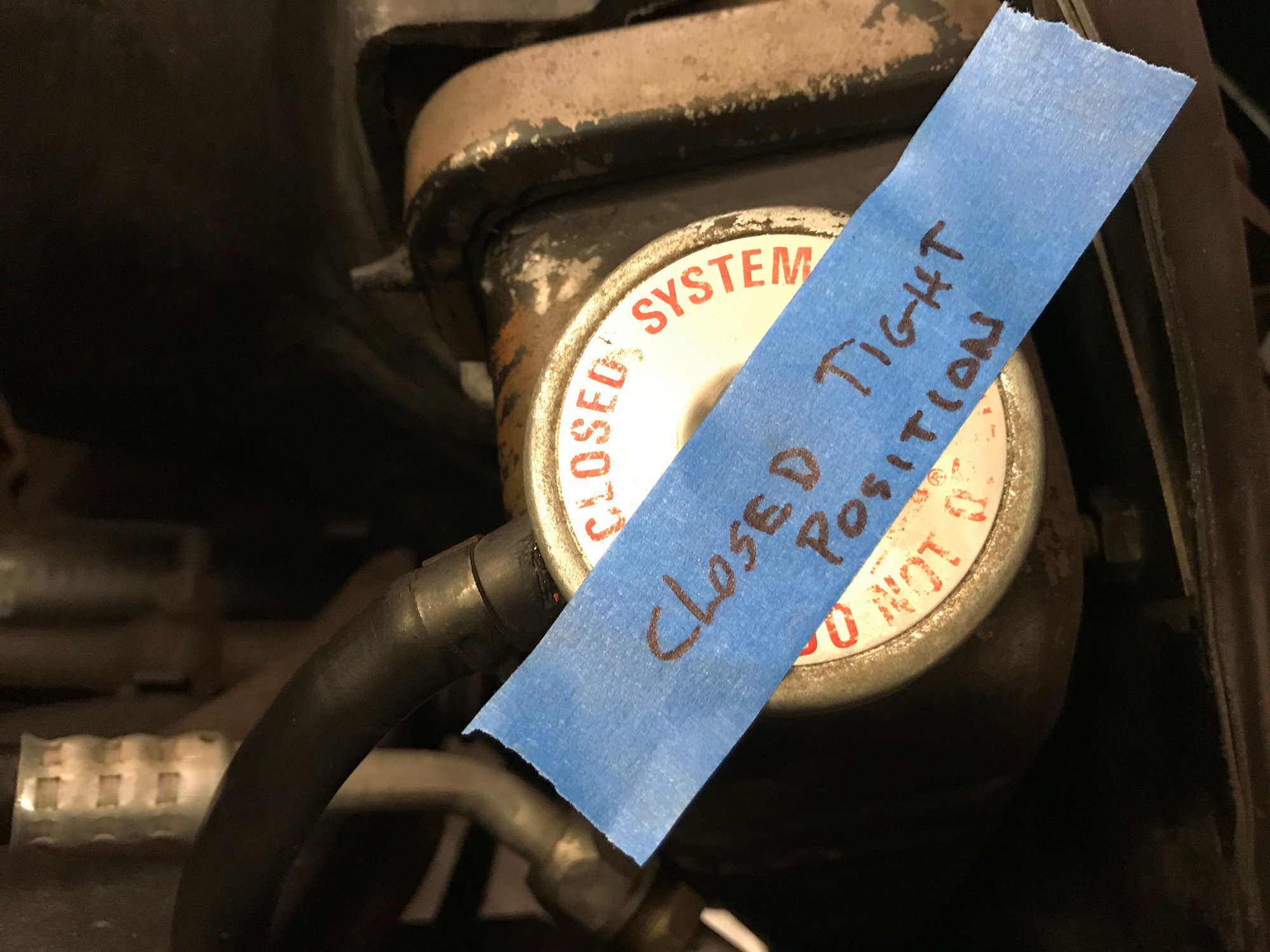

After having driven cars for about 60 years now, I figger I would have a pretty decent idea on how to remove a conventional radiator cap. NOT SO on this C3 of mine. I can twist it to its initial "pressure bleed off" position.....but from there, nothing...no matter how much I pull on it, push on it, twist it...that cap will go no further.
So after y'all quit giggling, someone please educate me as to the proper procedure in removing the radiator cap from my '79 C3.
I even tried some channel locks on it, to no avail....was afraid of actually breaking something. All I can do is twist it BACK to its "locked" position.

Go to where it stops, then push down harder and twist off?

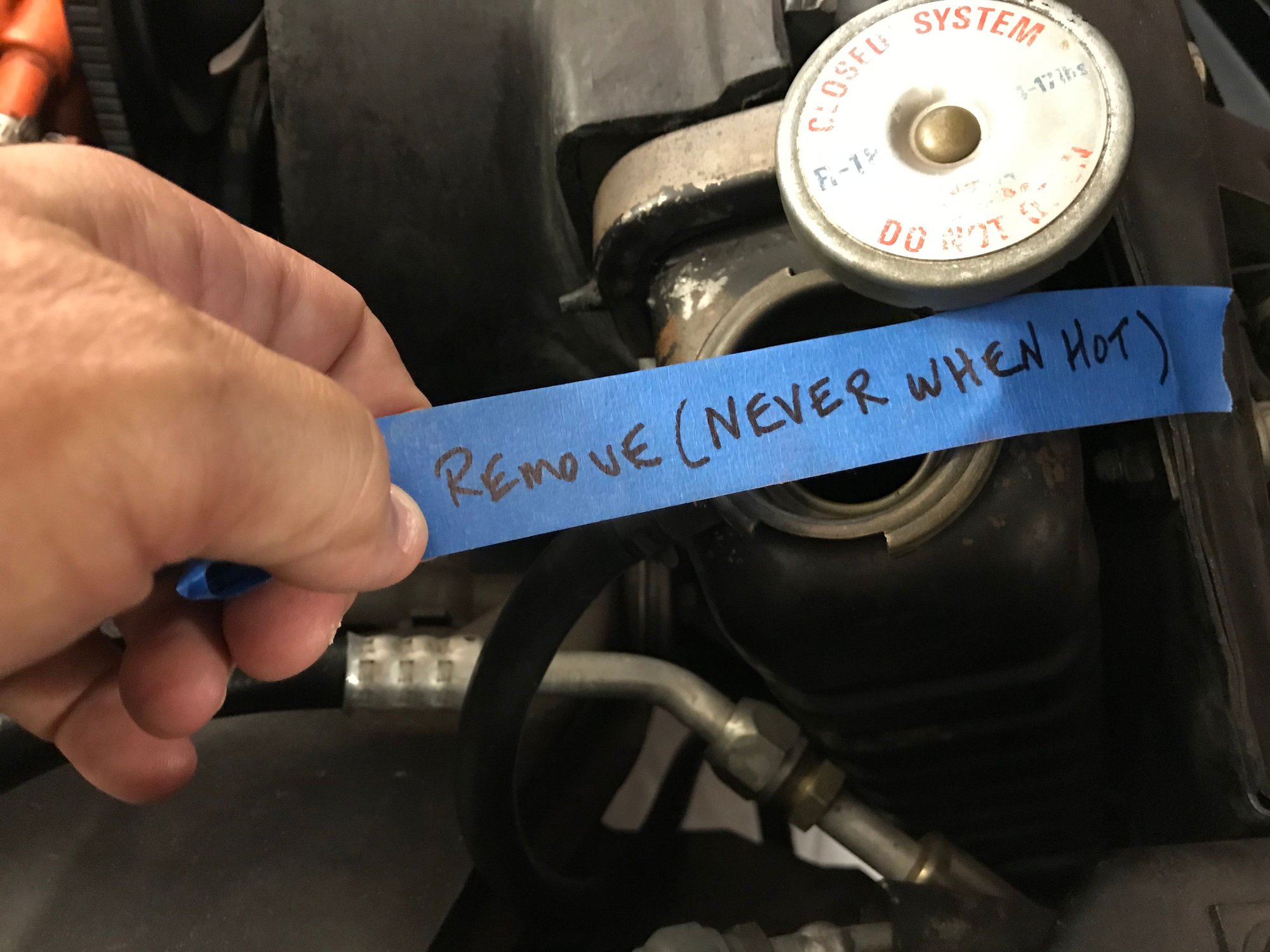

the cap does that so if it was full of hot stuff that it doesn’t fly off par boiling people.
try this. Place open palm on closed cap. Twist at wrist. You will feel first keepers come loose. Then push down a little harder and turn some more. About 90 degrees. Cap should be able to be wobbled off.
good luck.

The extra "step" just before that cap can come off was put there so the cap wouldn't just blow right off if it was loosened while still under pressure.
I've had some caps that were almost impossible to push down to get that second step and others that weren't too bad. Currently I use a red lever stant cap which is a little easier, partly because it's on the remote tank right tight to the fender lip. I believe some of the problem is that you can get the cap crooked there fairly easy with one side starting over the step and the other gets wedged into the side of the other one
You can use a pair of needle nose pliers and twist the leading ends of the two lips on the underside of the cap out (down) a little to provide a "ramp" to help get the cap started up over the last bit. That way you don't have to push it down quite as far to get it started and as you turn the cap it helps pull it the rest of the way
