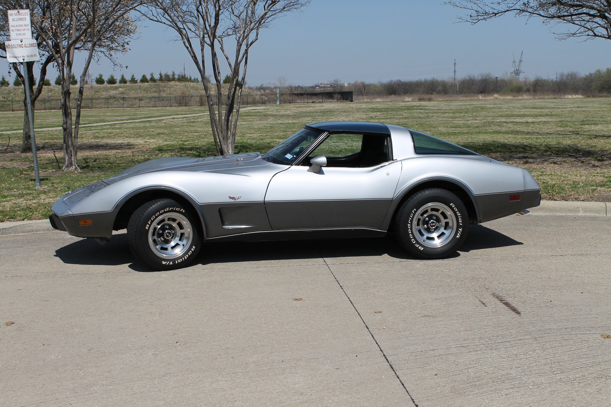

I used the Ecklers Gel Coat when I painted my 78 in 91. I removed all of the old paint using their stripper then shot the Gel Coat to "seal" the suface from the fiberglass fibers from showing through after painting. I did sand the gel coat befor the final primer/paint.
Still looking good today.
