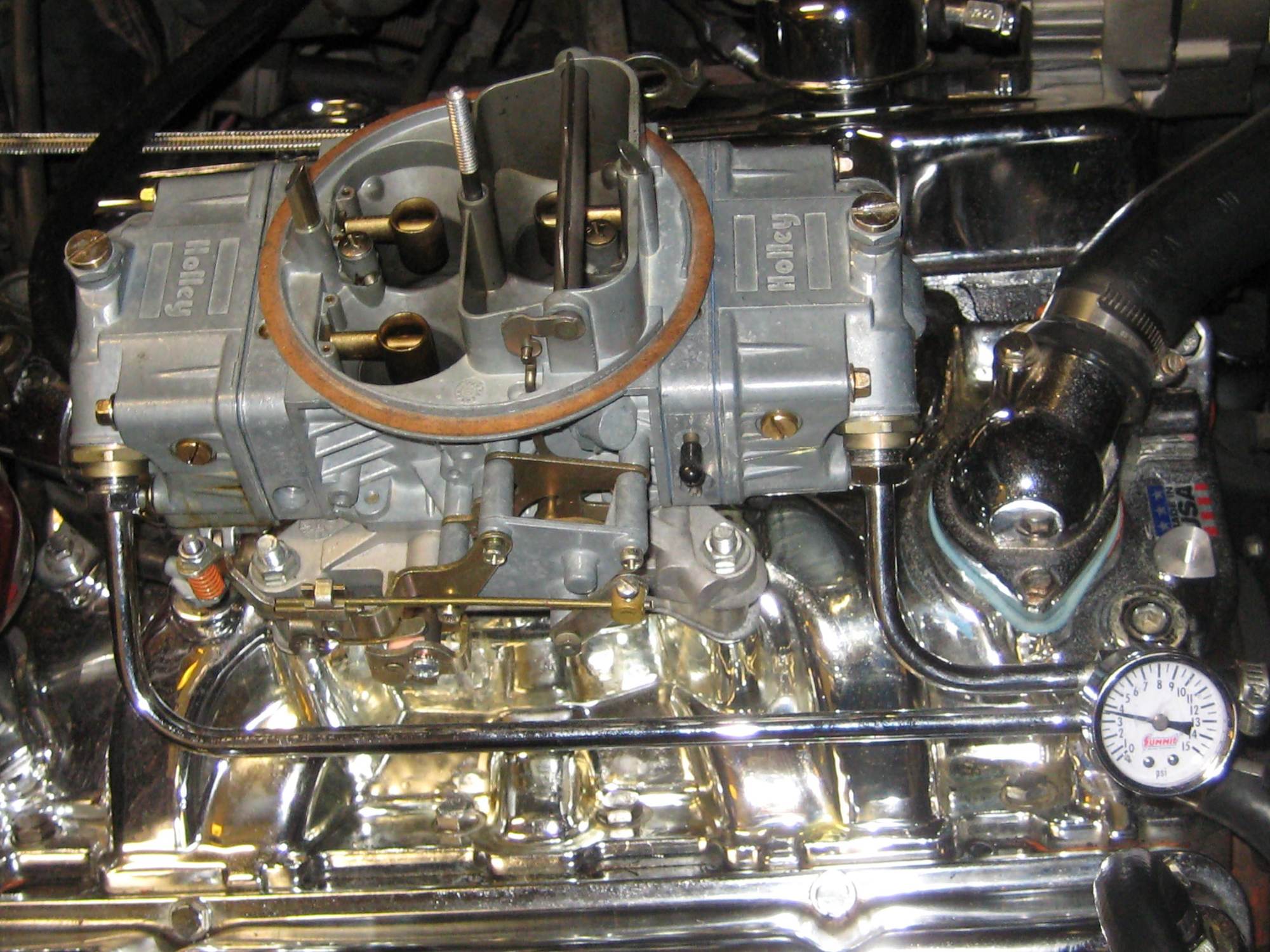

I just bought an unmaintained 1974 coupe. It has a Holly double-pumper carb. The car will putt around the neighberhood just fine but on the highway above 30 mph will only go a few hundred feet and die..seems like it runs out of fuel. Float level is OK..
It has a fuel pressure gauge that flutters around 10-15 psi.

Gauge reads 10-15 lbs? Way too high. Let's hope that's a false reading. 5-7 is plenty.
You may want to find a gallon / bucket of Barryman's Carb Cleaner. That Ethanol gas can really screw up the works in any carb. A good soaking with gaskets removed and do one part or section at a time.
Because it appears to be starving for gas during high demand, I would suspect: Needle valve, seat, float condition, "O" ring on the needle valve even if the fuel level is at the sight glass hole. Last week, I had a brass float hanging up on the hinge mounting tab.
This issue could also be a well-worn fuel sock in the gas tank too.
