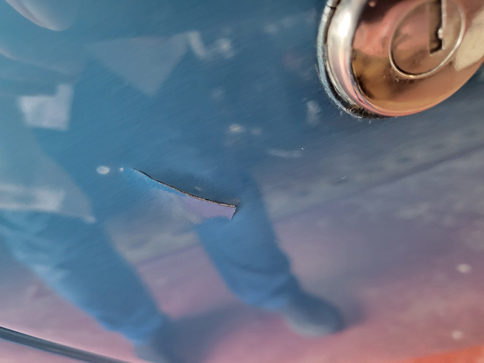

ThNks. The chip, which was present when I bought the car, is near the passenger doorlock. The "scrape" is more in the middle of the door and is maybe 12 inches long.

Actually, I have a pic of the small chip that was on the door when I bought the car. The scratch will have to wait for my return.

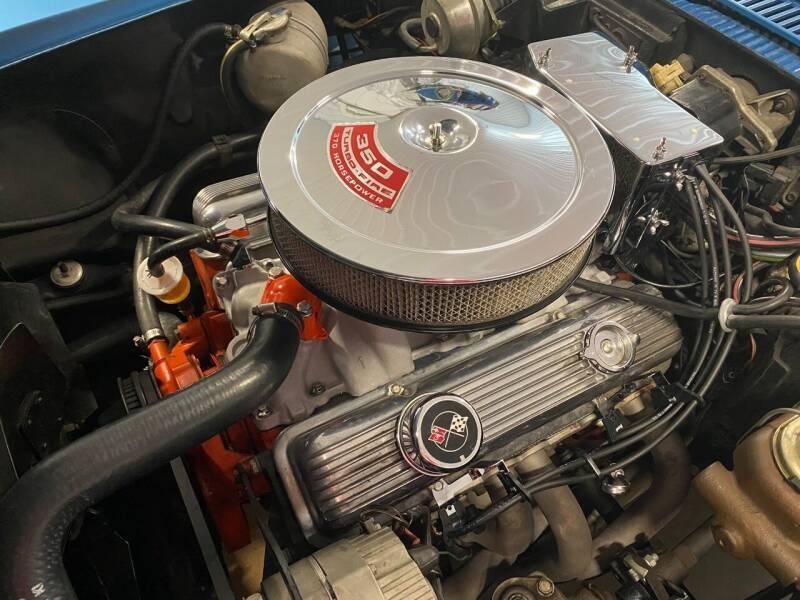

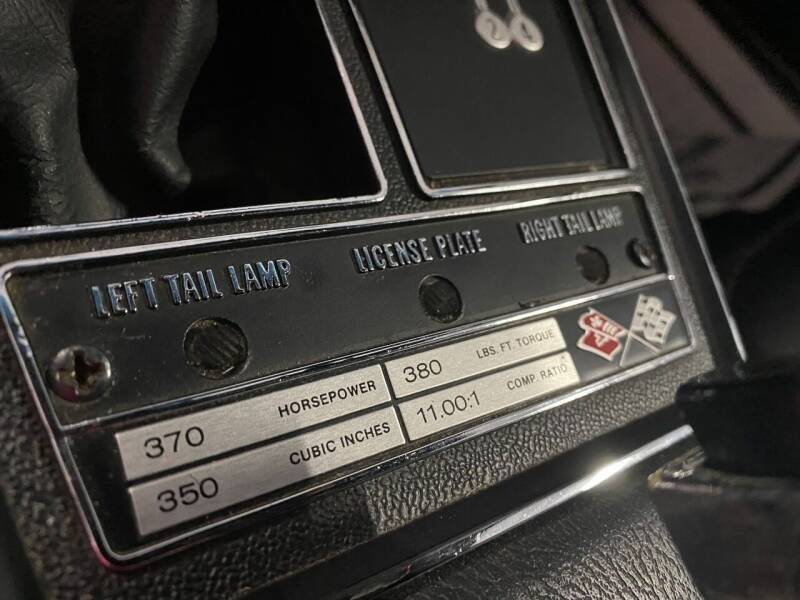

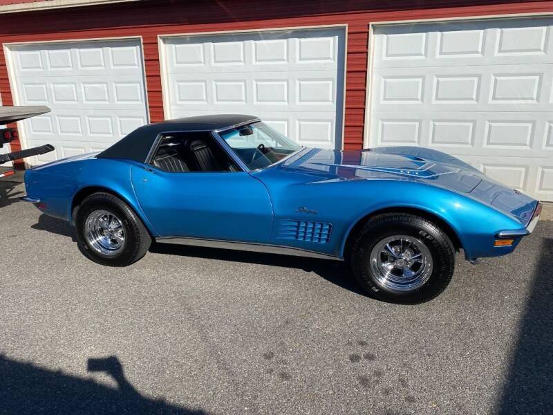

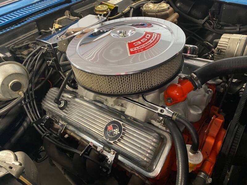

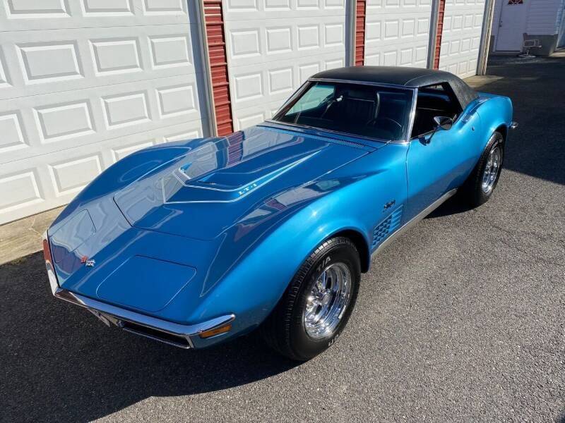

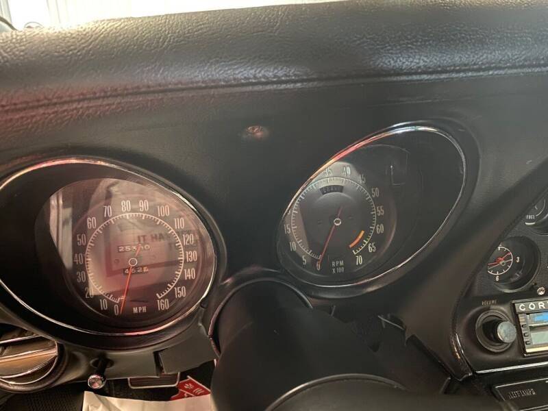

My tach needle fell off the other day, and gumby doesn't bend well, so I have to pay someone to pull the dash and reattach the needle. This is obviously prior. These pics were from the seller before I bought the car. Other than these, the pic in my garage, and the paint chip, were after the purchase.

Car looks nice. That picture you posted isn't a scratch, it's thick paint which has cracked, or possibly bondo which has cracked. There's more work to do on your car than simply filling a scratch. But it can be repaired by whichever shop you choose.
