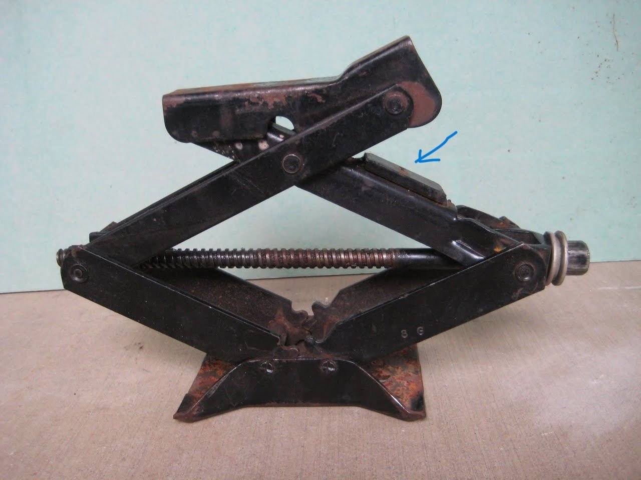

All that is know is the Emissions decal was on early 1968 Corvettes was on the top of the drivers side radiator. There is not set serial (VIN) number when the change occurred. The 1968 and early 1969 had a jack with a base measuring 6 inches by 4 inches. The later 1969 jack has a larger base measuring 9 inches by 5 inches. Also the later 69 and on had fine threads not coarse as earlier ones were. At some time in 1968 they added this thick metal reinforcement to stabilize the jack. They are not identical. See below.

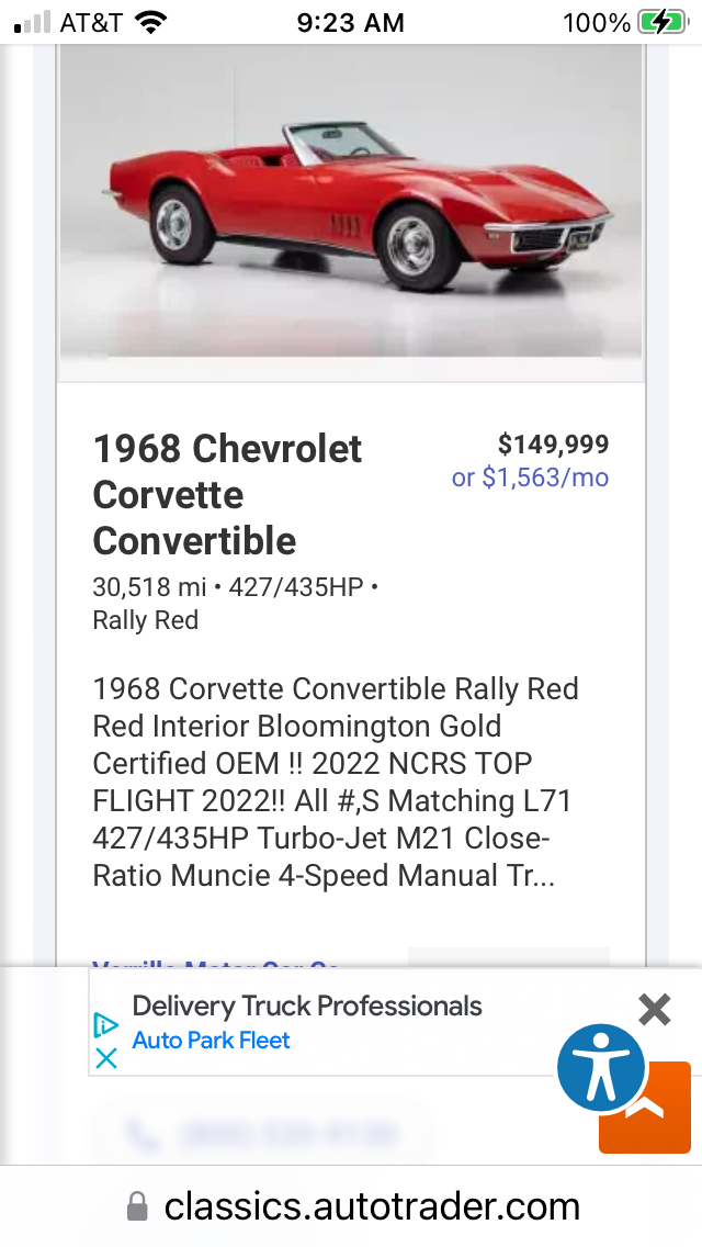

I just clicked a link on my phone and got this
Not saying they’ll get it but if all that certification justifies this price maybe there’s something to it.
At that price I was like L88 ???
