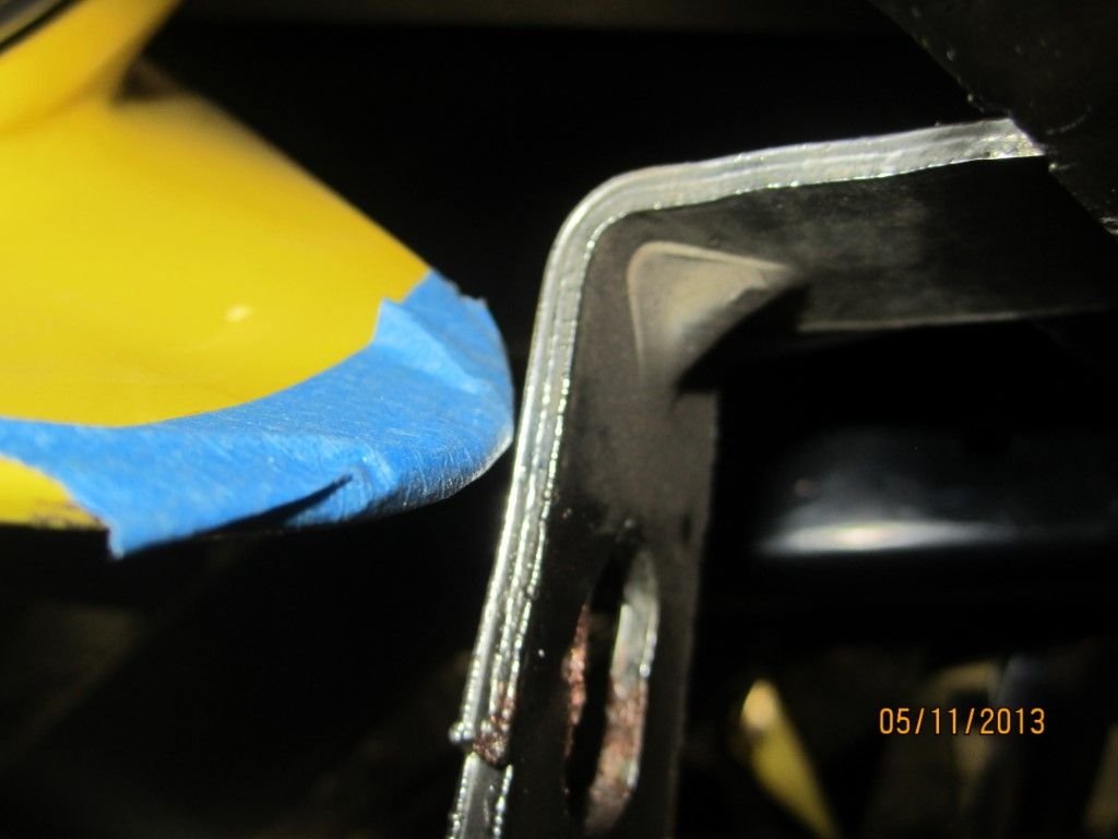

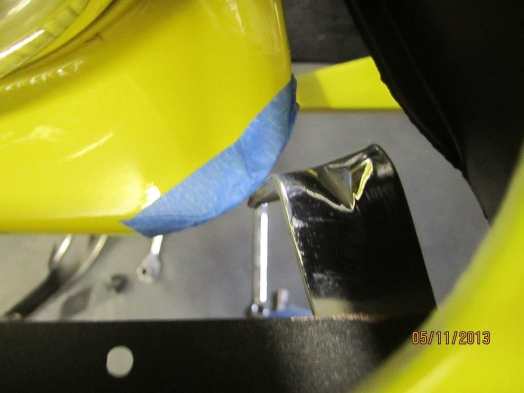

That is a replacement radiator support. I think that lip is made larger than the original. So I would not have a problem with cutting it until the horse shoe fit.That is a replacement radiator support. I think that lip is made larger than the original. So I would not have a problem with cutting it until the horse shoe fit. Trimming a little bit of the front of the horseshoe might be easier.
