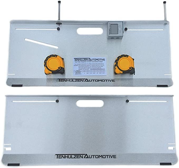

I purchased a tool to help me do my own front end alignment. It’ll check toe, camber and caster. Although it’s not exactly “ easy” to use, It gives repeatable results when double checking things.
I checked the factory specs for front end alignment. 2.75 degrees positive caster IIRC is stock. I purchased adjustable upper arms, and without being anywhere near maxxed out, I’m at 4.70 degrees.
According to the same specs I’m reading, that number is also “ within spec”.
My understanding of additional positive caster is that it makes the car more stable, and less nervous at speed. But I simply don’t know dick about a front end alignment, as I’ve always paid to have it done. Is there a detriment to having this much additional caster?
