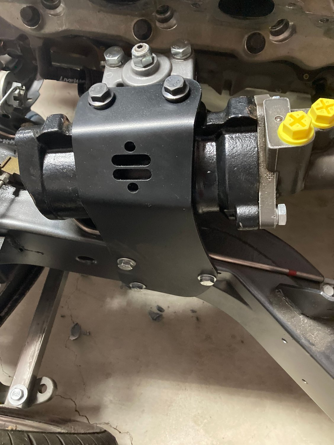

I installed it on my 79. I agree it's an upgrade for sure. Buy the frame reinforcing bracket also. There are a couple good utube vids on the install.

I second the brace

Absolutely! But be careful on sharp left hand turns (usually in a parking lot). The inside of the front wheel will now rub on those bolt heads. Some folks use the stock (or replacement) carriage bolts instead, even with the brace.

I have ordered the ridetech brace. Also, some more parts will be here this week. We should have it back on the road this month sometime.

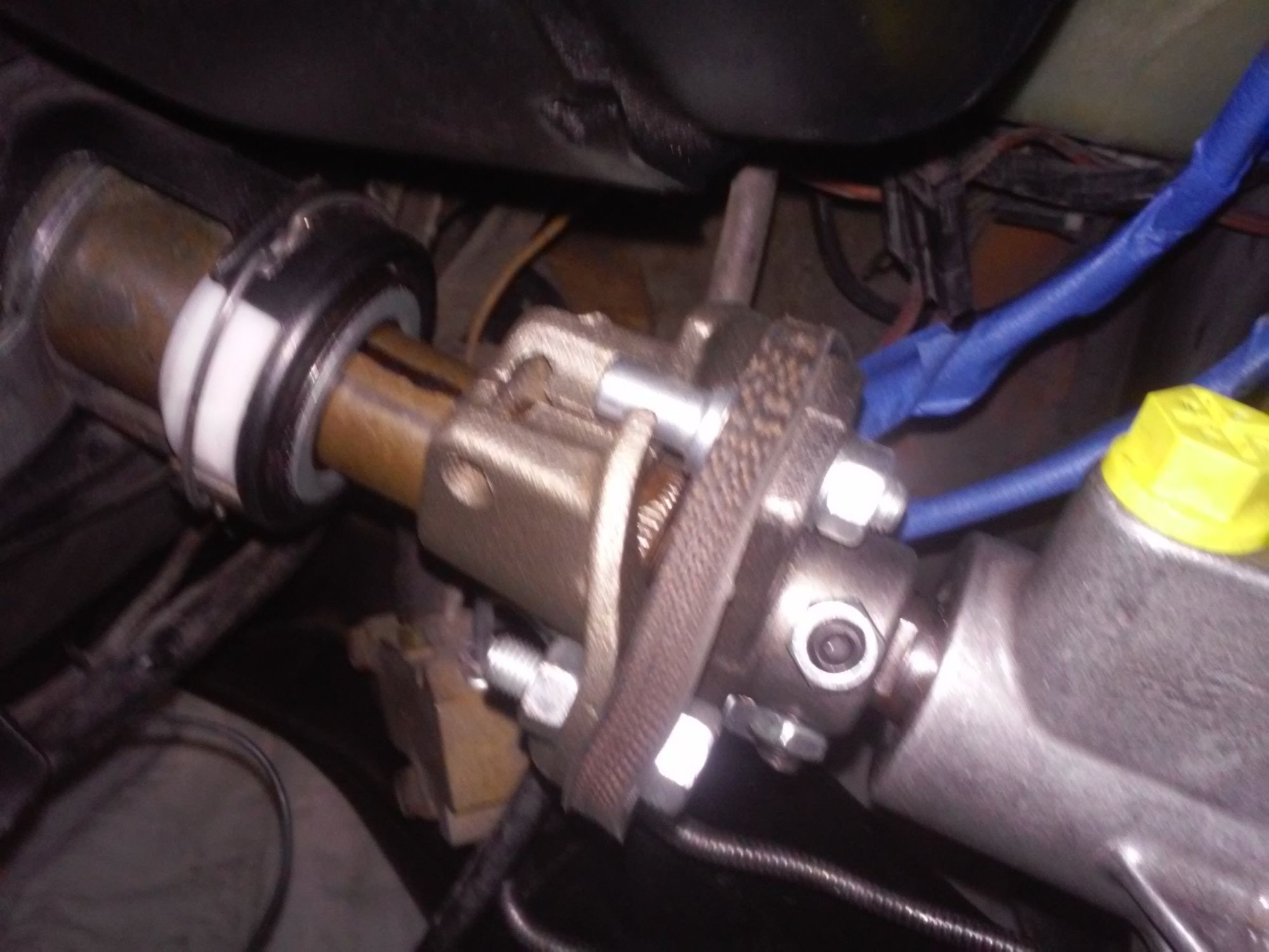

Likes: 439
From: Denver CO
For me I noticed the car is not as "darty" on the highway. Very stable.l replaced the lower column bearing also.

In regards to the frame brace bolts maybe grade 8 button head bolts would be better or maybe counter sink the brace for flat head grade 8 bolts?
