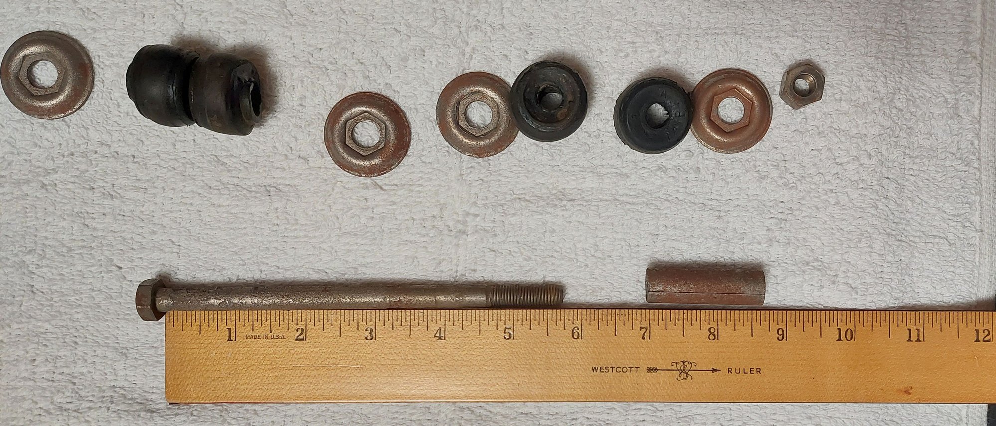

this may sound a bit of a silly question. But I'm going to throw it out there anyway.
About 25 years ago my original front sway bar end links had well and truly hit the end of there lifespan. So I replaced them with parts that most likely came from Ecklers as way back then that's where I was getting most of my replacement parts. (They had much better service back then).
And it's a long time ago but I don't remember thinking they looked different from stock at the time. But I can't be certain.
Fast forward 25 years and while I was under the car doing something else I noticed that the rubber bushings were starting to perish. So I ordered up a set from Zip Corvette.
Now here's where the question comes in. The old ones, But not the original ones have a 1 inch spacer. The new ones from Zip have a 1 1/2 inch spacer.
This will obviously change the angle of the front sway bar.
77 Corvette factory gymkhana suspension, 1 1/8 inch front bar and car is slightly lowered. (About an inch).
Which is correct?
Old link from the 90's.
New links from Zip.
Which is correct???
Thoughts.

I can't tell you what other years were but the 77 AIM UPC 3G Sheet 1 shows same part numbers for bolt and spacer used on FE7 or standard links.
My original 77 bolt is 5-3/4" long
Spacer 1-5/8" long.
Spacer part number 3817574
Bolt part number 3817575
Old Nov 6, 2022 | 10:46 AM
Spacer 1-5/8" long.
My P&A (from 1975) shows the 3817574 spacer is applicable for 63-75. I just checked my originals from my 69 and they measure 1 5/8”.

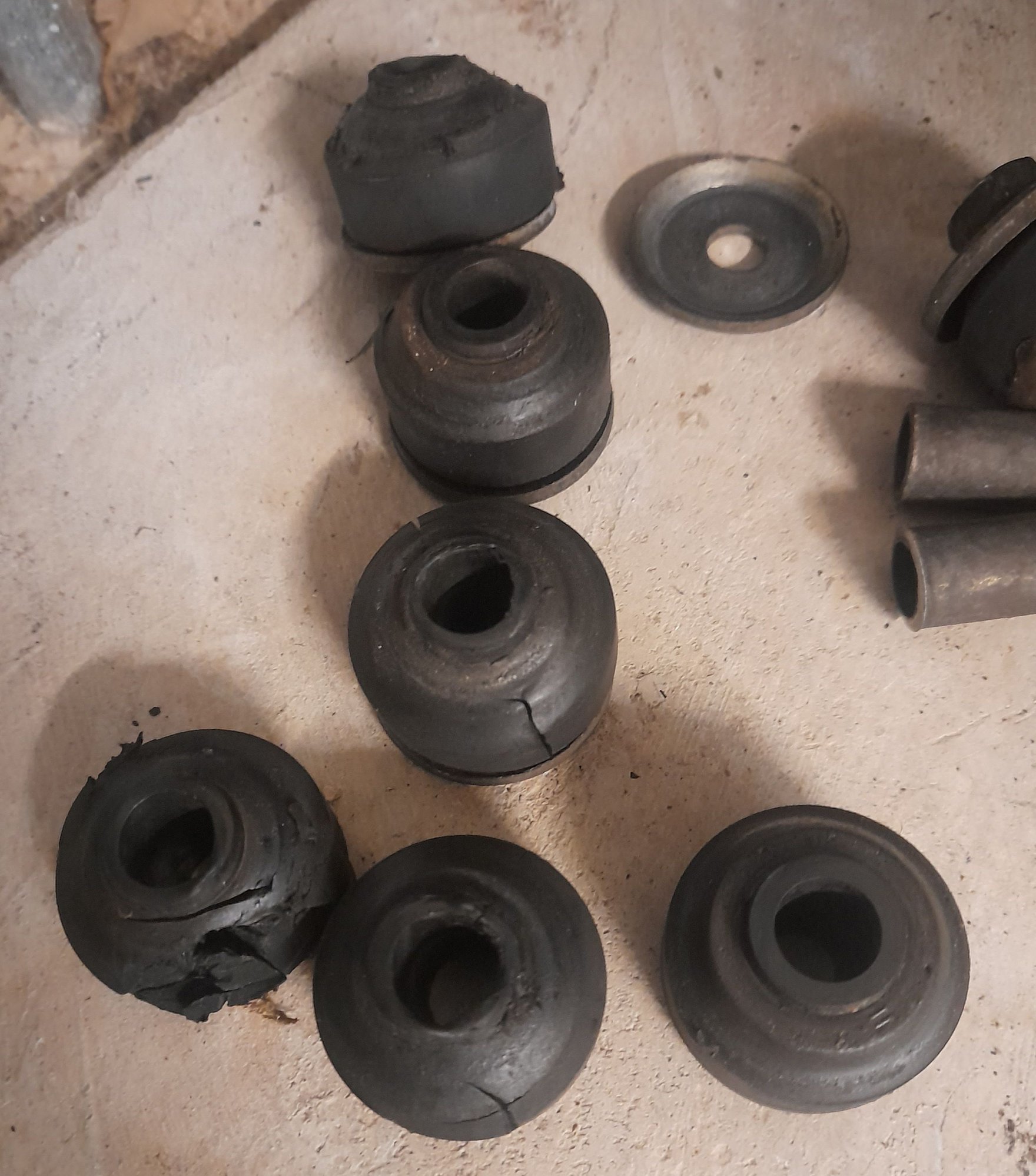

Well, put them in, torqued them up, time will tell. looks to me like very little clearance at full bump to the front frame extensions.
My 20 year old poly bushings.
