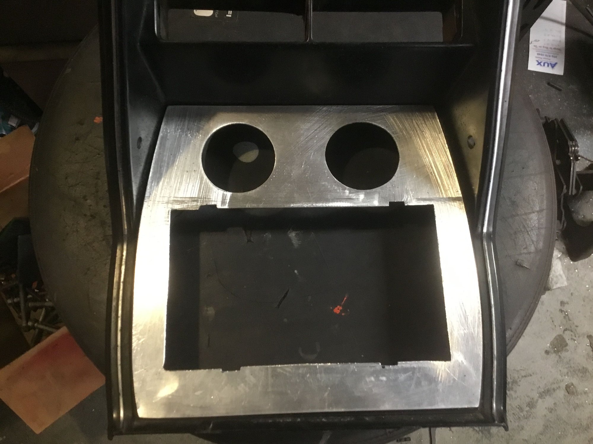

There are a myriad of “single din” head units out there to do the job. Installing one will require that you make the rectangular cut in your gauge bezel to replace the shaft style radio.
Once you make the modification to the bezel though, there are literally dozens, and dozens of choices that’ll fit in the new hole.

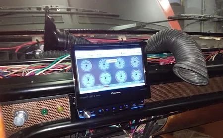

This was an old pioneer unit that I had that I threw into a new gauge bezel when I was planning on using these gauges. ( sold to another member here). It’s only about 2.5-3” deep. It has the ability to play any digital music source either from your phone wirelessly ( BT) , or from a usb thumb drive. Additionally it comes with a microphone that you’d attach to your visor so that you can be heard more clearly when talking on the phone. ( There are units out there that have a built in mic, but you’ll sound like you’re in a tin can to your caller, and have to speak very loud).
Or, you can opt for something like this:
Another single din unit, but it has a 6.5” motorized touch screen inside the unit. Significantly deeper, and more heavy than the previous picture, And it’ll do everything that the previous unit does, but now video comes into the picture. You can plumb in a back up or parking camera. This was in my last car, and was hooked to my computer so it could display my tuning software for the car’s MS ecu. As stated, these pictures are of Pioneer units, but everybody makes these things and no one premium brand is better than the other. Pioneer, Sony, JVC, Alpine, Kenwood, just to name a few. But as with everything else, that list also includes the Chinese, so choosing one will take some research.

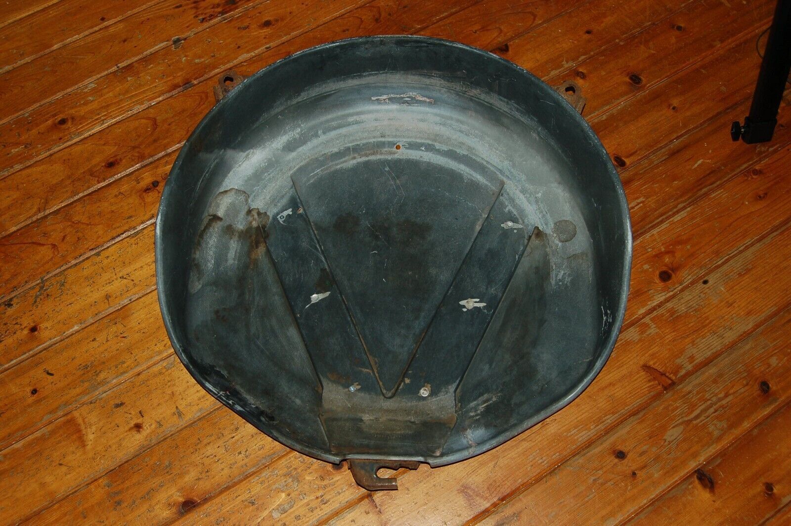

Putting a sub in the jack well will have to have some thought put into it, as there’s not much room there. Thinking about that, I’d imagine you’d be restricted to an 8” or smaller unit. You will have to have an additional amplifier to drive it.
The problem you’ll have with a sub in that space other than getting one, and it’s amp to fit will be the rattle from the compartment lid.
You’ll just need to make sure the lids close tightly. Sub woofers don’t need to be out in the open, but burying one in a hole might have some undesired acoustic side effects.

you can get a bigger sub in here...
Agreed. Bout the only thing it’s good for…
