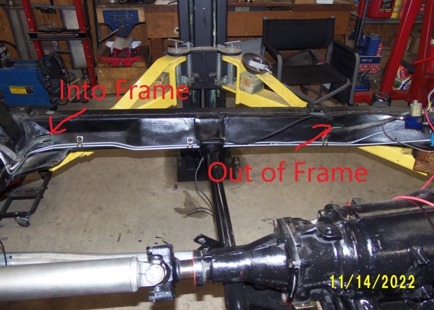

I recently upgraded my battery to starter power cable to 0/1 gauge. Im about to upgrade my alternator to battery cable to 4 gauge, but before doing so wanted to know if anyone had any experience changing this cable, it seems to run in the driver side frame. Is this an easy change out?

Sorry, my car is an ‘82 Collectors Edition.
the charge cable goes into the frame rail under the driver side and k think it exits near the battery. But, I’m not sure if I needed to remove anything special or just pull it through to replace it.

From my '80 Corvette with the body off right now. Here are some photos of the charging line:
Showing the routing through the frame
Wrapping through the rear frame
Exiting the front of the frame.
It looks like you can pull the wire through the frame as long as you can get to it. The hardest part might be at the rear as it wraps around the rear frame members.
Hope this helps.

Thanks everyone for your response. TX Driver, your photos will help a lot. Much mahalo!
