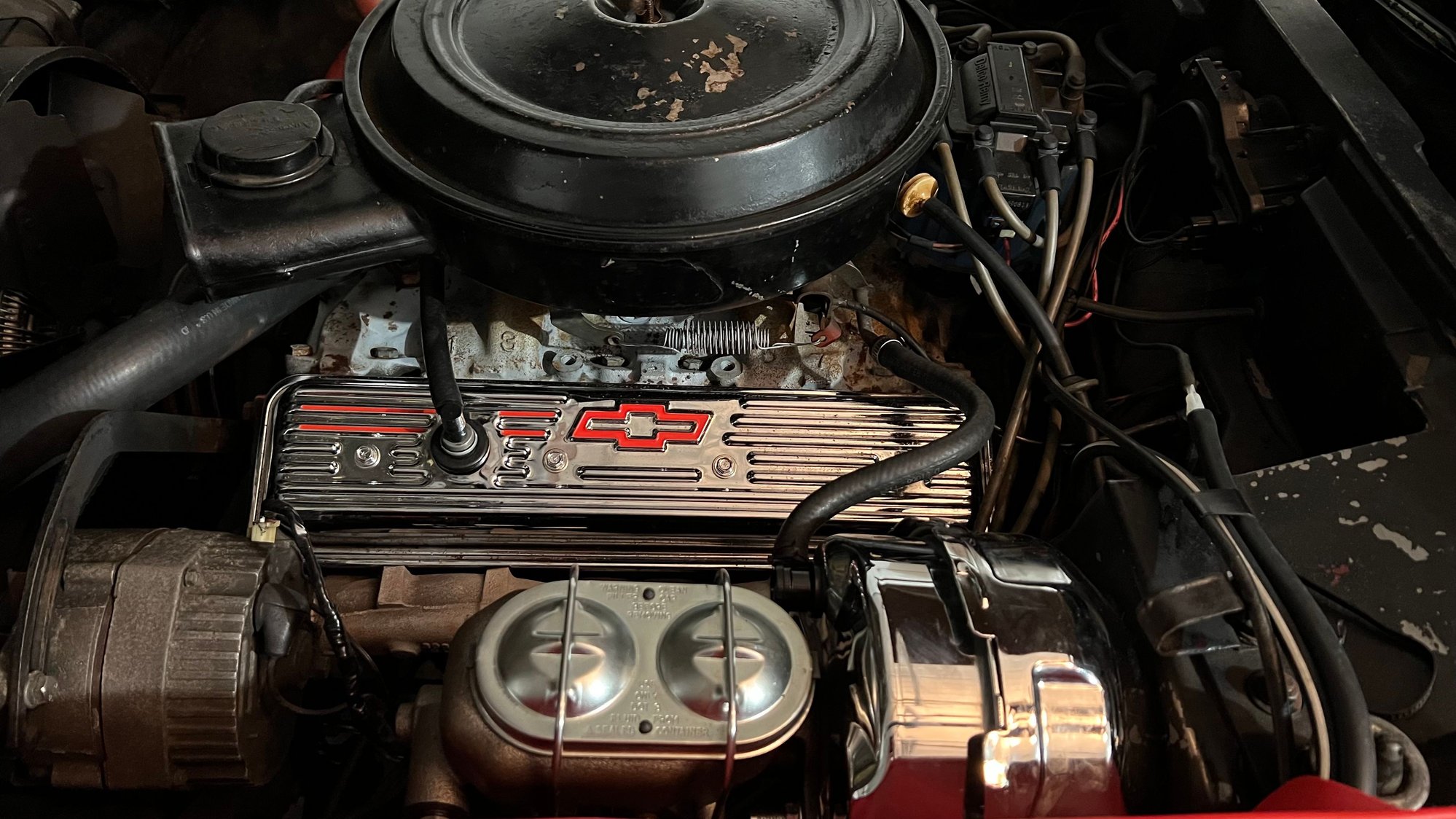

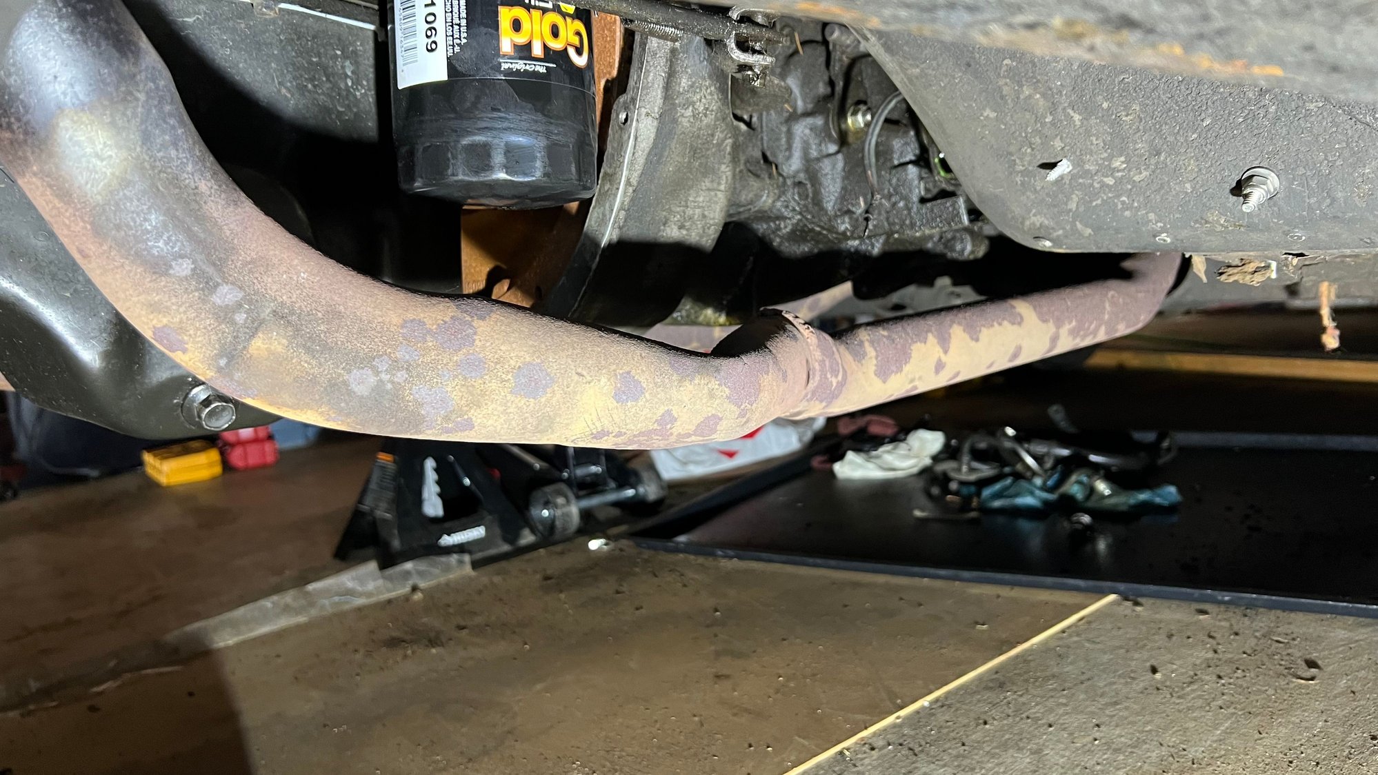

I got a 76 Vette with a new engine in it as of 1996, (10243880). New Crate Engine. It was parked 2k miles after the new engine was put in. Anyways. The engine is well preserved and looks new. It needs new exhaust because it’s all rusted out. I was thinking I’d put long tube headers in when I get to it. I’m wondering if headers made to fit in the 1976 Vette with the stock L-82 will fit on this newer engine in the car. I’m sure they would but I wanna be 100%. I can’t find anything online that they wouldn’t. Thanks.

Yes, 100 percent. That's a small block gen 1 Chevy engine.

One thing to consider with headers is ground clearance. My collectors and the connecting flanges hang pretty darn low and I haven’t found a way to increase the ground clearance there.

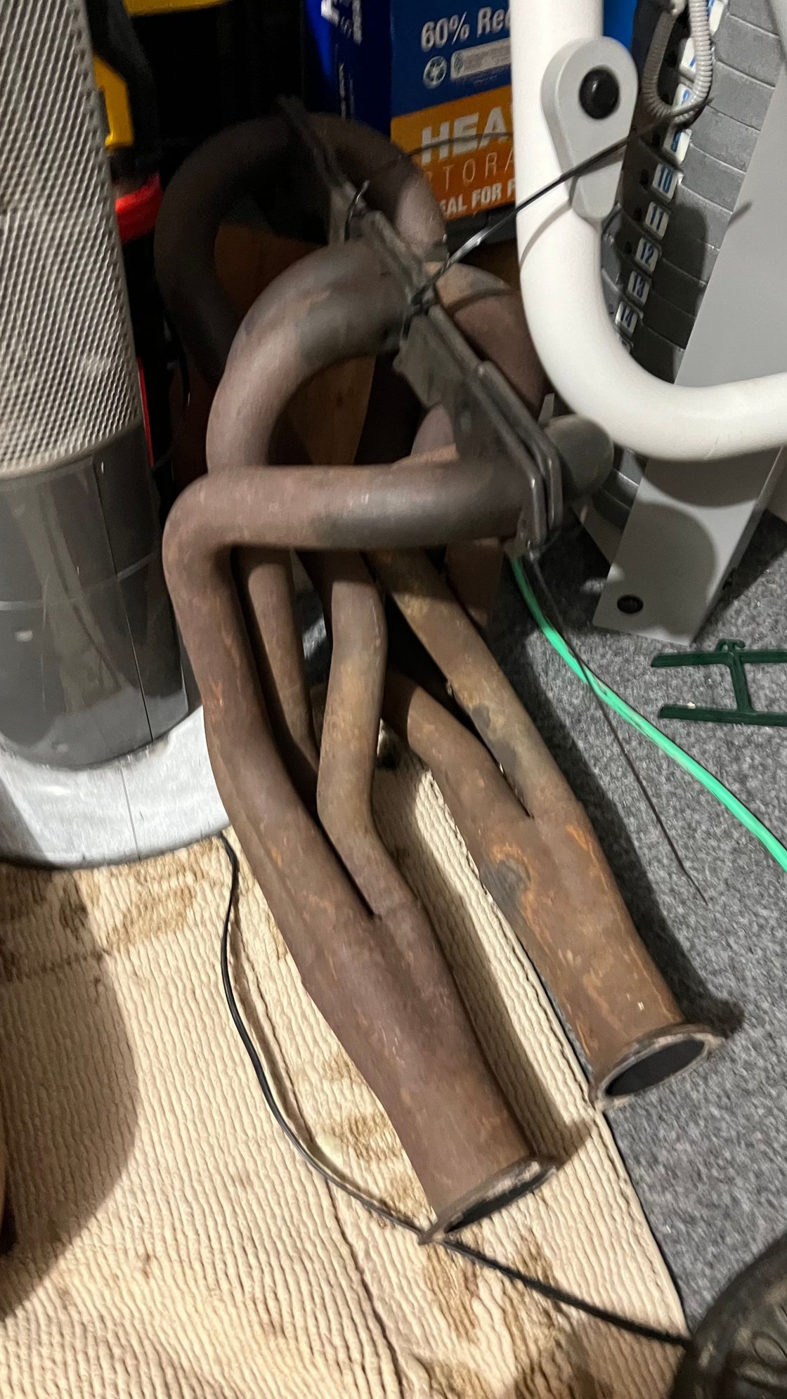

I was looking at Hooker Super Competition headers a guy is selling for $150 where I live. Those clear the ground? Thanks guys.

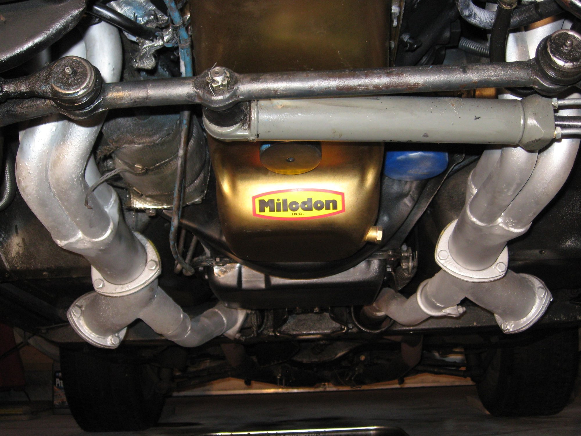

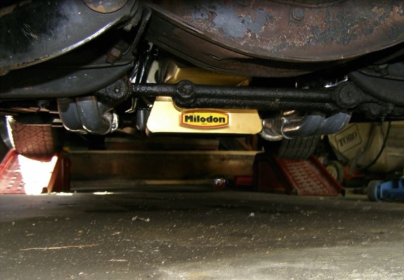

No problem with Hooker Super Comps. They are not as low as the stock oil pan. These pics show mine with the Milodon pan with a depth of 7¼". The stock pan is 7½" deep.

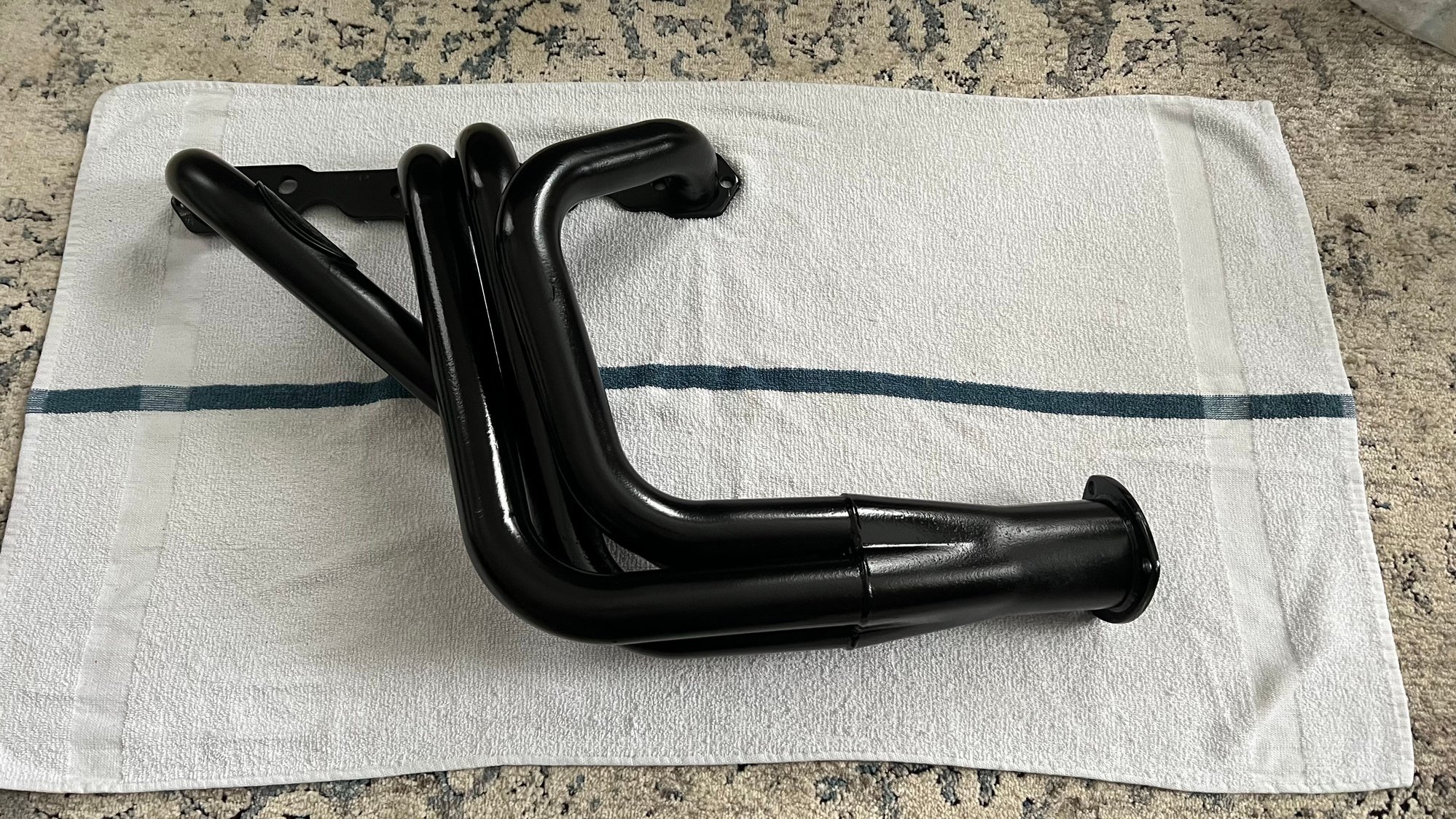

Yes. I wanted black. I got them ordered. I painted mine black.
Before
After
Old Dec 10, 2022 | 06:55 AM
4-vettes's Avatar
4-vettes
Posts: 13,282
Likes: 7,865
Cruise-In VIII Veteran
You painted them black?
let us all know how they look in a years time.
Myself I tried everything, and everything burnt off.
Perhaps you know of a paint that doesn't burn off.
