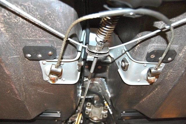

I rebuilt/replace worn items on my P.B but wanted more "grab". There is a tiny nylon wheel inside the P.B. mechanism under the console. I modified the area slightly & installed a larger diameter brass wheel in place of the original nylon wheel.
Also...there is a "pulley-wheel" under the floorboard which the cable fits onto. The pully-wheel bracket is attached to the transmission crossmember.
I fabricated a larger bracket and installed a much larger pully-wheel into the bracket.
I also installed a stiffer main return spring at the differential crossmember for more tension when engaged.
The rear wheels will practically lock up when I apply the P.B. while the car is rolling about 10mph.
It seems the larger brass wheel & much larger steel pulley-wheel are able to apply more pressure to the parking shoes.
Pics are in my build thread...see the table of contents on page #1.
Anyhow....it worked for me......
